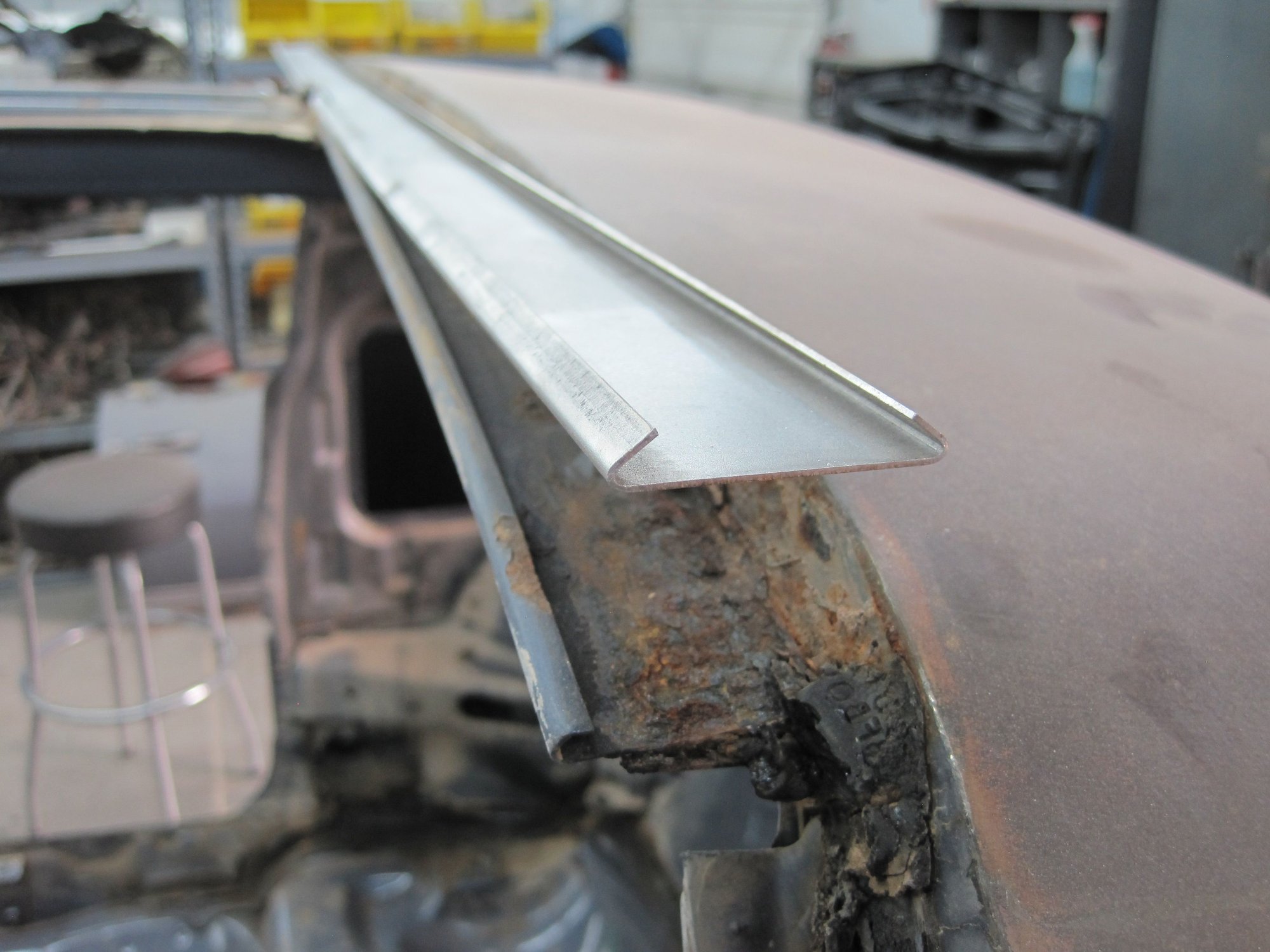

To everyone who messaged me regarding my new roof channels, and for all those who have rusted out channels that need renewing, this is who to contact for a set.
autofabricationdesign@gmail.com
I purchased a front and rear for my car and the service and product are excellent. I'd recommend them.

The fit is flawless. After clearing my rusted channels out of the way the new replacements just dropped right into place. My bodyshop took just under two hours to get the job done, and by done I mean sealed and primed.
I'll post a pic after I have my car painted.

Is that bond sealing them to the body?

They're welded to the body. The sealer is there to prevent water ingress. It's what the guy who installed them recommended. He used a black windshield type of sealer.

Stupid auto correct I ment Bondo. In the last picture you posted where the channel meets the car. It looks like Bondo that's why I was asking.

Here you go, a pic before the primer.
