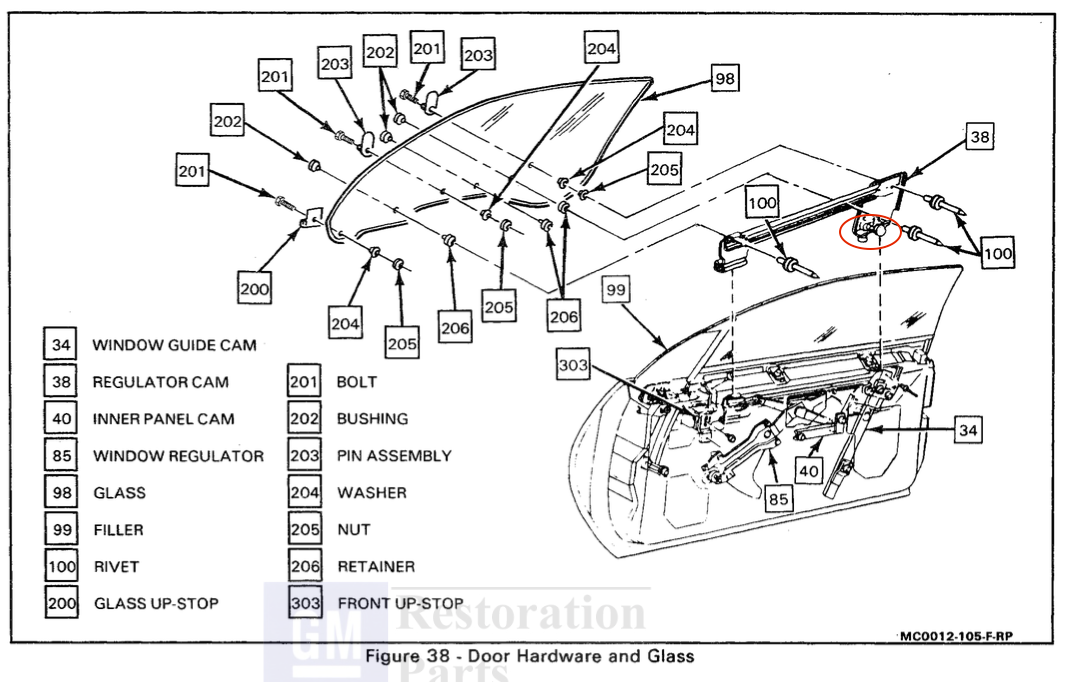

Dumb question - do you mean the plastic roller wheels, the metallic C-shaped tracks they move in, or the cushioned rail on the hinge side of the door?
I did notice that this circled pin in the "regulator cam" (38), that has one of the plastic rollers at the end, is very loosely attached to the regulator cam itself, so that might explain the window's movement. I got another one from eBay where the pin is properly fastened, so that part is going in at least.

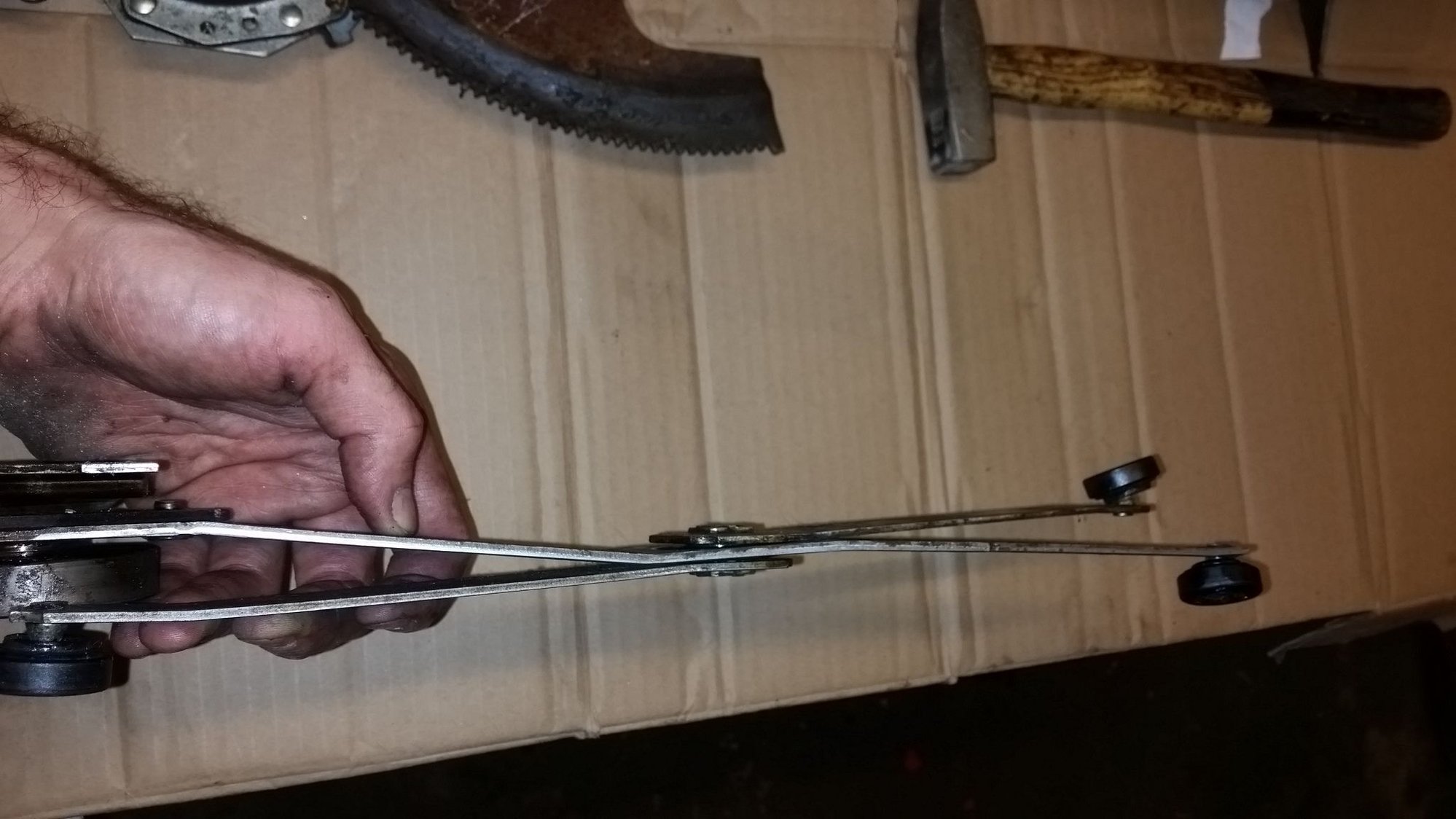

I also have "new" regulators from eBay that have less free play than my original ones, but they're otherwise crappier (rusty, one of the rollers is broken, etc). In that clip above the 1st regulator is from eBay, the 2nd one is my original part.
