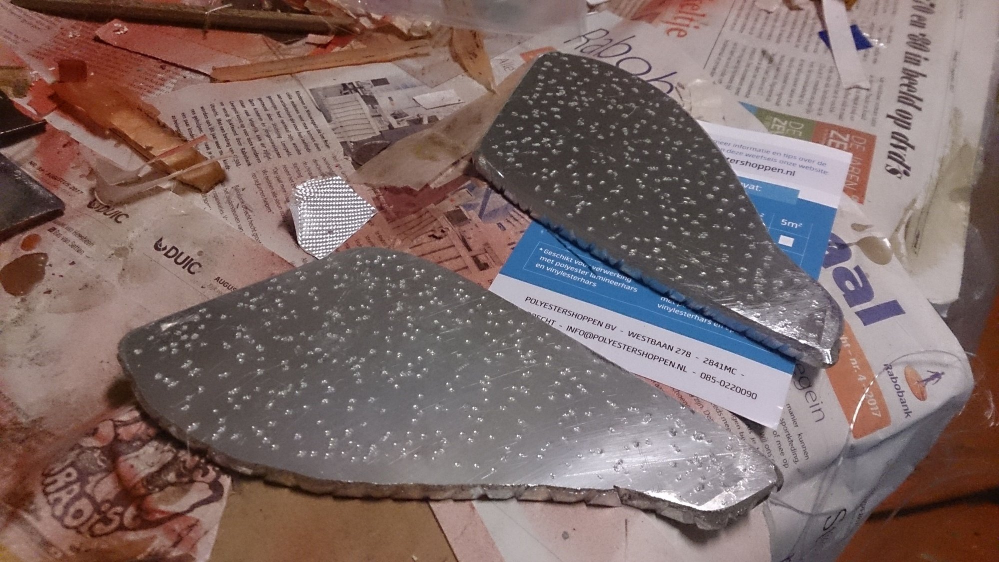

Light alloy mount slabs which are embedded into the design for optimal stenght.
