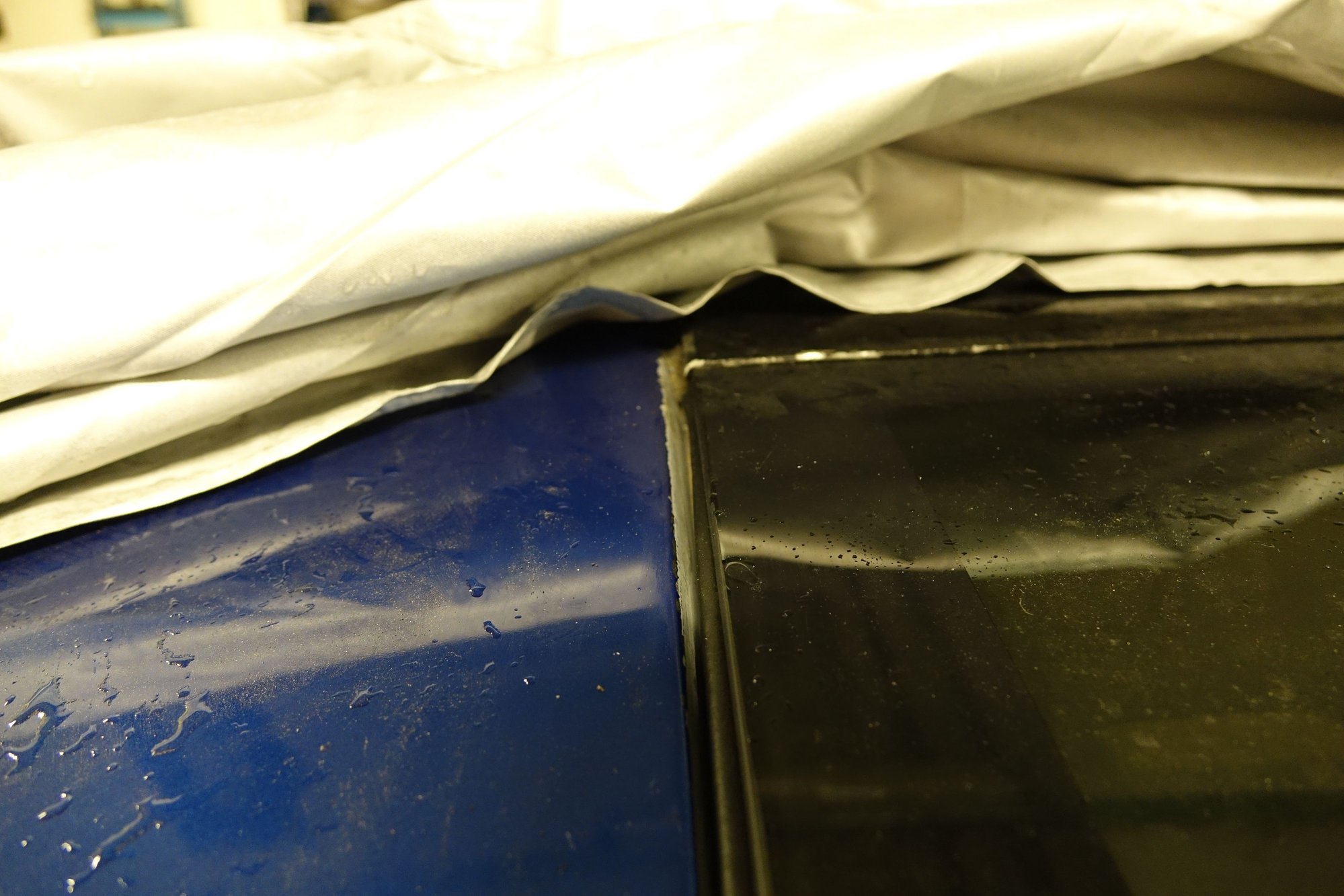

Just removed my old seals and started installing a new kit:
https://www.ebay.com/itm/82-83-84-85...72.m2749.l2649

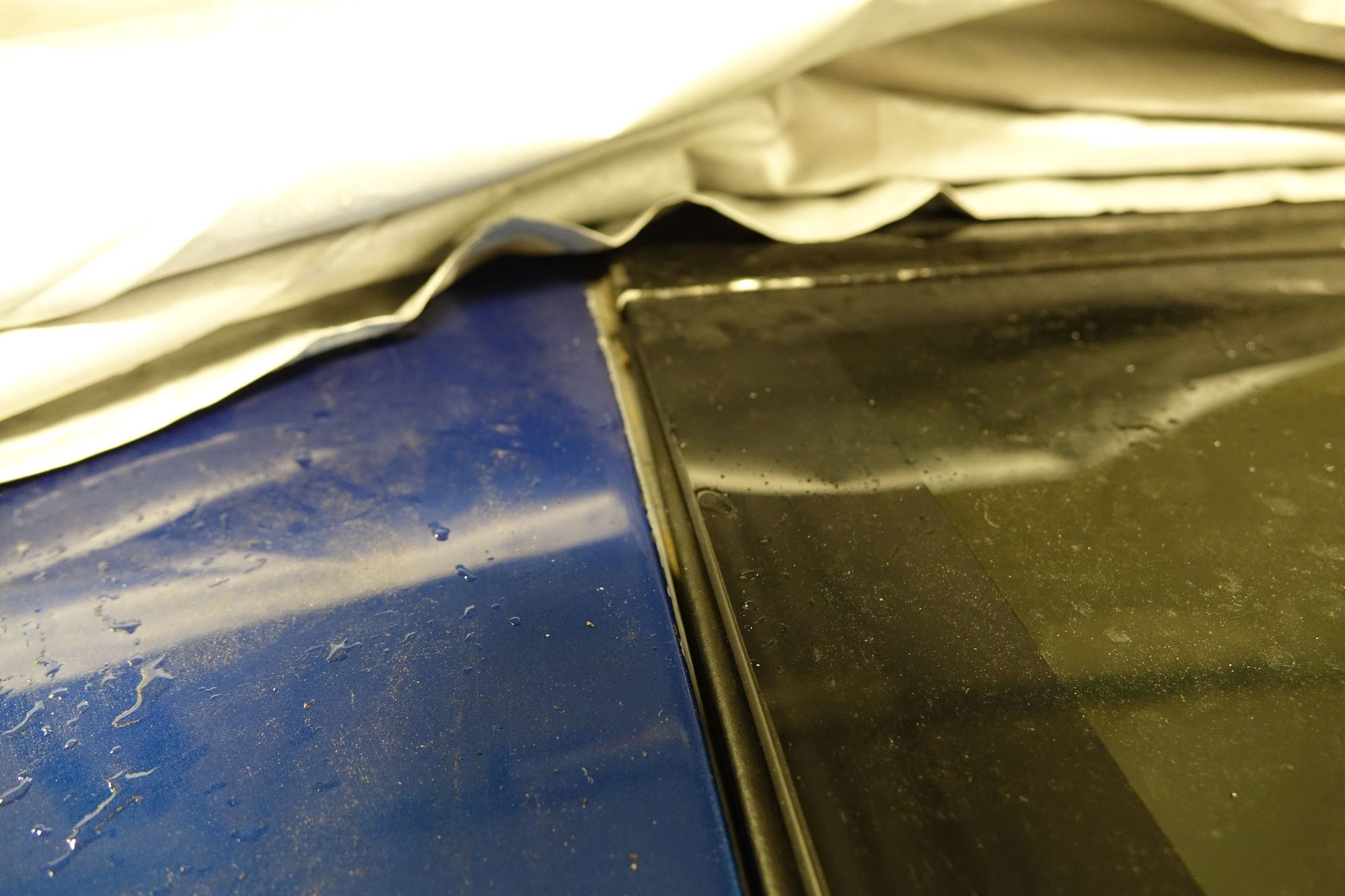

When pre-fitting the seals it clearly shows that it won't seal properly close to the center rail, in the front or back.
Am I missing something, is it possible to adjust the roof in the middle of the car as well?
Or should I get the seals replaced?

To me it looks like the seal is not positioned properly in the body and/or the T-Top center bar channels. Doesn't matter what brand your working with,... if the seal is not properly installed - or can't be properly installed - it will never fit right.

I think that gap between the t-top piece and the roof is extremely wide.
Is that center piece on the right way round? If so, then something's off, IMO.

Did you also replace the t-top edges? I don't mean the drip edge, but the weatherstrip part of the tops.
And how does the area towards the center bar from your first pic look like now?
