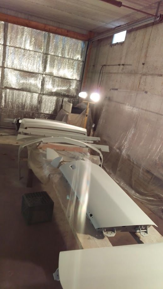

By the time i was ready to shoot the second coat of primer Friday, it was 3PM and temperature was dropping fast. Ended up deciding to wait until the next day to shoot.
Old Apr 15, 2019 | 07:47 AM
  #68
86CamaroDan's Avatar
Joined: Jan 2008
Posts: 631
From: Massachusetts
Car: 86' IROC
Engine: Supercharged 350
Axle/Gears: 3.45
Re: Project 86

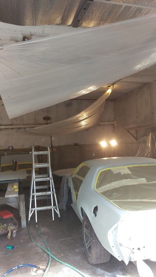

Saturday was for the most part a wash, though it was almost 70 degrees, the humidity in the garage was 85%! I opened up the garage, let it breather, and turned all the shop lights on. I took the time to vacuum the garage and get it as clean as I possibly could. I covered the bench and hung the fenders with a couple of nails. I got my chance at 2PM. Layed down another solid coat, this time using my dads Porter Cable HVLP gun (to get the hang of using a HVLP) Again, a cheap gun that will be used for primer only!
Now, With everything in the garage all at once being panted it made it a little tight. So, after some careful consideration, even though it will put me a week back - I'll be shooting color and clear on the body/bottom of the hood and the doors one weekend, and the rest of it the following. I bumped the GFX twice with the air line - REALLY don't want that happening with base and clear coat, Nor do I want to rush it like I found myself doing on Saturday. "Nothing good ever comes from rushing"

I went over the car with a soft "drywall sponge" I covered it in tape so i didnt rub it (the sponge itself is 120 grit) I used the sponge because its very soft and flexible. Follows the contour of the car well.
Use plenty of water! I soaked the doors and went in a circle pattern. Wet sanding cuts FAST so because to only do what you need to smooth the panels.
I checked the crease in the center of the door with the shop light. Looks pretty straight. Reflection in the lower half of the door makes me hopeful they will come out good.
I ended up finding some black stuff on the roof of the car (again) despite pressure washing and painting the ceiling. At this point i opted to cover it as I'm not willing to risk having this crap fall in the base or clear coat.
I also taped up all of the doors and windows for the final time. I used a was infused type paper to help stop bleed through. Base coat and clear coat is alot thiner than primer, so it will bleed through more easily.
Touched up any spots with primer (I rubbed through in the drivers rear wheel well) I'll need to wet sand these next weekend.
I think most of the debris was from the door itself.
I also found dirty on the hood, so that ceiling got covered too.
The old man cannibalized a old oil burner that had a big old fan in it. He fit it to a 5 gallon pickel bucket, and picked up some 6" duct work at the local Lowes when they were closing/on sale. Next friday well open the door a foot or two, stick a window fan in it, along with the blower and run the piping in the garage to help evacuate the overspray that floats in the air. I have to put the screen in the two windows to the left of the garage, and do a final sweep/vacuum. Then, weather permitting, Saturday is go time!
The nearest PPG dealer quoted me $1215 for the deltron I originally intended to use, but he said the "Shopline" brand is a good alternative from PPG and thats only $260 per gallon. He suggested i stay with the shopline clear for $100 per gallon but I think I might go with the Deltron DCU2021 clear as its a better clear and lots of people seem to use it over the Shopline basecoat without issue (my buddy uses Sherwin Williams clear over Shopline basecoat without issue) I also noticed the Shopline brand clear has a European style clear available which from what I hear is really nice, and levels out really well according to their description.

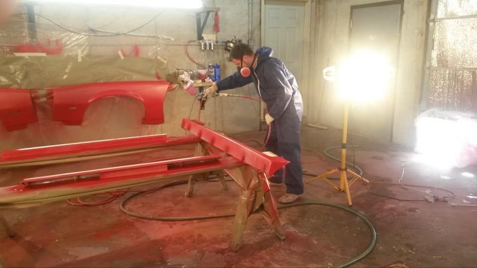

Wet sanded everything with 400 grit, retapped it all with wax infused paper, Gave the floor a final vacuum, moved everything out! We wet down the floor to prevent dust.
Thoroughly mixed up the PPG shopline paint, gave it a stir and loaded it into the gun!
Factory "Bright red" paint - Code U81, AKA PPG 3794.

I cut out all of the edges, lips, and jams first, along with the center line of the roof.
My old man took over for the first full coat.
Its kind of odd looking in its bare form. Looks more matte red than anything.
