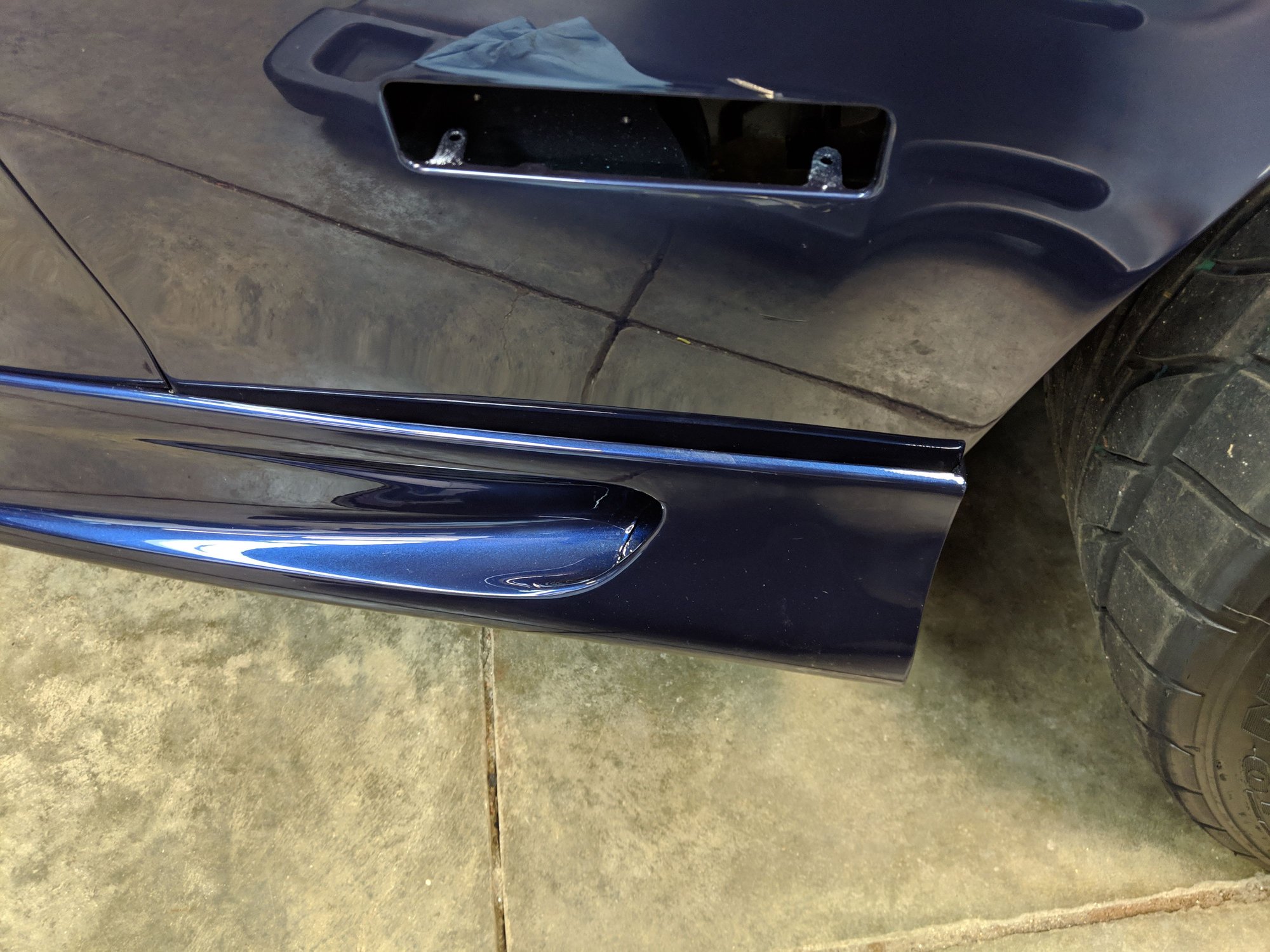

Can anyone point me on how the ground effects clips are supposed to be installed on the back side of the fender, to retain/pull the GFX to the body?

Assuming you still have the loops on the lower deflector, the ones that are supposed to protrude through slots in the fender, they go with the side that's down against the table, against the inside of the fender. Install them by sliding them down from the top, pressing them against the fender to flatten them out as you slide them through the slots in the cover. Previous years, the sides were retained to the fenders with a long strip of metal with studs that bolted through the fenders...

Thanks Bird! That worked
