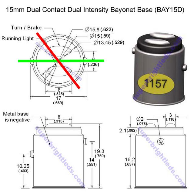

From what i've seen 57 style bulbs have two contacts on the bottom, 56 type have one contact.1157 have two offset prongs on the sides, 1156 prongs are even. Point i'm trying to make, if you put a 56 type into a 57 socket or vise/versa funny things happen when the lights are used.If the socket has one contact at the bottom its a 56 style, two contacts is 57 only.So make sure you have the right LED bulb in the socket.
Another thing i noticed when i had just a LED bulb in either brake/tail or the marker/signal (57 style) was the LED barley "blinks" or gets brighter when the signal/brake was in use.You couldn't even tell unless you were really close to the lamp.I eventually gave up with those things and just modified some LED boards for the front/side markers.In back, i bought those cause thats way above my skill level to pull off.
This is the problem I have with two bulbs I got from VLEDs, the two prongs are not the correct theta to the contacts on the bottom. So the left front turn signal is bright the whole time when the lights are on since the contact touches the wrong terminal
Old Oct 18, 2019 | 01:27 PM
racerx520's Avatar
Joined: Jun 2007
Posts: 1,532
Re: LED light bulbs
thank you everyone for your help. I'm going to take a better look at the socket and front bulbs sometime in the near future. Since the system works fine until i replace the fronts with LED, i figure this is a decent jumping off point (plus if i start at the back i need to pull my subwoofers again to access the bulbs). I think i will have to take a good look at the bulbs and make sure the two prongs are not somehow lining up wrong.
Old Oct 18, 2019 | 06:38 PM
84 1LE's Avatar
Joined: Nov 2002
Posts: 6,673
Likes: 414
From: Oyth
Car: 89RS vert
Engine: Erod
Transmission: 4L65e
Axle/Gears: BW, 3.27
Re: LED light bulbs
Can you file down the "wrong" prong, so only the correct one is left. This should at least allow the bulb to install properly. Also if you look into the 1157 socket there are two slots for the prongs. One slot is higher than the other, due to the offset height of the prongs. So its pretty hard to install an 1157 180* the other way, but not impossible. If you remove one of the prongs be sure the remaining one is in the correct slot.
1156 slots are even, both prongs at the bottom of the base. So those can go in either way.
The problem is not one, but both tabs/prongs. The base needs to be rotated, like I said the theta of the prongs to the terminal connections is wrong. Not really something that can easily be fixed, though I really only have the issue with the front two turn signal housings. It is strange that I have the issue on one side and not the other though. I can just stick the bulb in without rotating it and it will work properly, but then it will vibrate loose while driving.
Got any pics?
FWIW, this is what Scooter is referring to. It's the relationship of the pins relative to their angle to the bulb contacts. Based on my experience with LED auto bulbs, I wouldn't discount this kind of poor quality control. I'd be interested in seeing pics of racerx's LED bulbs too.
Old Oct 20, 2019 | 09:35 AM
scooter's Avatar
Posts: 4,354
Likes: 308
From: NJ
Car: 92 Firebird
Engine: 4.8 LR4
Axle/Gears: 3.45 9 Bolt
Re: LED light bulbs
Yes, that is it exactly

I know what he meant, but was hoping for an actual pic. Ive swapped bases on LEDs w/a bulb base.The two leads (brk/tail) are soldered to the bottom contacts, ground is soldered to the base. Break the glass on a bulb and use that base.

It's a poor photo that I took quickly while running out the door, but this is the bulb
Old Oct 26, 2019 | 08:37 PM
paulo57509's Avatar
Posts: 3,178
Likes: 48
From: Tracy, CA
Car: '87 IROC
Engine: LB9
Transmission: TH700R4
Re: LED light bulbs
Because of the angle the image was taken at, it's hard to say of the pins/contacts are incorrectly clocked with respect to each other. But it looks out of whack.
Thinking out loud here....put a small length of tape across one of the bulb contacts and install the bulb. See if the problem persists.
Old Oct 26, 2019 | 09:25 PM
racerx520's Avatar
Joined: Jun 2007
Posts: 1,532
Re: LED light bulbs
I compared it to a 2057 I had and the line up is the same. Which makes me wonder if I need a resistor then. And how to test this theory before buying one
