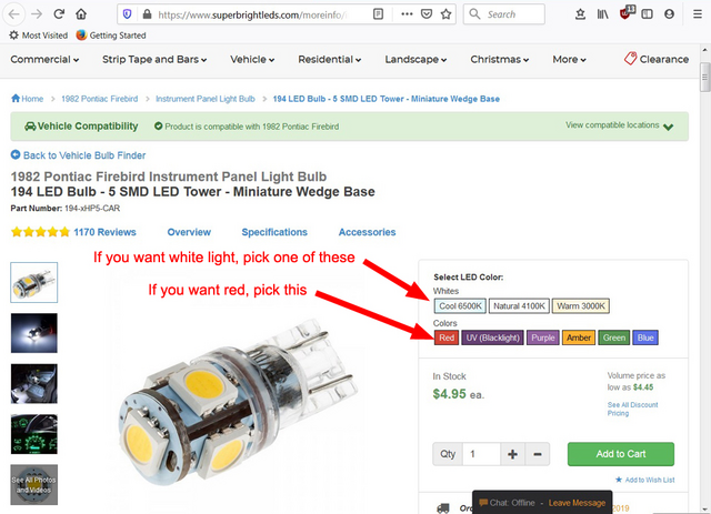

Over the last month I've been ordering the cheaper off-brand LEDs made in China. They come in all different colors. The 5500K-6500K range is the "cool" white that has a blue-ish hue. If you look on eBay you can get of 10 and 20 of the kind paulo57509 pictured for like $7 or less. Choose North America for location so it will get to you less than a week. Keep in mind they may not be as bright or long lasting as suprebrightled's version.

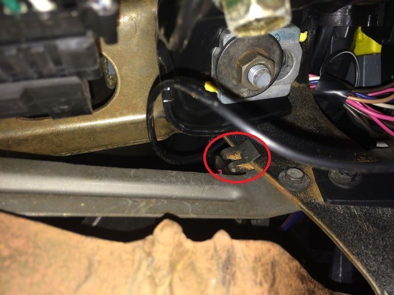

Did go "high dollar" for $25 and got two of the EF32RLNP flashers that are supposed to work regardless of polarity. Pretty sure I replaced the original Wagner 224 12V and Wagner 552 12V. They work with the incandescent bulbs in the all housing without issue. They make a decent audible sound, which does last a second or so after the turn signal is disengaged--not a deal breaker for me.
Replacing these is a PITA. After fully removing the under dash panel, had to crawl in and twist around to lay on my back. It is cramped, hard to move, and tested my flexibility! First picture shows the bolts and tabs holding the "convenience" center in place. The second picture shows the clip that holds the turn signal flasher in place above the "convenience" center.
