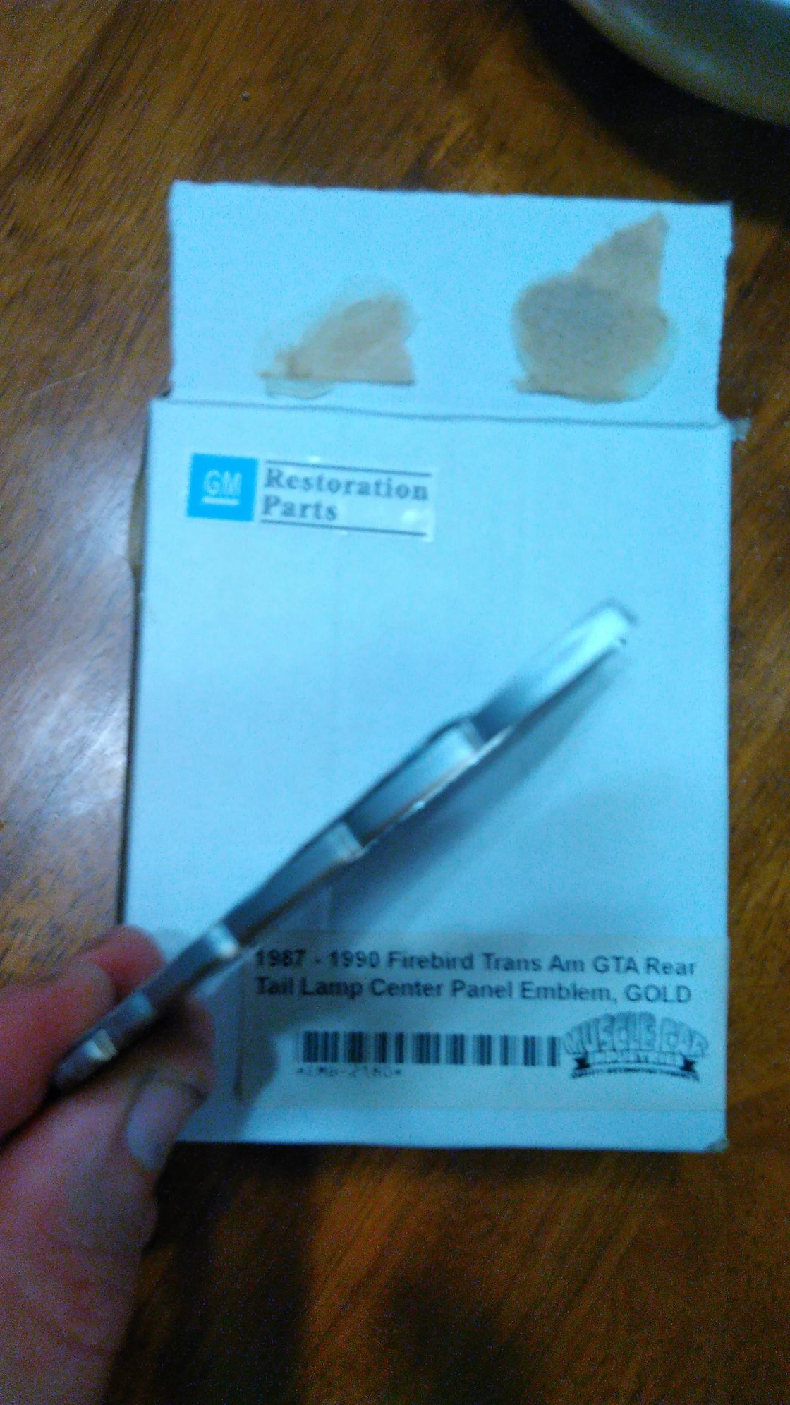

Curvature before I started

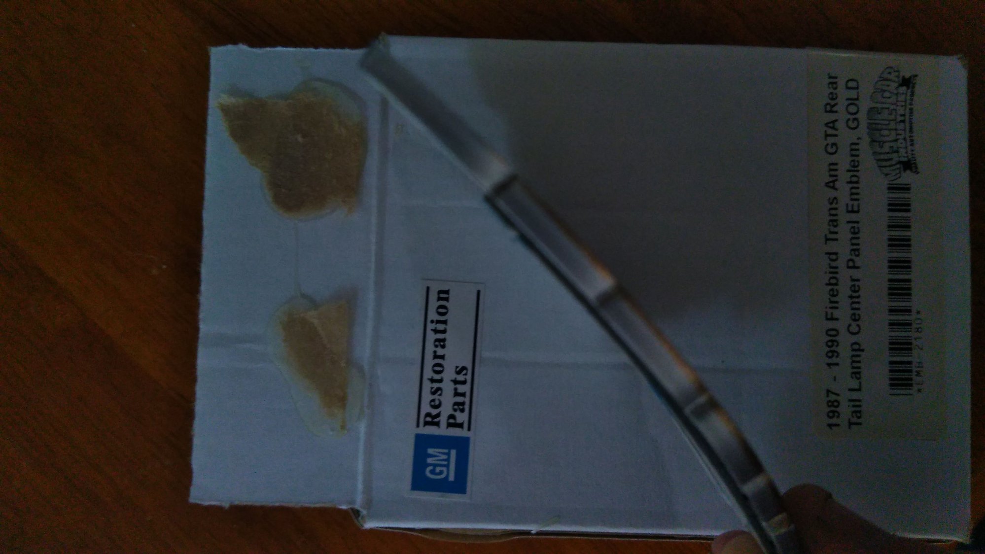

Flat after bending.
There's some warping where the right wing got too hot and conformed to the surface of the weights. It's minor and will polish out fine.

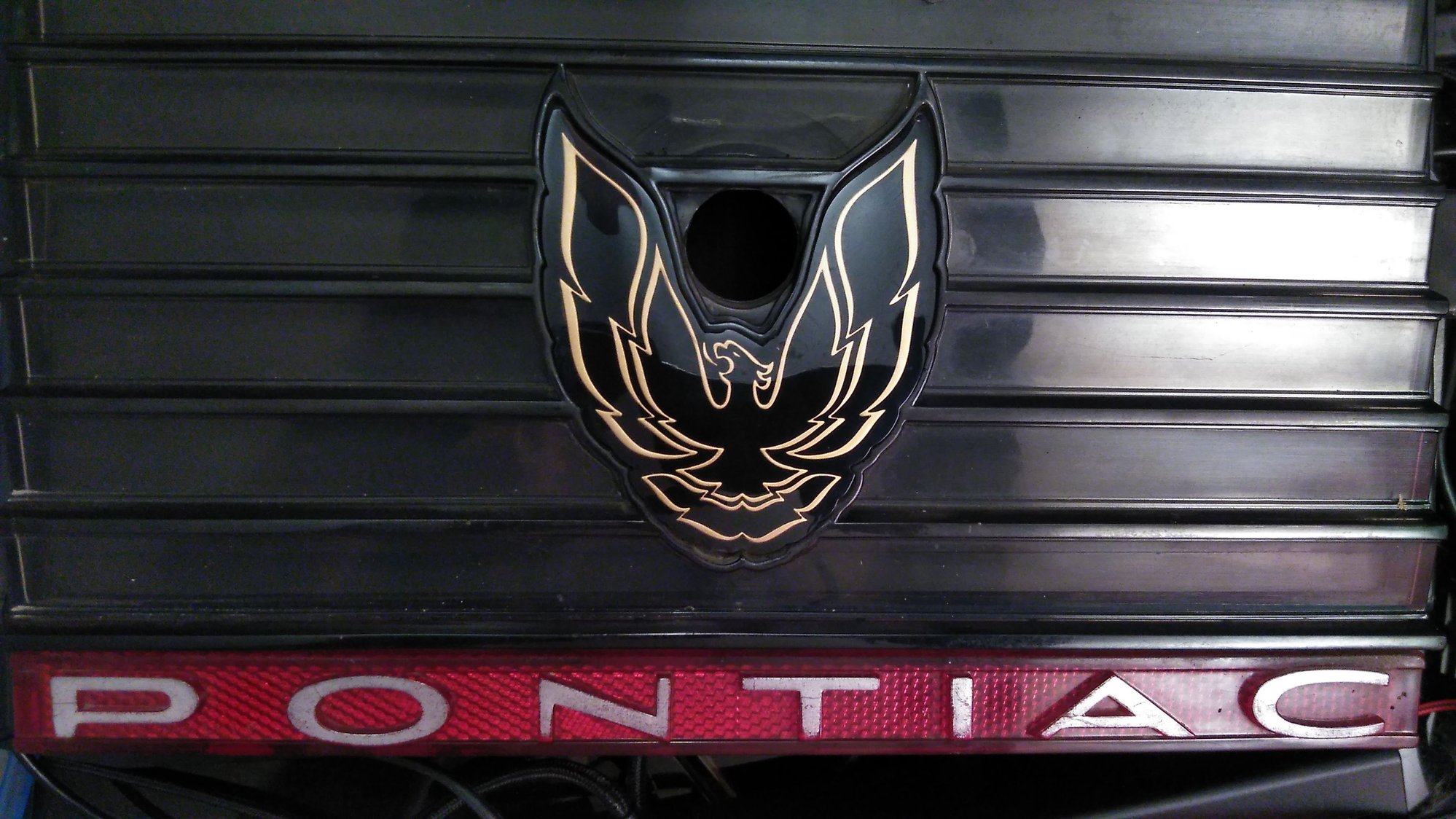

My mistake polished right out. The gap is about the same with the later model bird as the original, only the tail notch is even slightly different. I still need to paint the PONTIAC to match.
