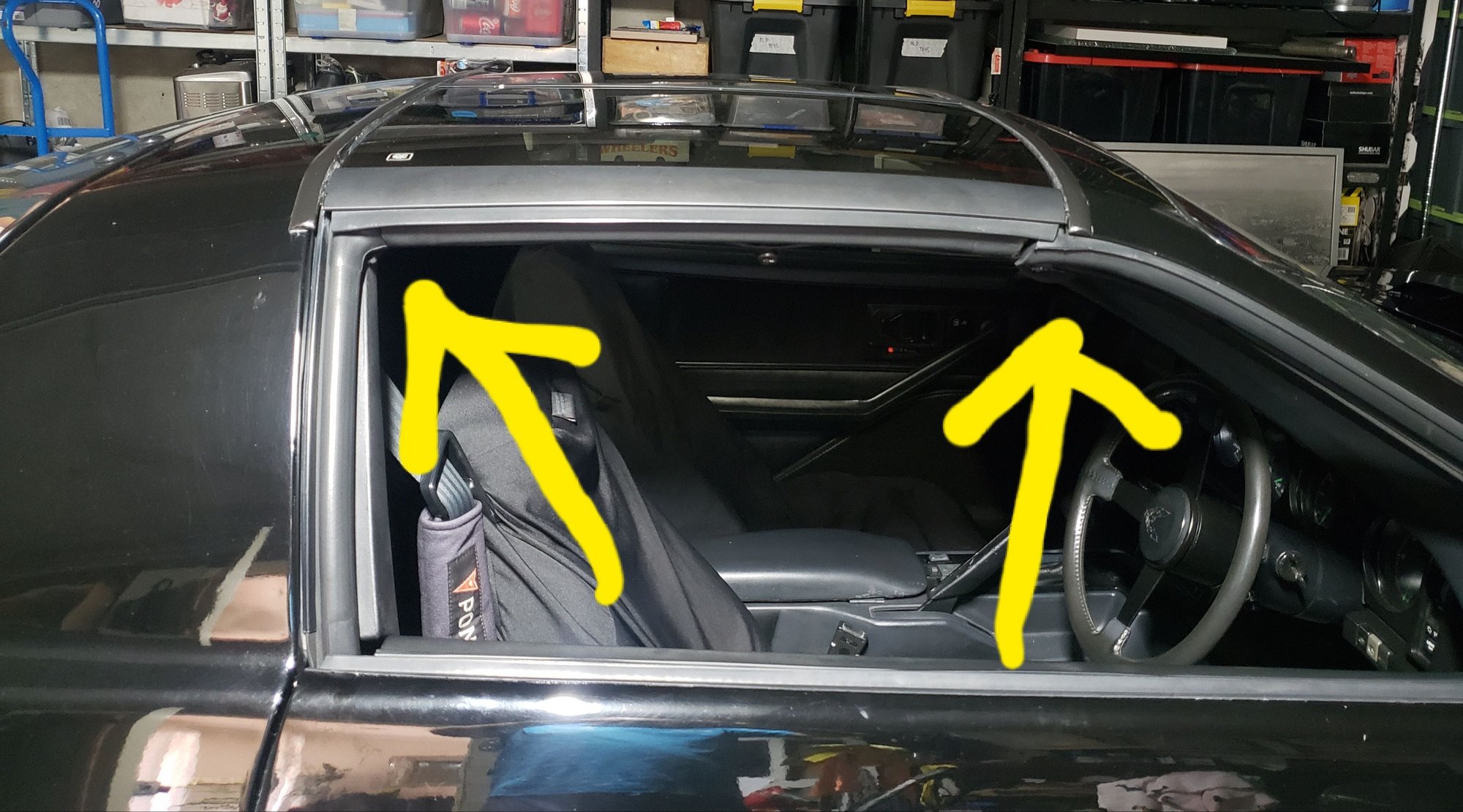

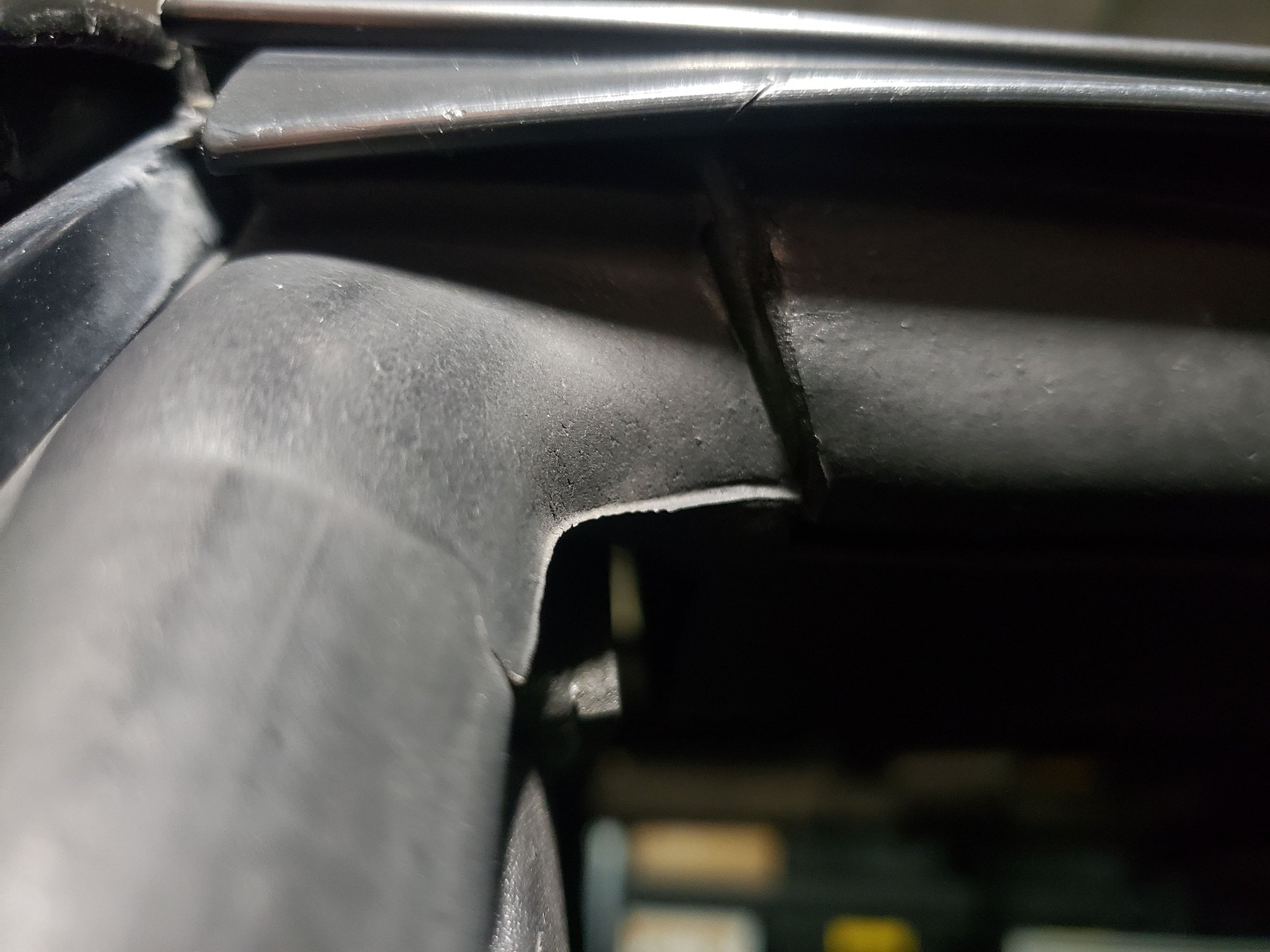

Brand new rubber all round from sunroof dr, and they still leak in the corners, quite a bit. Even with the previous 33 year old rubbers, they still leaked in the same spots. There doesn't seem to be anything I can do without making improvements but I have no idea how to even start.
I also recall one time reading a thread here with comments from a guy who cut and installed the c&c tops and he said none leaked when they left, I kinda find it hard to believe.
Anyway has anyone got this issue and come up with a solution?
There are sizeable gaps front and back even with the new rubber.

To put this short. You need to basically remove the seals, and stretch them more to fill the gaps. CnC made all the T-Tops for the fox body mustangs as well, and because of this, TTop seal installs on the CnC F-Body cars have more in common with the foxes than the GM TTop cars.

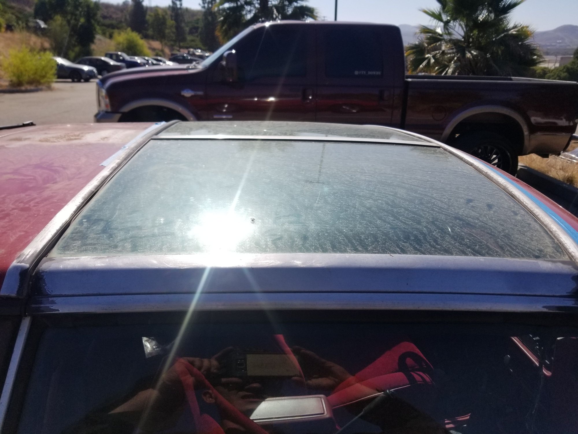

I have a T Top 83 Mustang GT, and had the same issues. Here is a super old picture before the resto. As you can see. Same design.
Good idea, thanks for that, I'll give it a shot.
