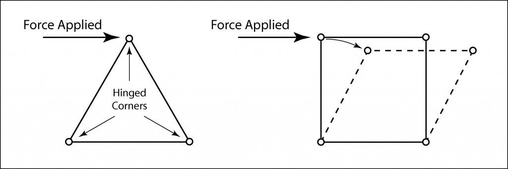

The cutout for the radiator is a large rectangle - and one of the weakest geometric shapes. Push on any one corner and all the others will move, creating a parallelogram before the whole thing comes apart. Adding those diagonal rods gives a huge amount of support to that rectangle by turning it into triangles - the strongest geometric figure.
