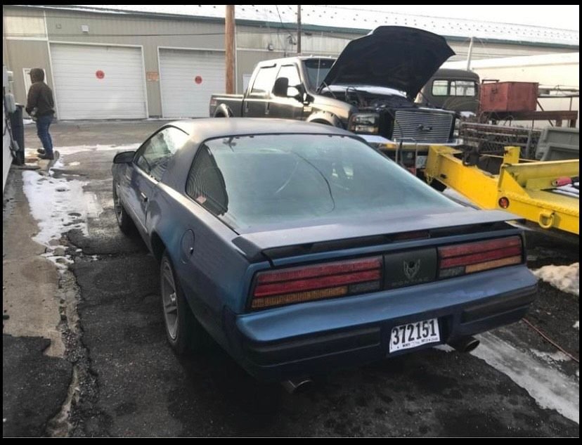

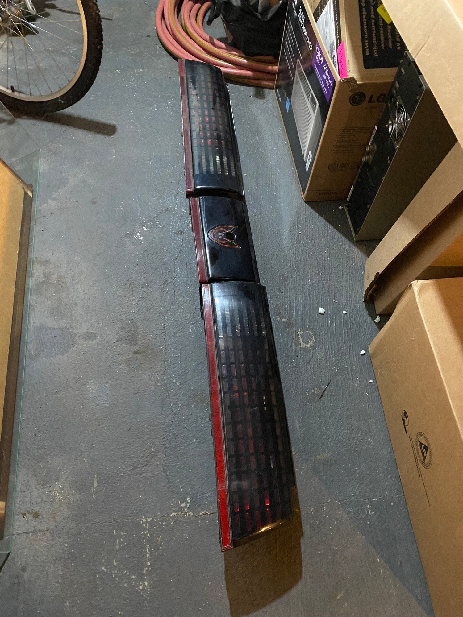

Hi everyone. My 87 base Firebird came with a spare set of Trans Am lights. I would love to do the conversion while I have some free time in the next couple weeks but I do not really know where to start. Any advice would be appreciated.
From this
To these

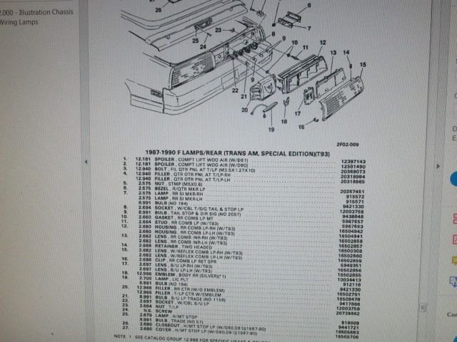

I wouldn't think you need anything special,just plug the backup bulbs and the three t/s,stop,running lights into the proper locations

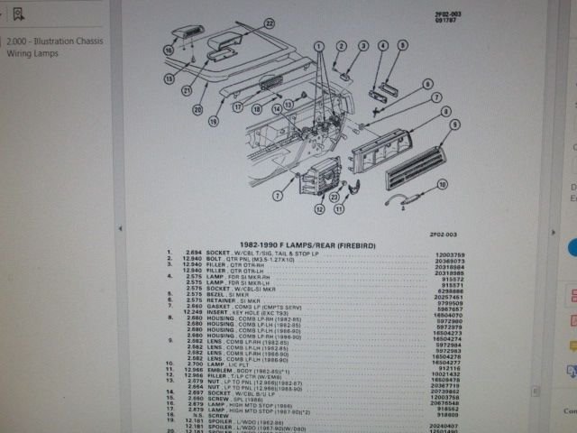

The base lights use a separate bulb for turn signals, while the T/A lights use the brake lights as brake, signal and parking lights

Wiring for Firebird/Formula to Trans Am taillight conversion - Third Generation F-Body Message Boards
check this one out... i hope it helps
