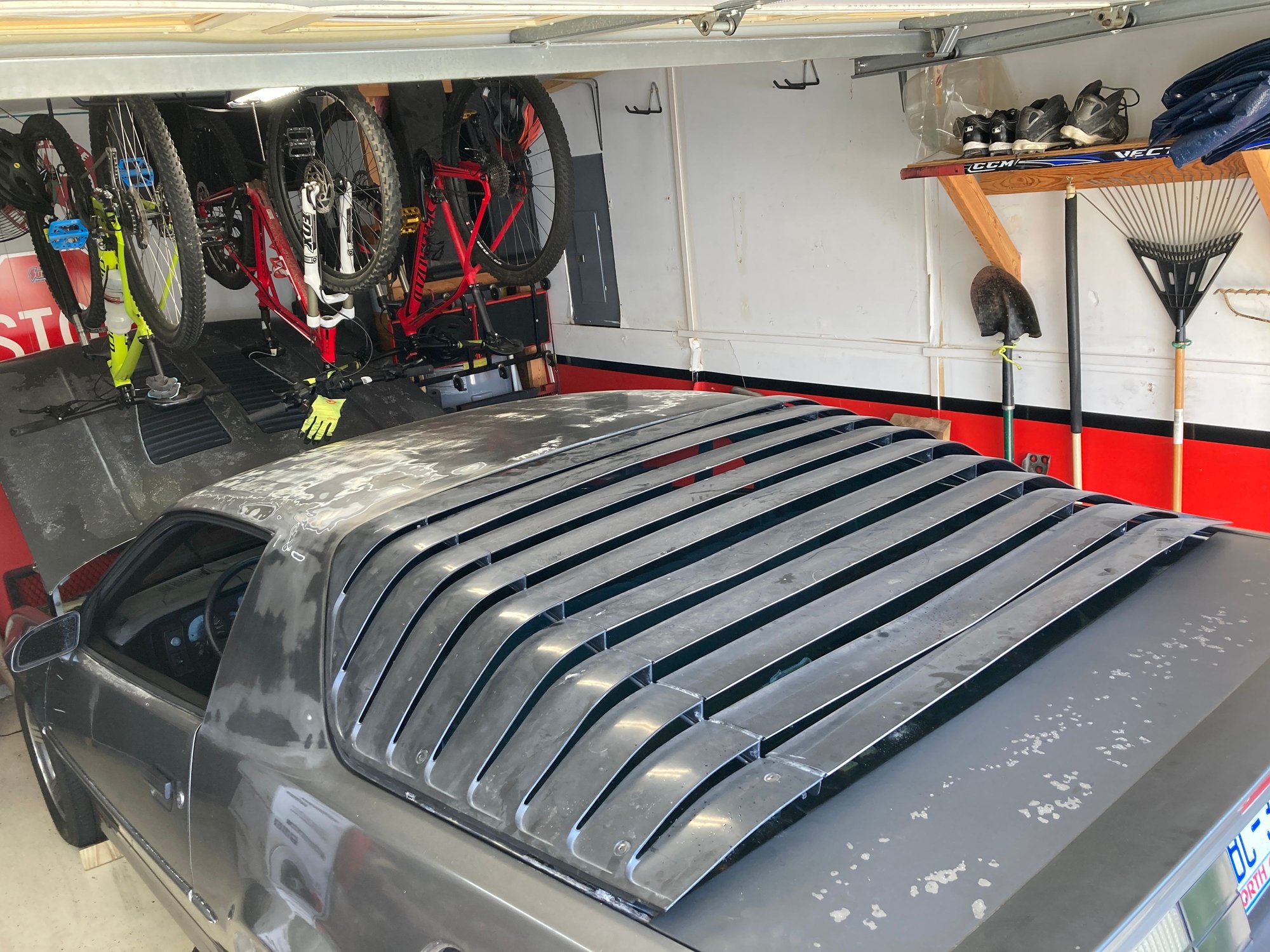

-The main thing I'd look for are obvious physical damage first of all, and second, are the middle horizontal pieces straight? I attached a pic of mine and you can see they are NOT straight. Some have some minor bends. ....still trying to figure out the best way to fix them.
