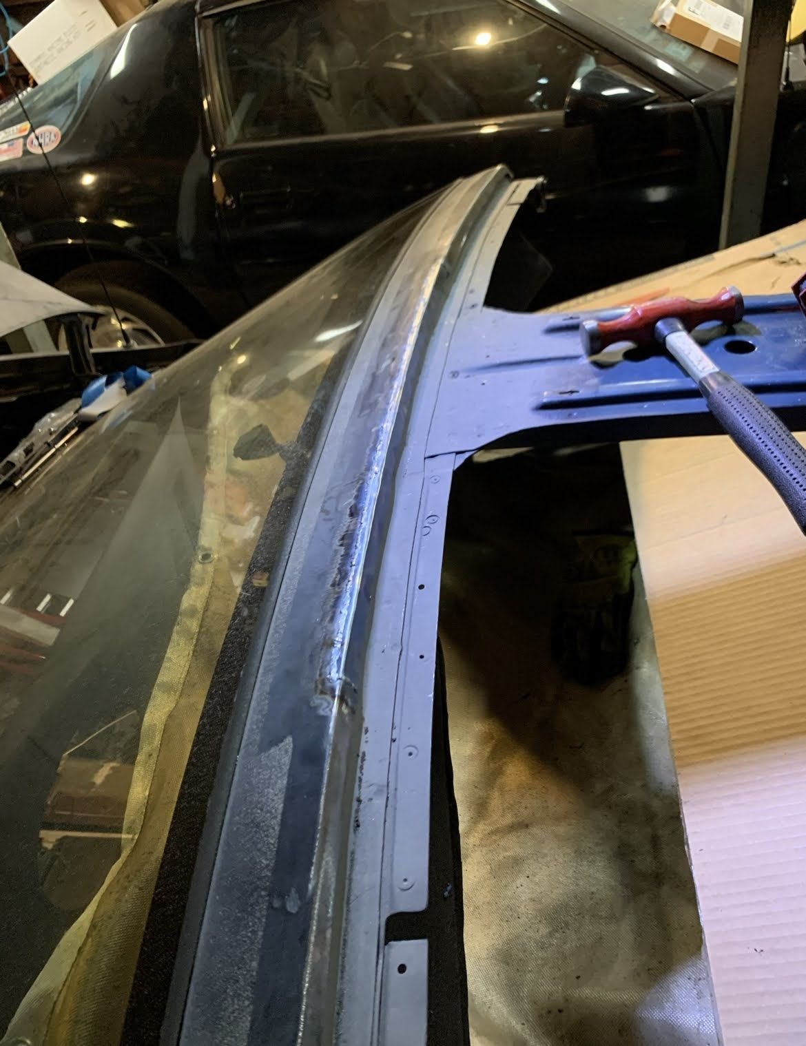

Here's the front channel partially ripped up, showing the damage under neath
Here's the back channel also partially ripped up

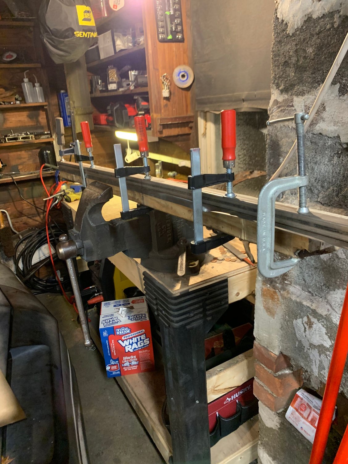

This is how I shaped the sheet metal going under the front t top channel, did the same for the back channel as well
You can see the shrinking marks on the panel, a couple more tweaks after this and it fit well

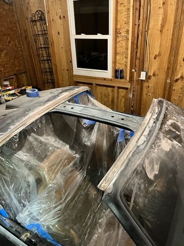

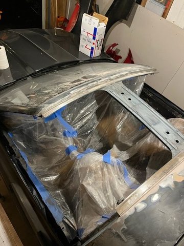

Here's the only couple pictures I have with the new channels welded in. As you can see the car is in a different garage now. I finally have it back in my possession to work on
Additional angle. the car needed a decent amount more filler than is pictured here

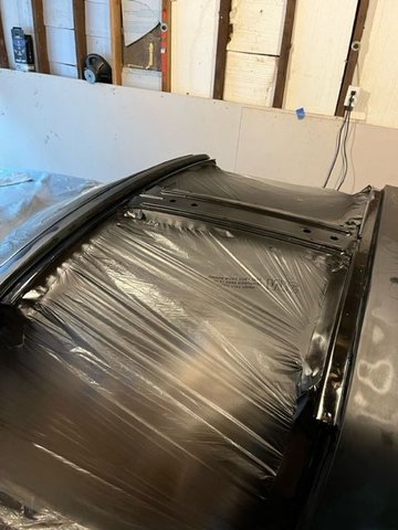

After three years, the t top section is finally sealed with epoxy primer
I may keep updating this thread as the car gets completed. The next big hurdle will be finishing the t top section paint and getting the gaskets in. For the past two years I've had to make sure this car stayed in some form of enclosure due to it not having a sealable roof, all while never even having access to the car due to family issues.
