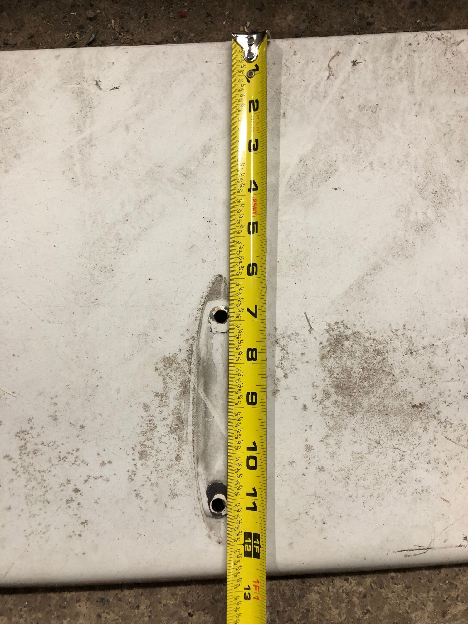

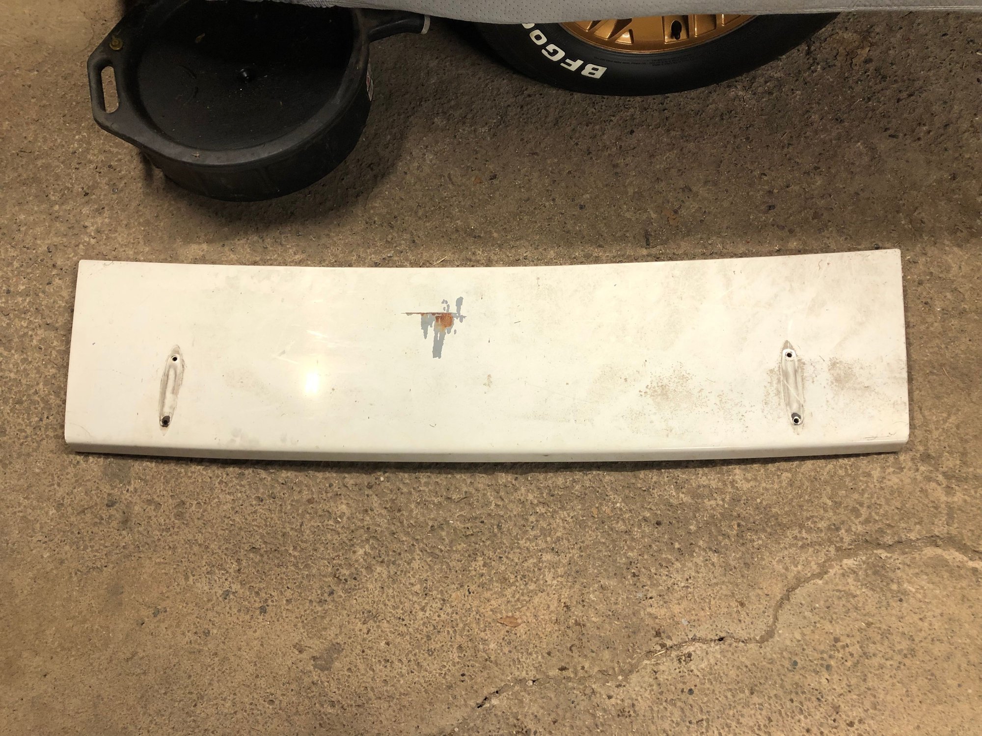

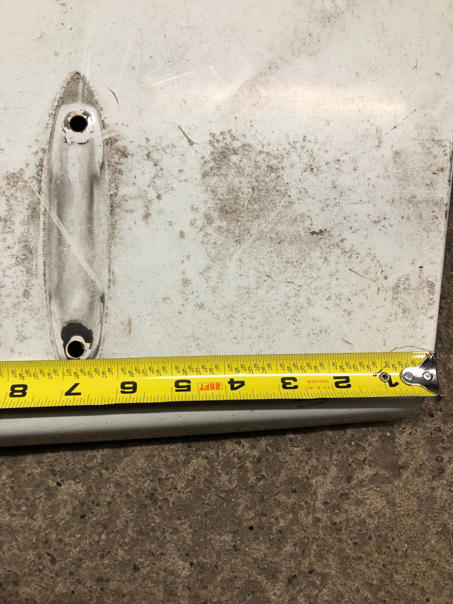

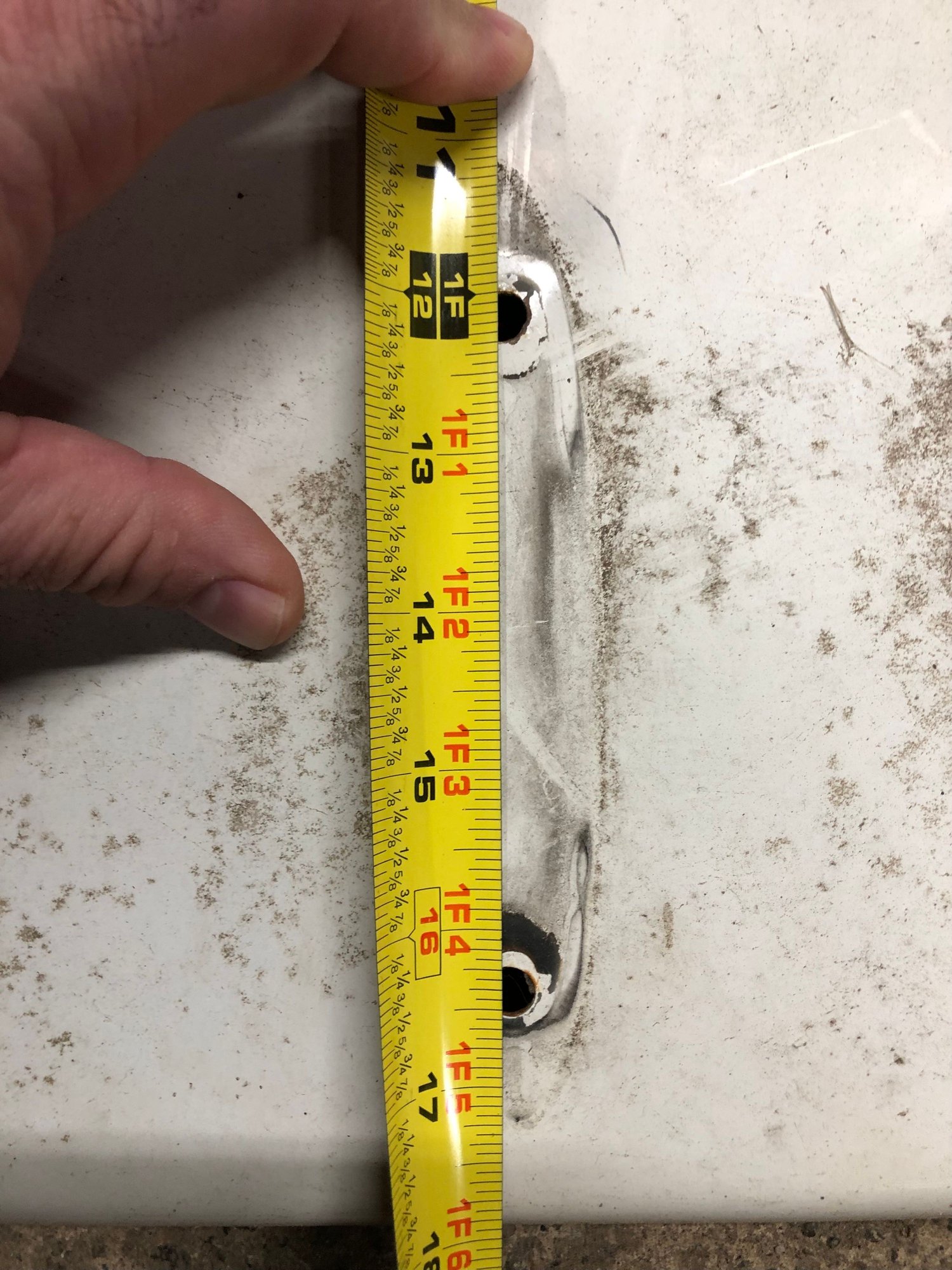

Took some pics & measurements for you. This piece is from a 1984 Trans Am with a flat pedestal spoiler. The long measurement between holes (center of hole to center of hole) is 3’-3 3/8”
