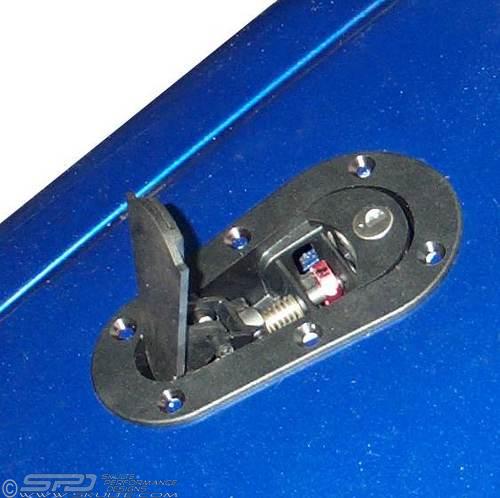

I needed to do something about my hood sticking shut (the infamous thirdgen "bang on the hood, and it'll eventually pop up" problem), as I am paranoid about an engine fire at the track, and remember when Tom Byrne's car caught fire. In any case, I decided to install locking Aerocatch hood latches. This lets me lock the hood if I'm at a public parking lot at the grocery store, but leave it unlocked for track days. No worries about punk kids unpopping the hood and messing with the engine or car, either. I snapped a few photos as I installed them, and put it up on the Z28tt photo gallery. If there's enough interest, but I was considering becoming a distributor, but first I'd like to make sure it holds up.
You can go to www.skulte.com/gallery, and navigate through the Z28tt Pictures link, or just click below.
http://www.skulte.com/gallery/view_a...umName=album01

Ha ha! I’ve been happy with them almost 20 years later, but you have to be careful closing them. I broke the first set, and they replaced it under warranty, and redesigned the stop (so the pin doesn’t slide back as far).
You don’t want to force the lever when the catch pin is binding on the vertical pin. Make sure to get it aligned perfectly and you’ll be happy.

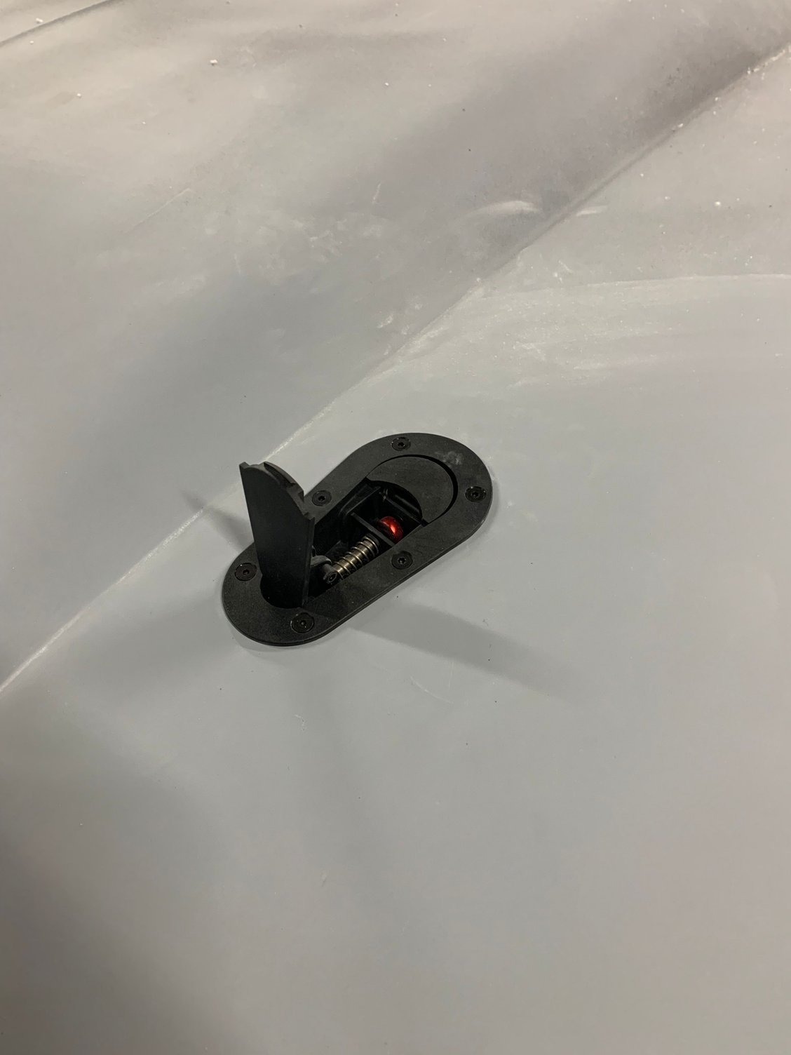

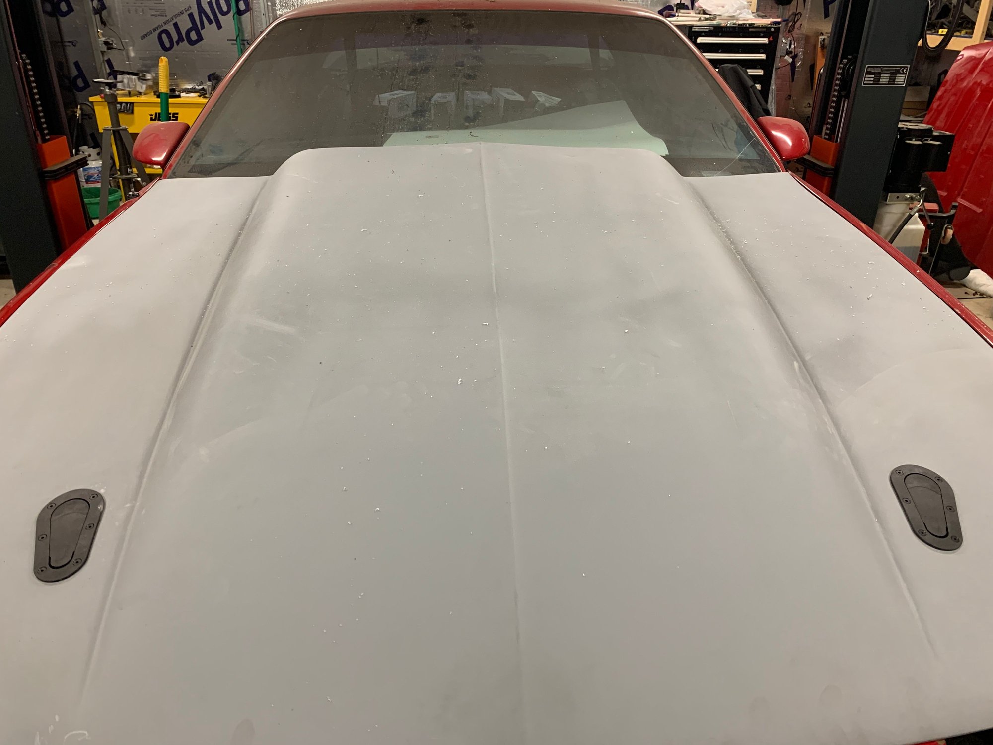

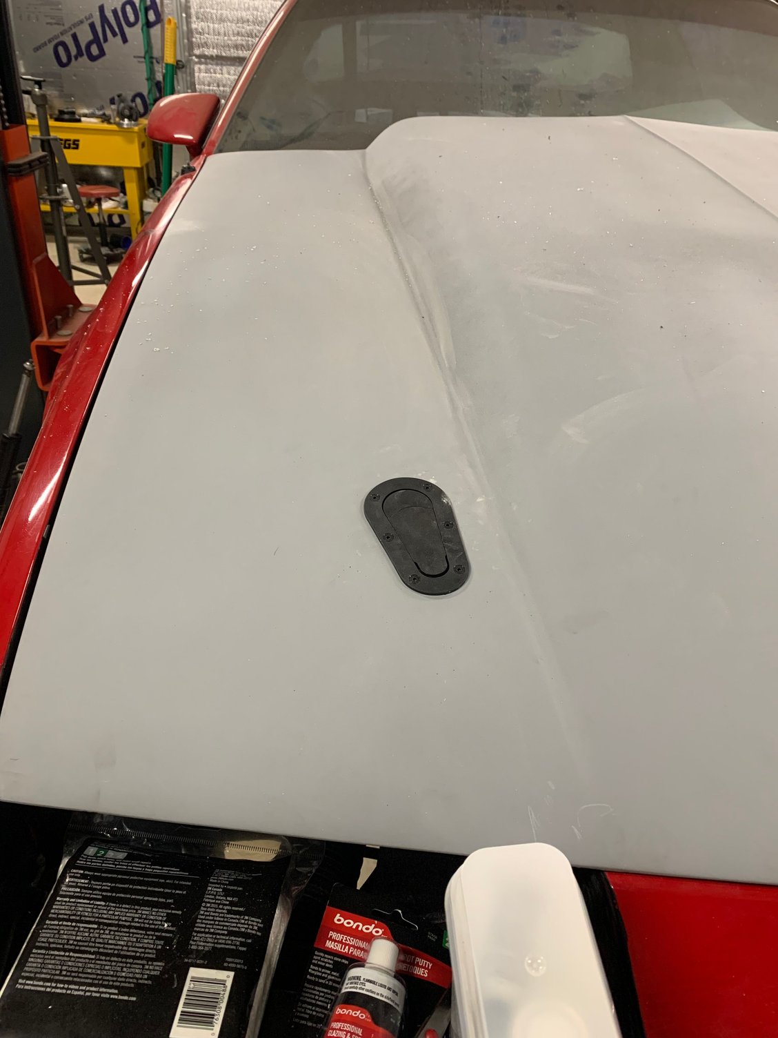

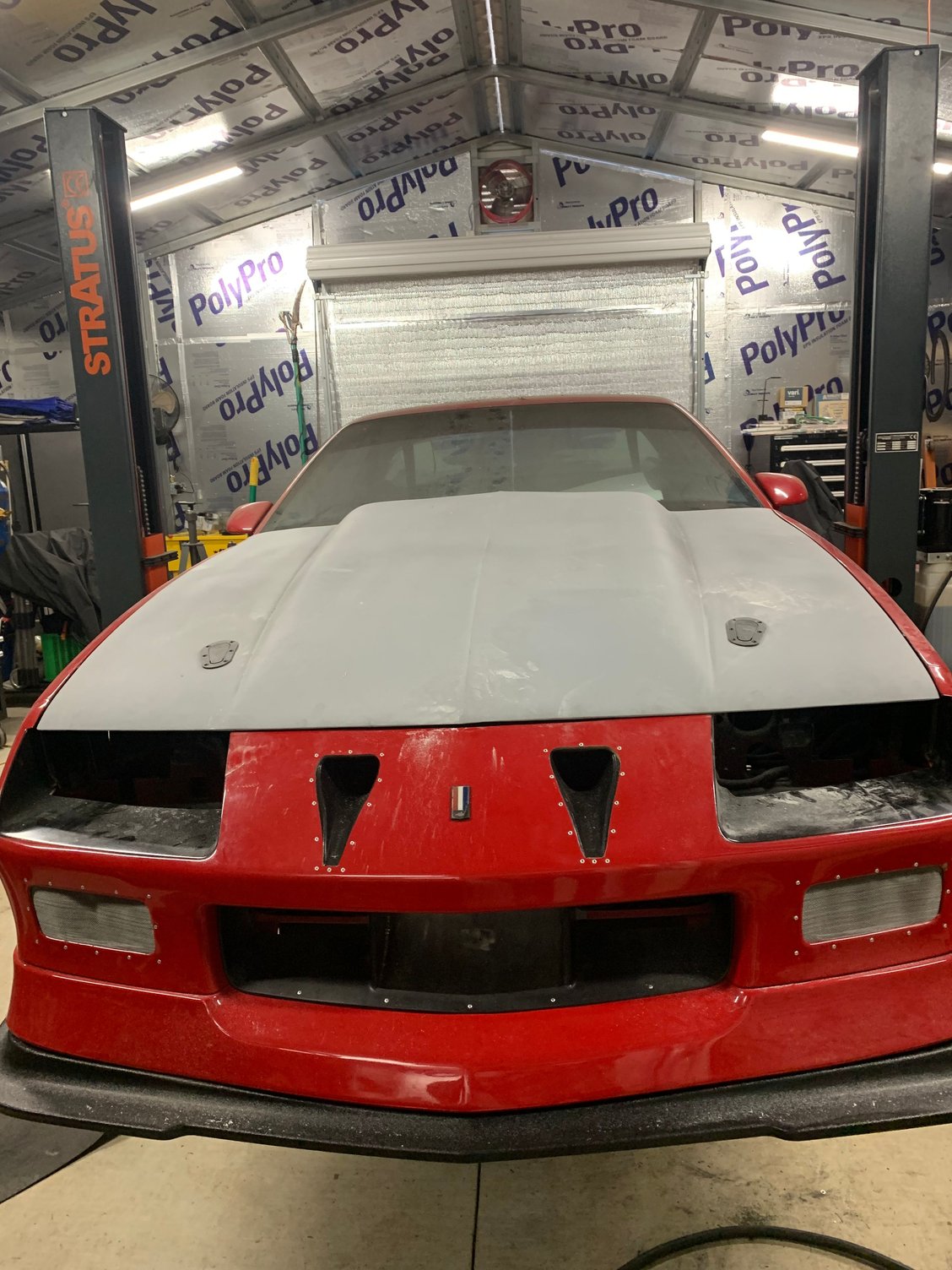

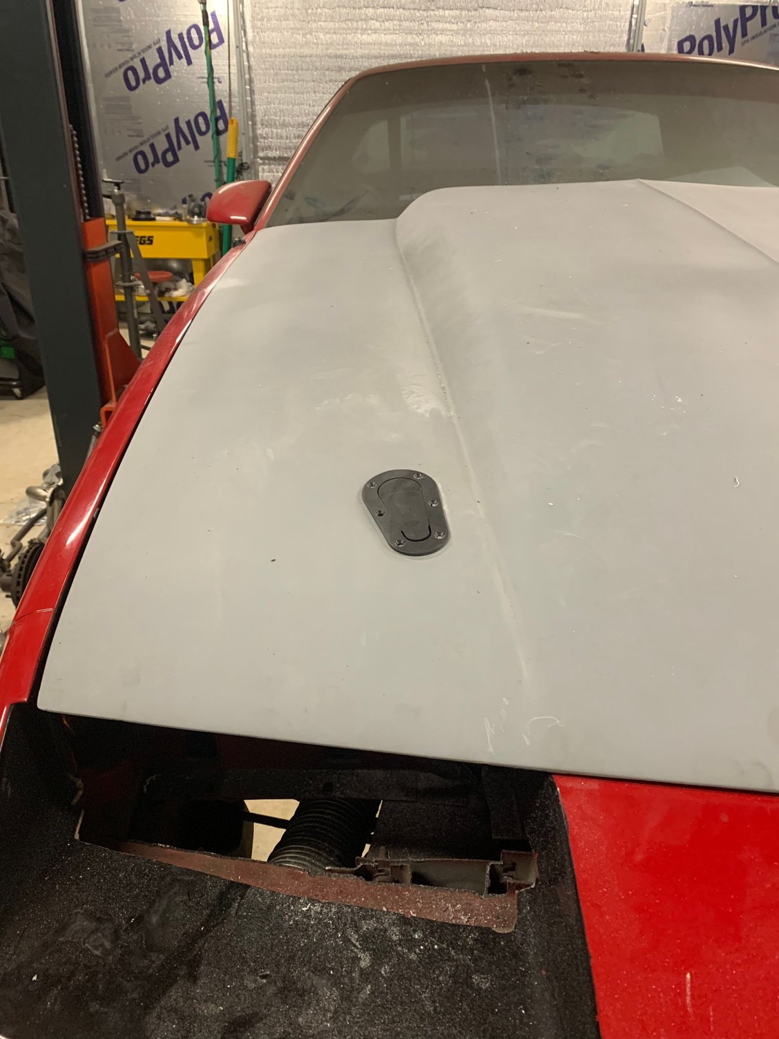

I did mine and they were easy to install and they work good so far. I did not do key lock ones because the sanctioning body will not allow them.

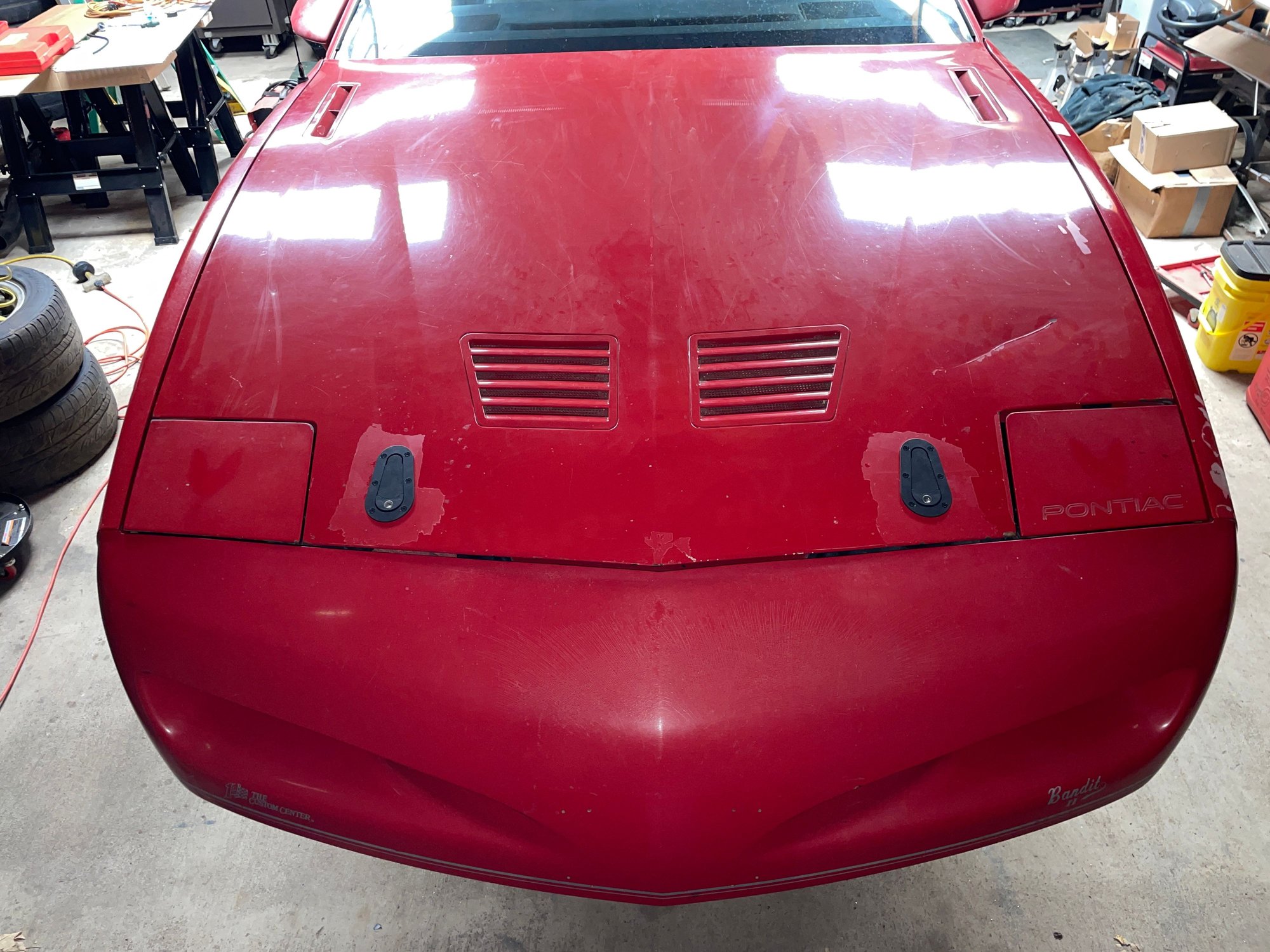

I did mine last Dec.

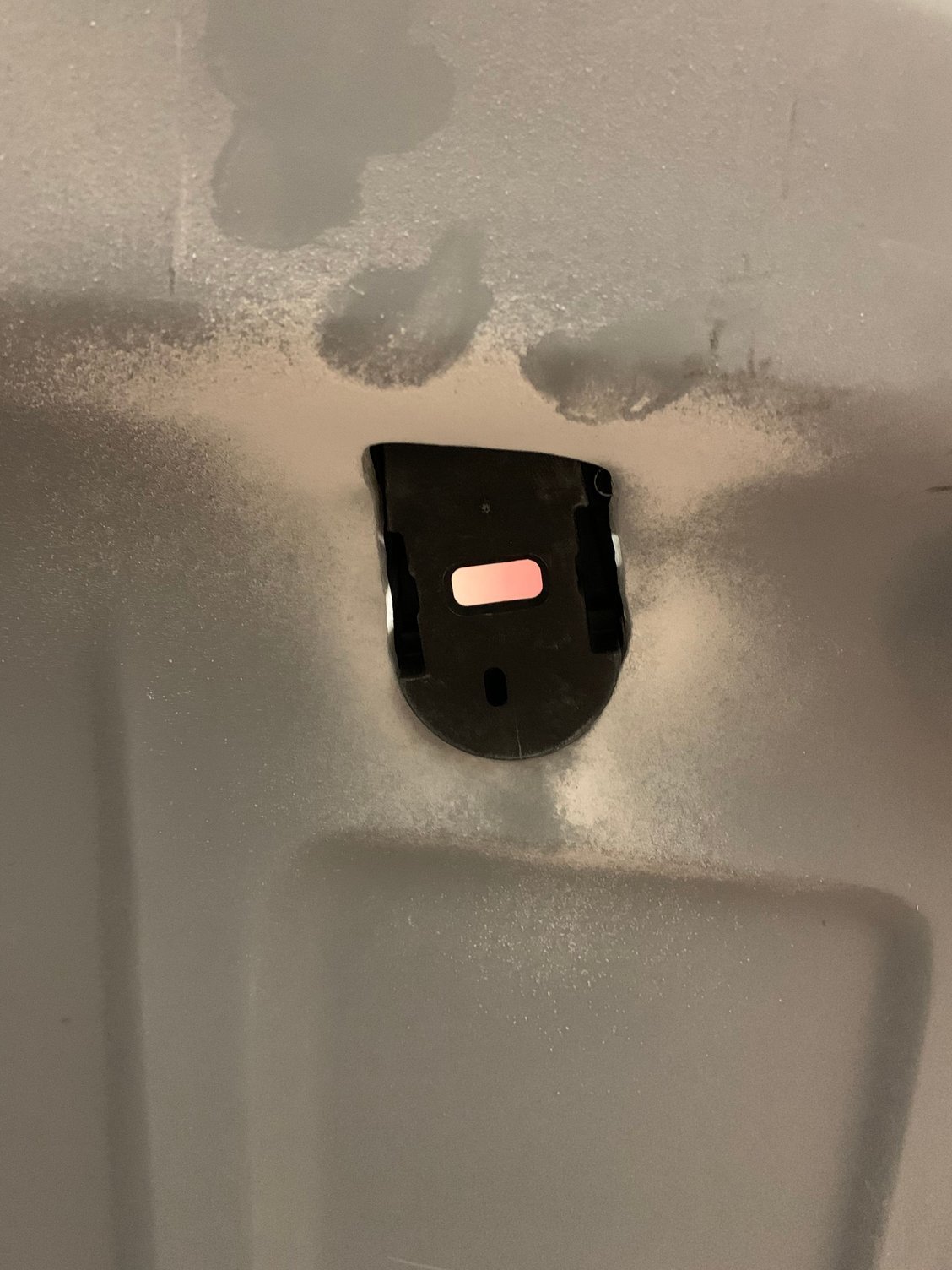

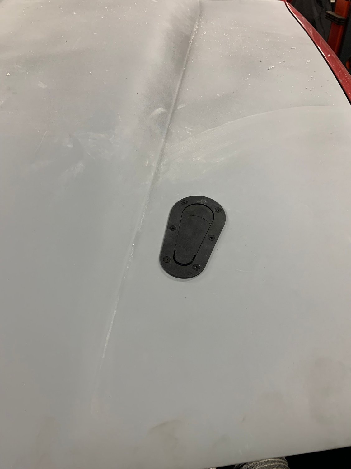

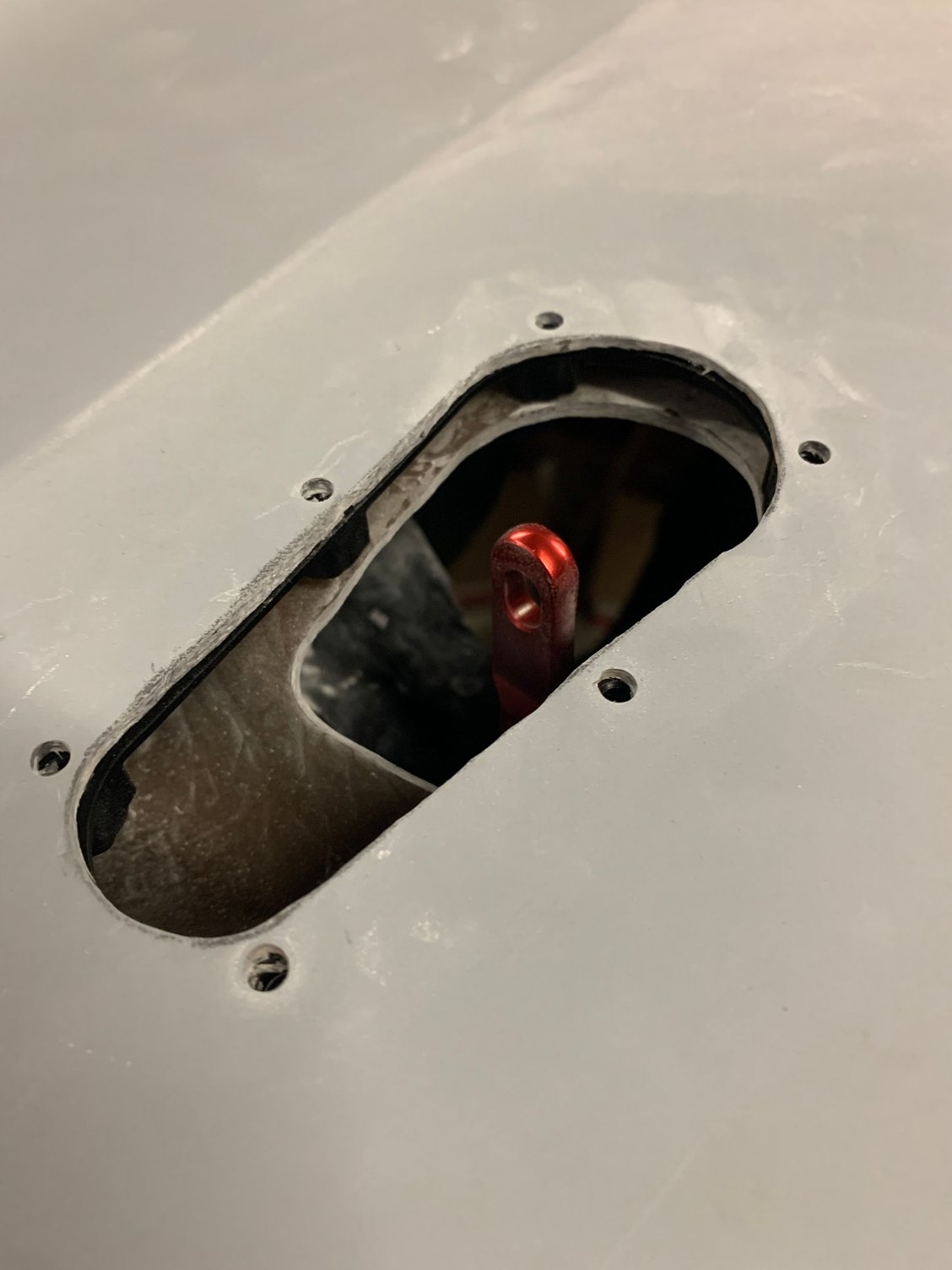

Almost done, just need to reglass the underside
