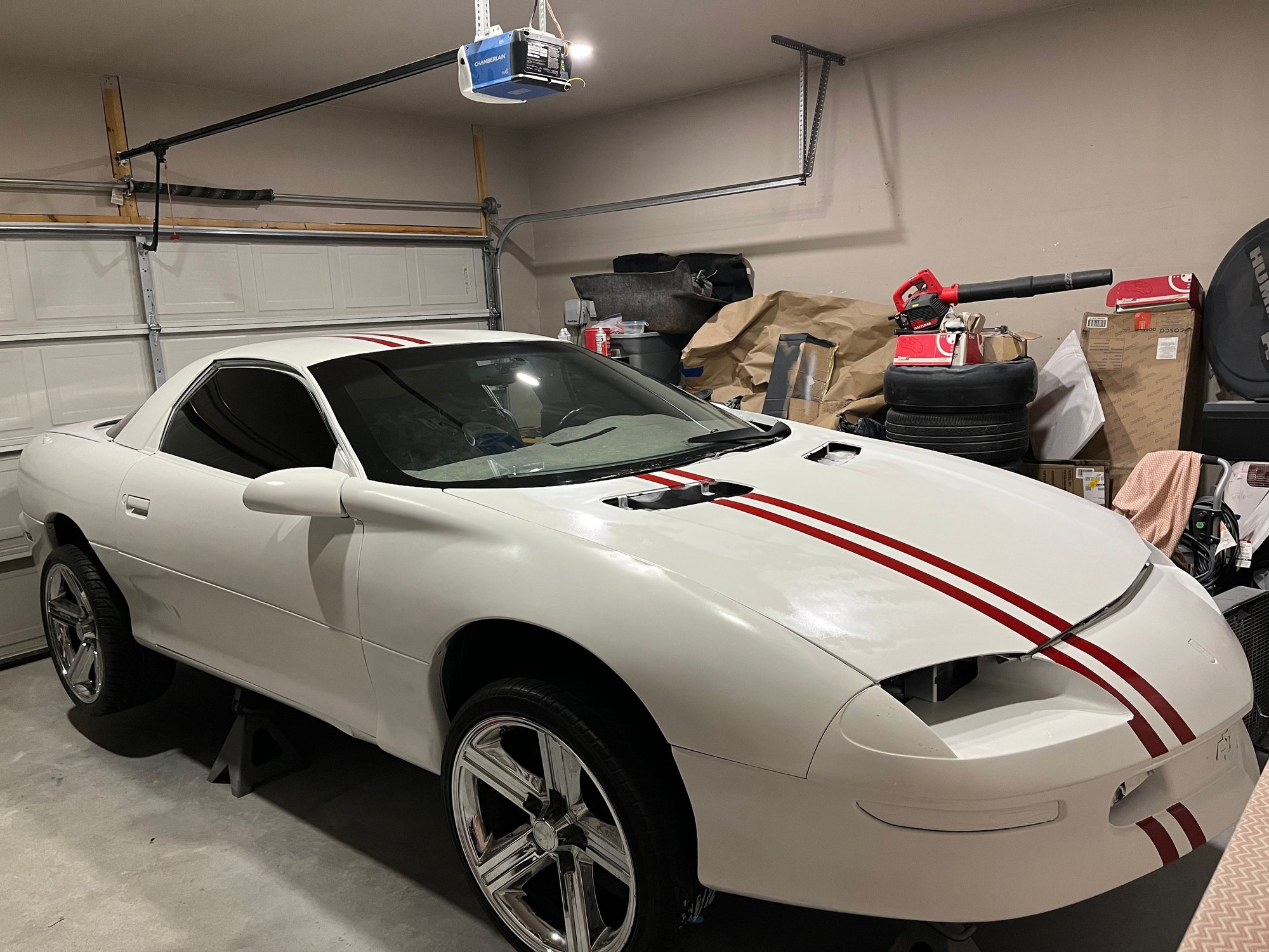

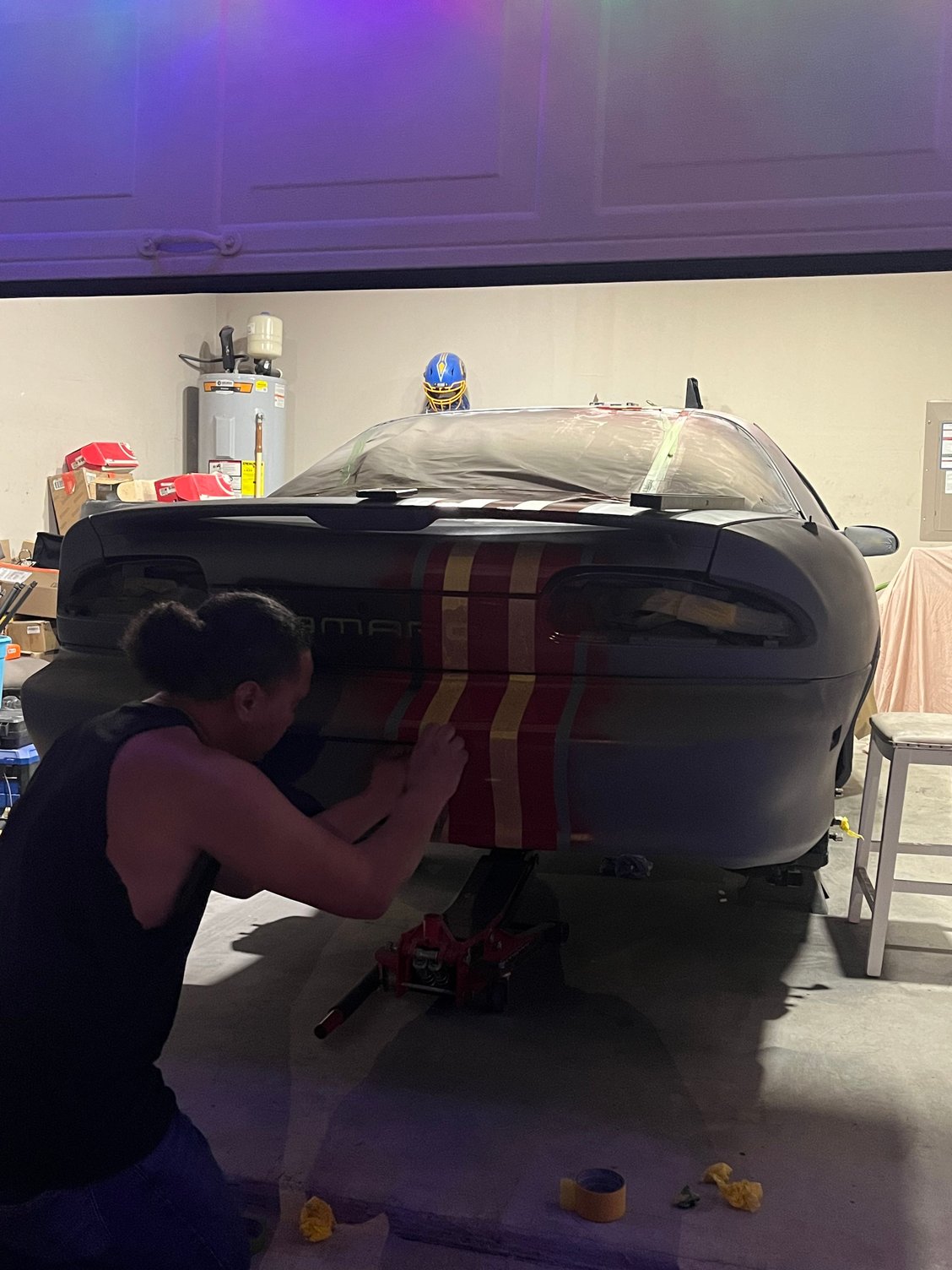

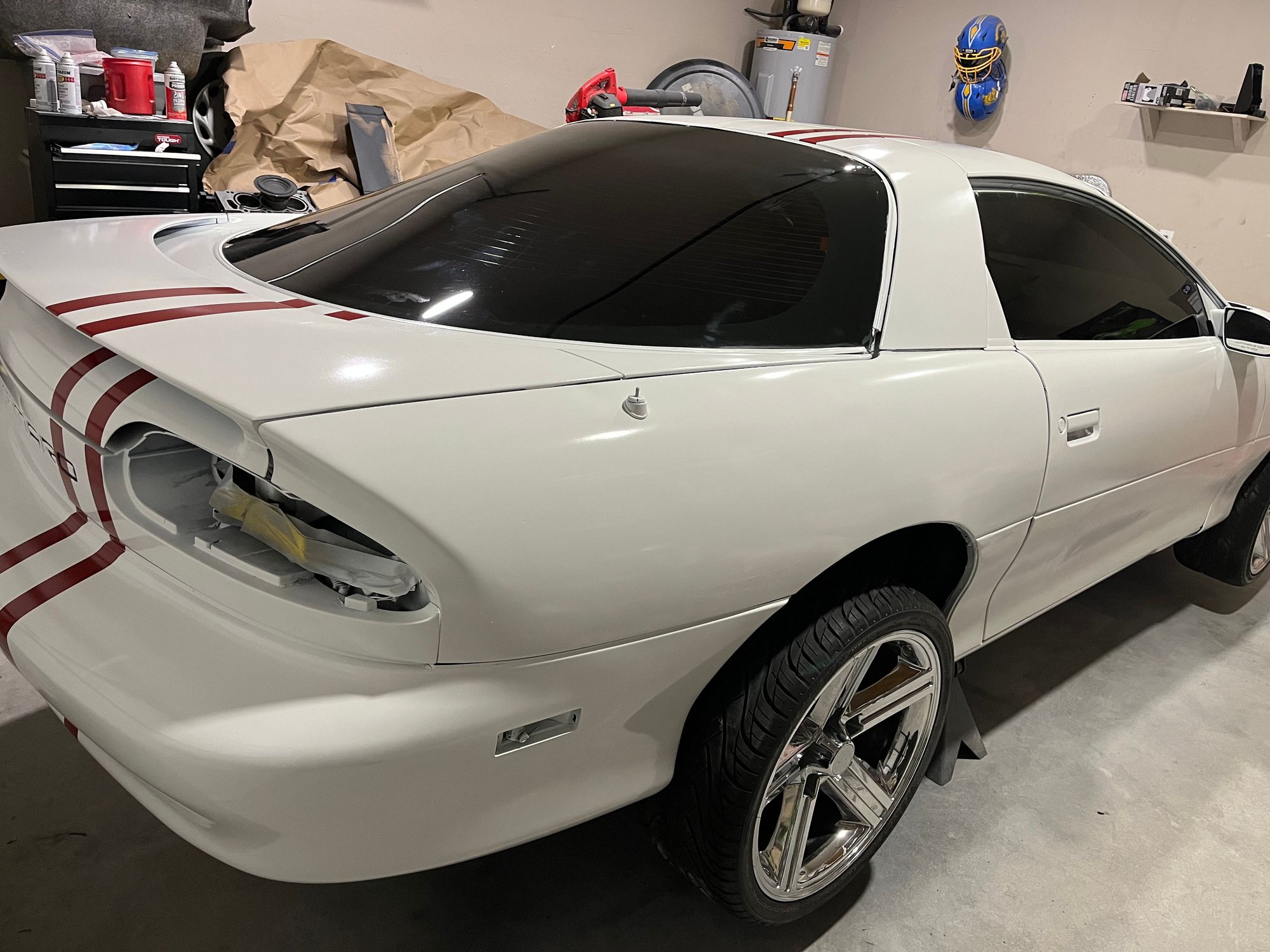

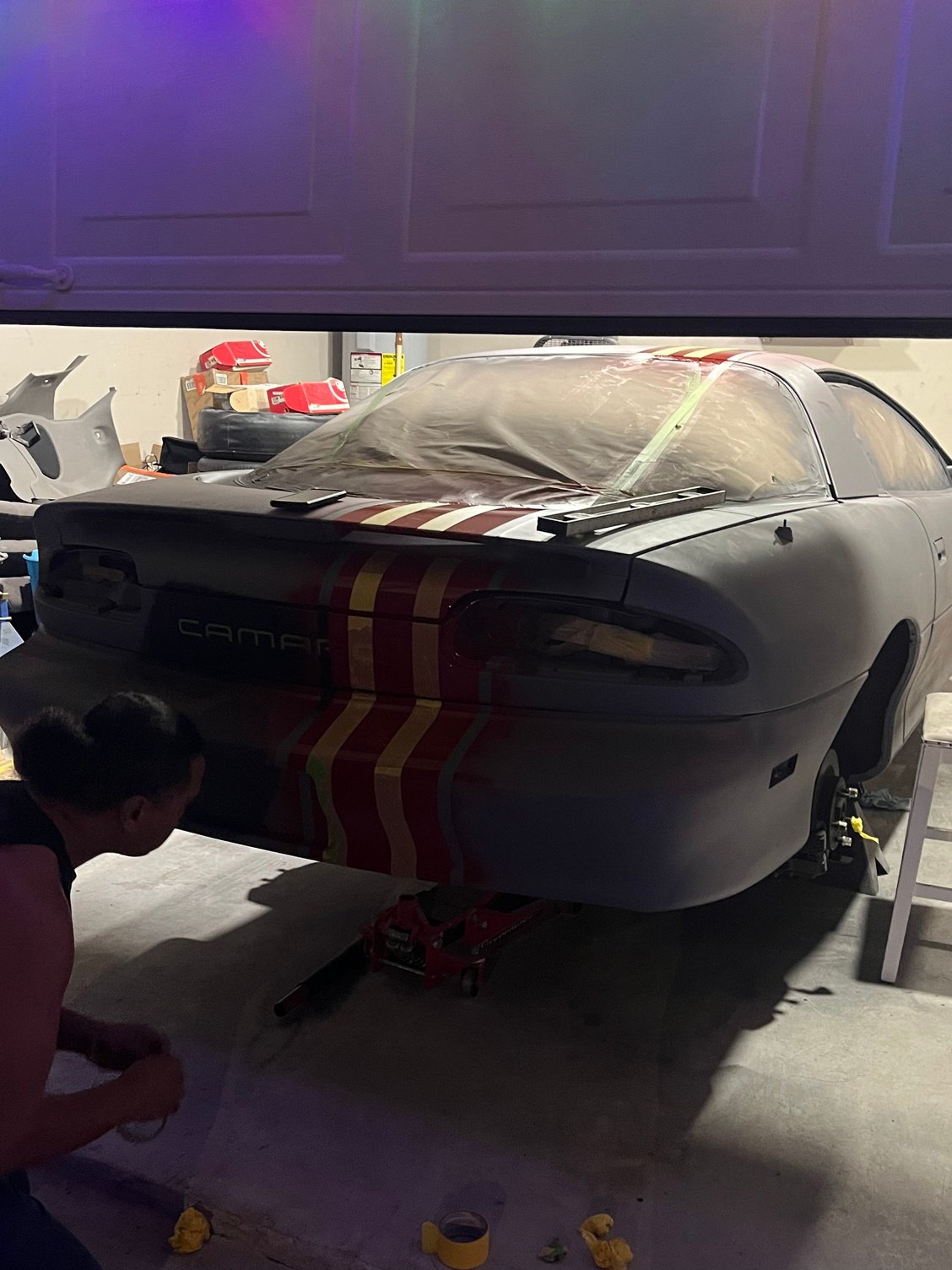

Rattle can paint job under 100 dollars
https://youtube.com/shorts/1D8nmeoA6ww?feature=share

Not worth it. In one year it will look like crap.

It ended up looking okay. Painting over details bothers me personally. The thing about spray paint is it's soft and doesn't have UV protection on its own, so it's going to get killed by the elements. Assuming it was laid down thick enough to do so, that paint needs to be wet sanded and then covered in a 2k clear (respirator required type paint). Then probably wet sanded again, and buffed using your standard compound -> polish -> glaze -> wax.

That’s a waste of money and time. Do it right or don’t do it at all.

will look horrific in a few months. there's nothing durable about rattle can paint. anything that makes contact with it will scratch right through it

Touch up in a pinch maybe, whole car not so much!

my rule is when a car is rattle canned or primered, it will be in the junkyard in another year or 2.

it will look terrible in a month...... that and rattle paint is soft and peels easy... if hes planning to scrap it oon itll be fine but if he plans to "do it right" in the future, it will be a nightmare removing that paint.........
