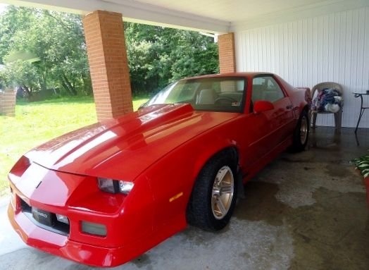

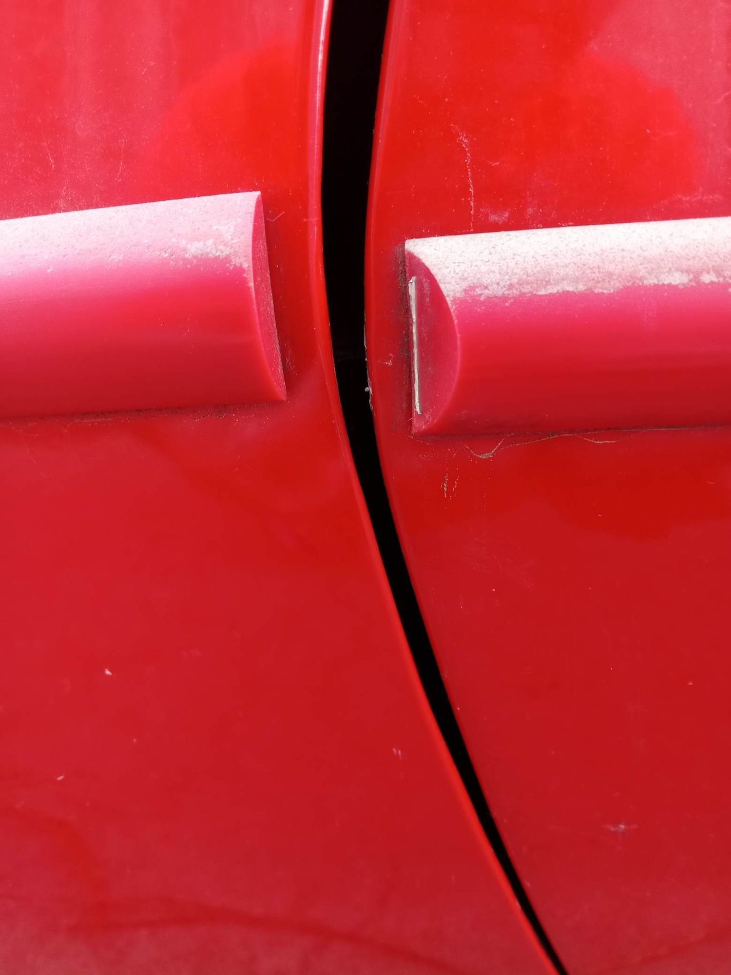

I am so sorry for not getting back to you, I have had a lot going on and forgot the post. It rubs at the bottom right where the paint is missing. It's my fault I tried to jack up the car right under the back of the driver-side fender. The tire was dry-rotted and flat from setting so long. And that is what caused the door to rub. Here are a few pic's Thanks for the help.

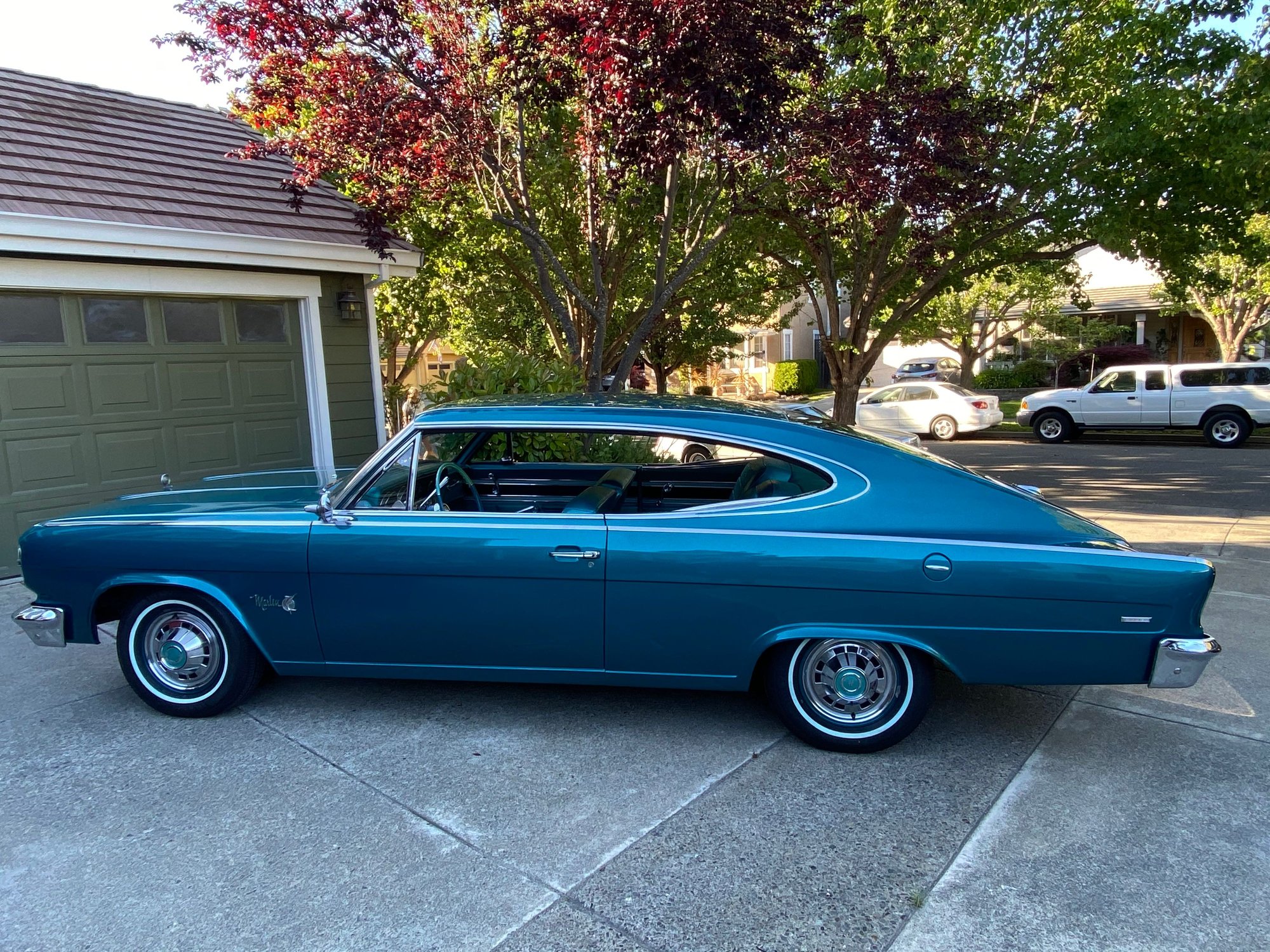

I had MAACO in Santa Rosa, Ca. paint the 1966 AMC Marlin, I rescued and restored. This was during Covid, when business was SLOW! MAACO* did a GERGOUS JOB, single stage polyurethane, in the original factory color! Price was a DEAL at less than $3000.00
I did NO prep, except remove trim, head and tail lights, bumpers and grill. The guy I sold it to took it to a local show and it won FIRST PLACE!
* Not MAA
CO anymore I heard, same folks but left the franchise, IIRC.

Looks to me like you have physically bent the fender upwards when jacking it as the lower mount is probably bent upwards now. Pretty sure its going to have to be bent back down but would need to see a bigger picture of that area as well as how the door to quarter fits.

As stated, the lower fender mount needs straightened back out.
