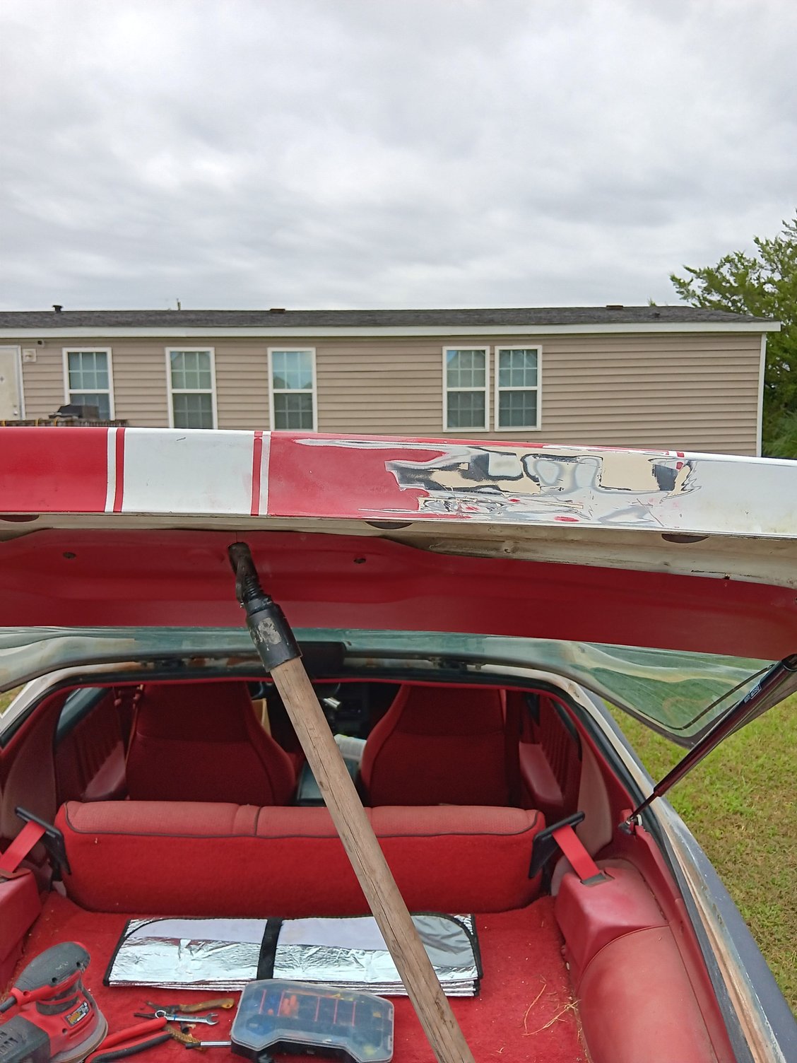

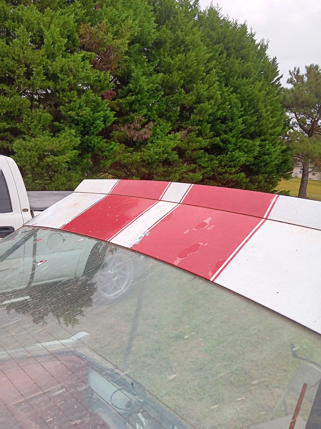

Trying to get ready for some paint ALL SNOW WHITE. DOGGONE racing stripes won't come off. Heat has almost no effect. Any ideas? 91rs

From the look of it those are painted on. I can see the clear failing.

If it's painted on that means I have to get a more aggressive sand paper than 220 grit to cut through it correct?

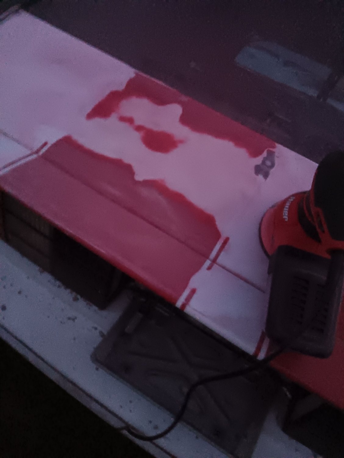

Used the eraser for the pin stripes. And 220 and a harbor freight 5in orbital variable speed sander for the racing stripes.
Pin stripes about 5min
Painted racing stripes about 10-15min and the results are in the pics. Thx TGO
