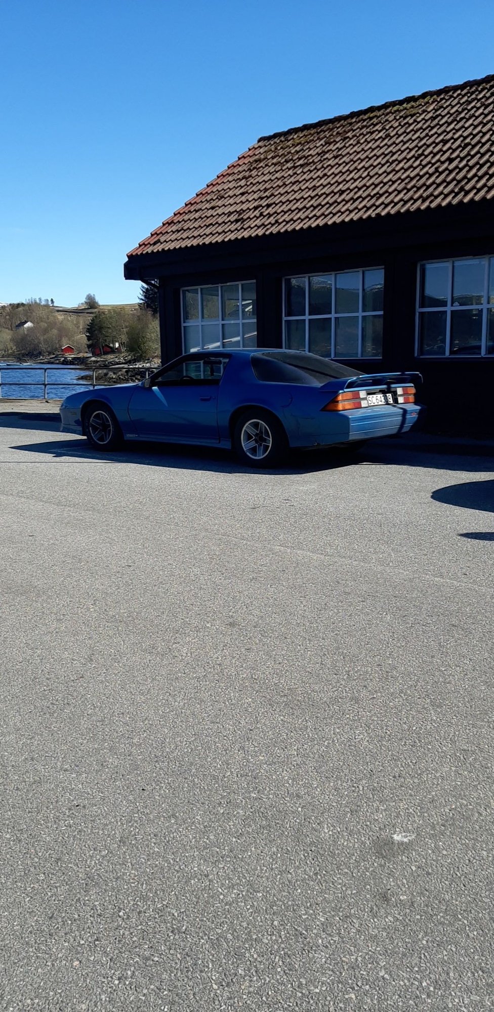

Camaro to trans am conversion
Hello, hope this is the right place to post this.
I have a rotted out 82 camaro with a pretty good drivetrain and exterior parts, but as mentioned its rusted practically beyond repair. I got an offer to buy a good rust free 1987 trans am Firebird rolling chassis and know that these cars are pretty similar. Could i theoriticaly throw all the good parts including front bumper, hood ect from my camaro on the Firebird?
Im aware the taillights and maybe the spoiler wont fit, but thats ok for now.
Any advice would be appreciated :*)
