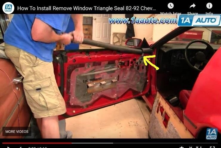

Here is the vidoe that I found :

Just Don't Remove The Door Panel Like The Guy In The Vid Did,He Broke The Top Molding Lol
where is it broken? I can’t tell I don’t want to break mine though
