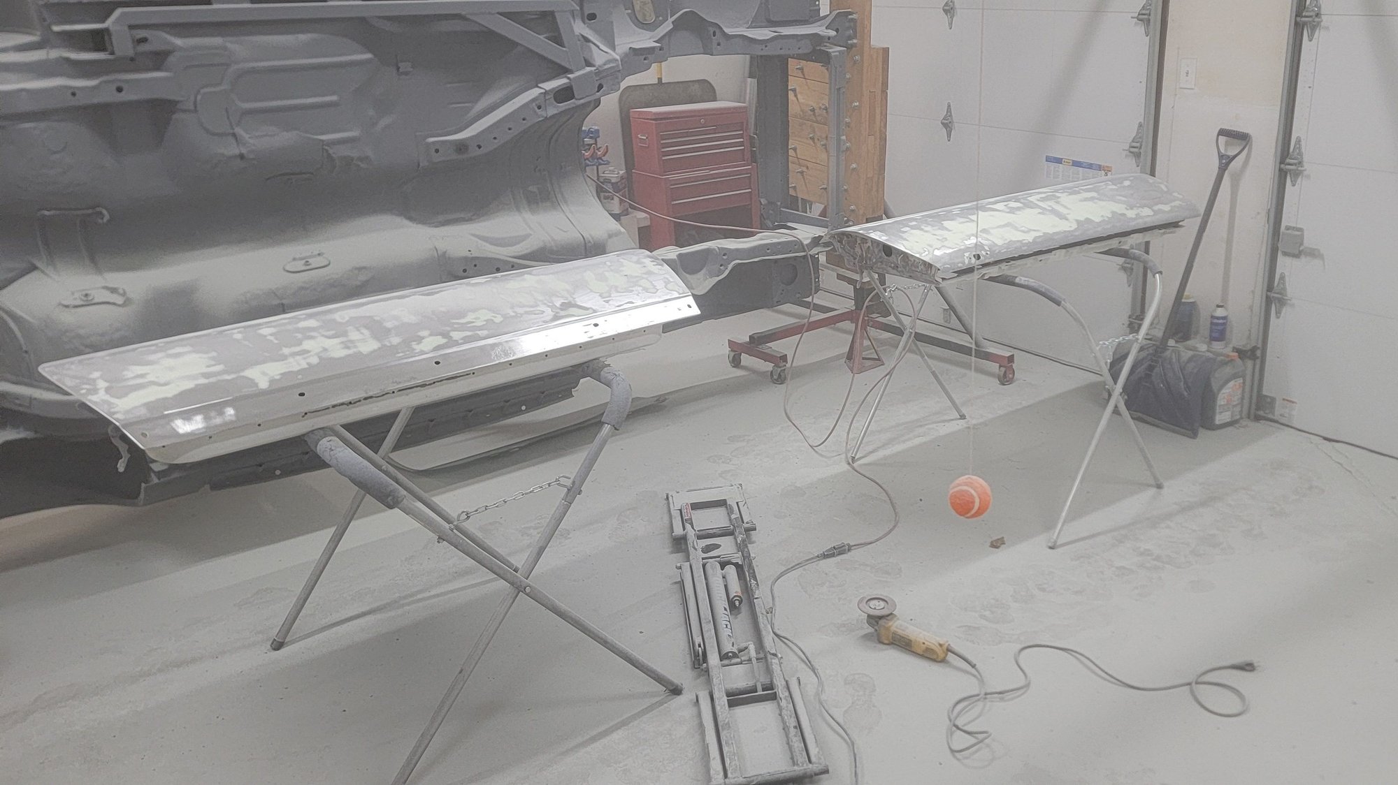

The aftermath of using a surface conditioning tool to strip the doors.
I went down deep enough to remove all the paint and primer. I figured the last bits of bondo don't matter since I will be addikg back to it soon enough.
Tried showing how coated in dust everything was.
Going to media blast the hinges area tonight and do a once over to the outer skin with a DA, then wipe them down and spray some epoxy primer to seal everything.
Will worry about stripping the jams at a later stage.

You can actually see the small area in the first photo. It is between the two GFX holes. It is pretty small. And thr pitting is completely full of bondo. For that specific area, I think a bit of converter for 10 min, pre painting prep, and epoxy primer will be good to go.
