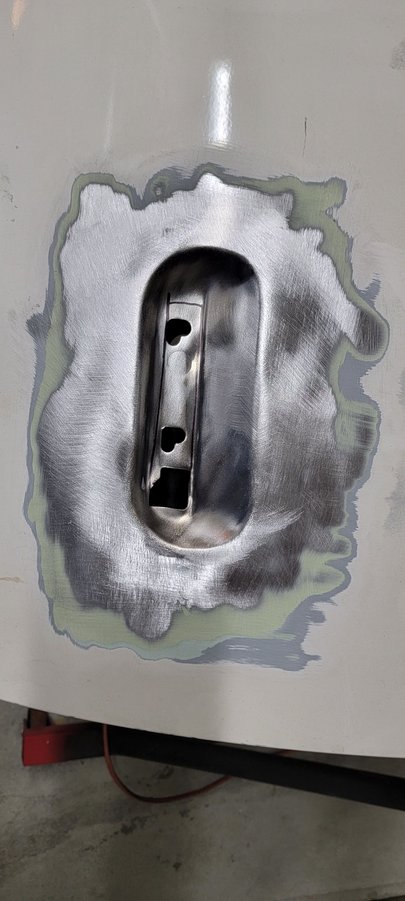

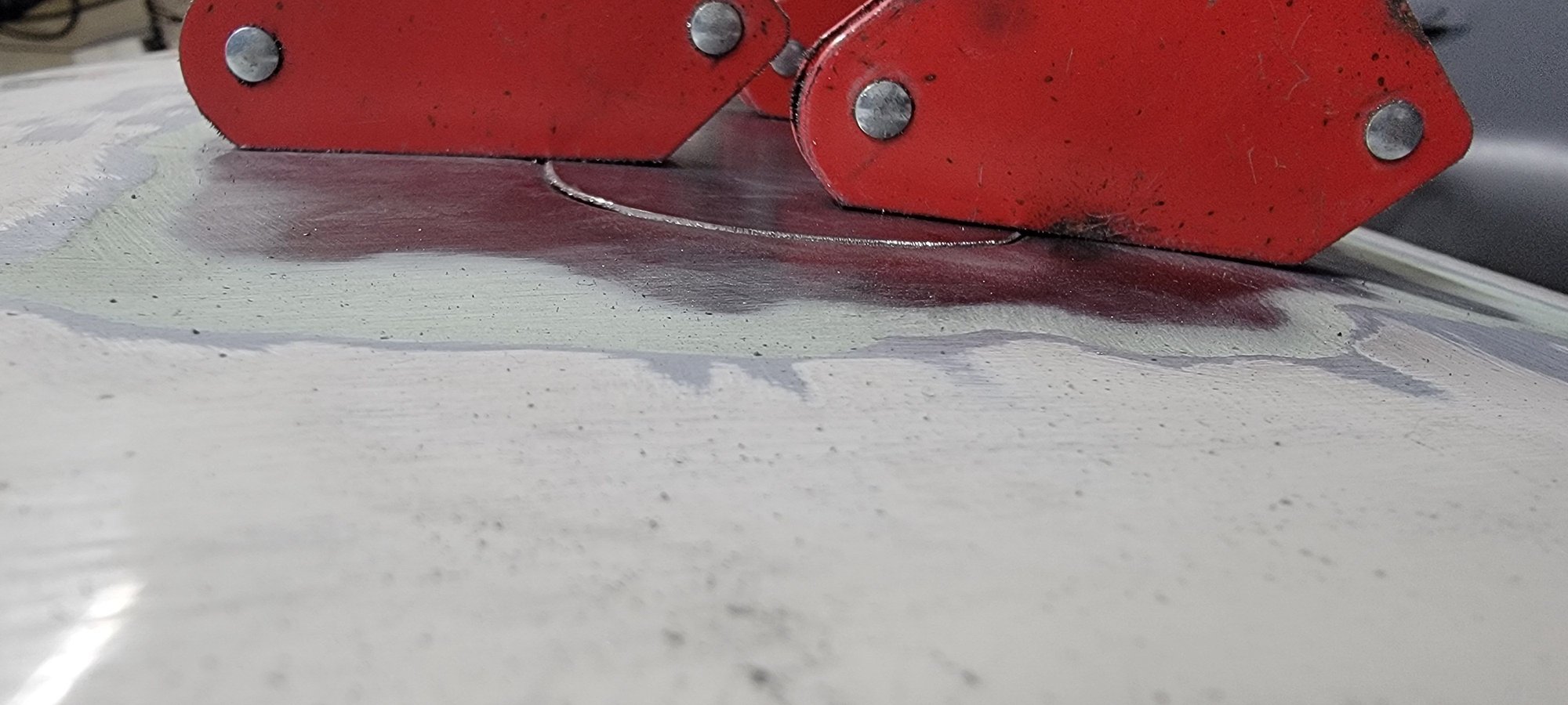

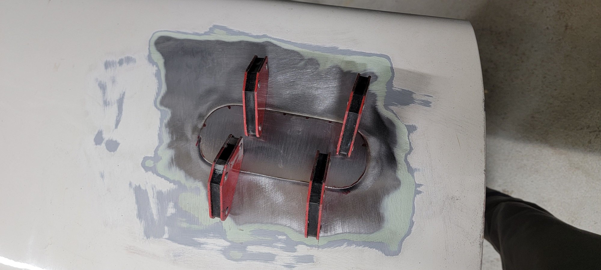

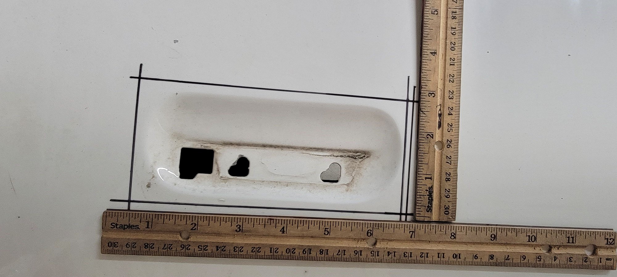

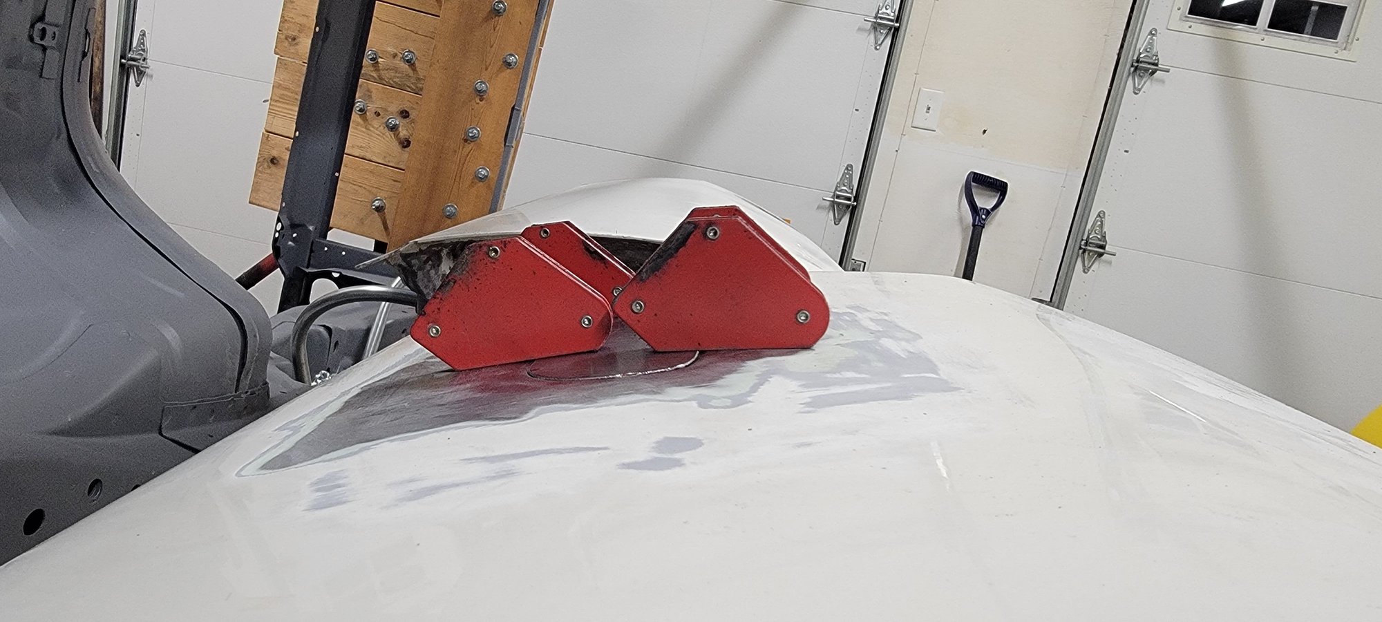

I am shaving my doors handles on my restomod 91 Z28. I had the locks shaved off 10 years ago and am in the middle of doing a full rebuild on the doors. I noticed that the guy that shaved the locks didn't cut out the lock depressions, he just welded a plate over. I am guessing that is less than ideal. Right?

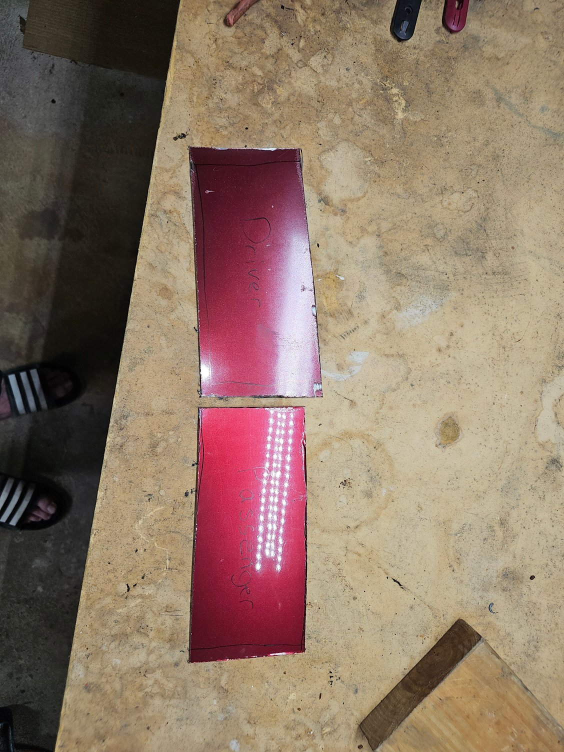

For the door handles, it would be ideal to have a donor door to get curved metal from, but I don't have that. I figured I would cut the depression out, form some sheet metal the best I can and tack it in place. Then skim it over with filler.
Any advice on this approach?

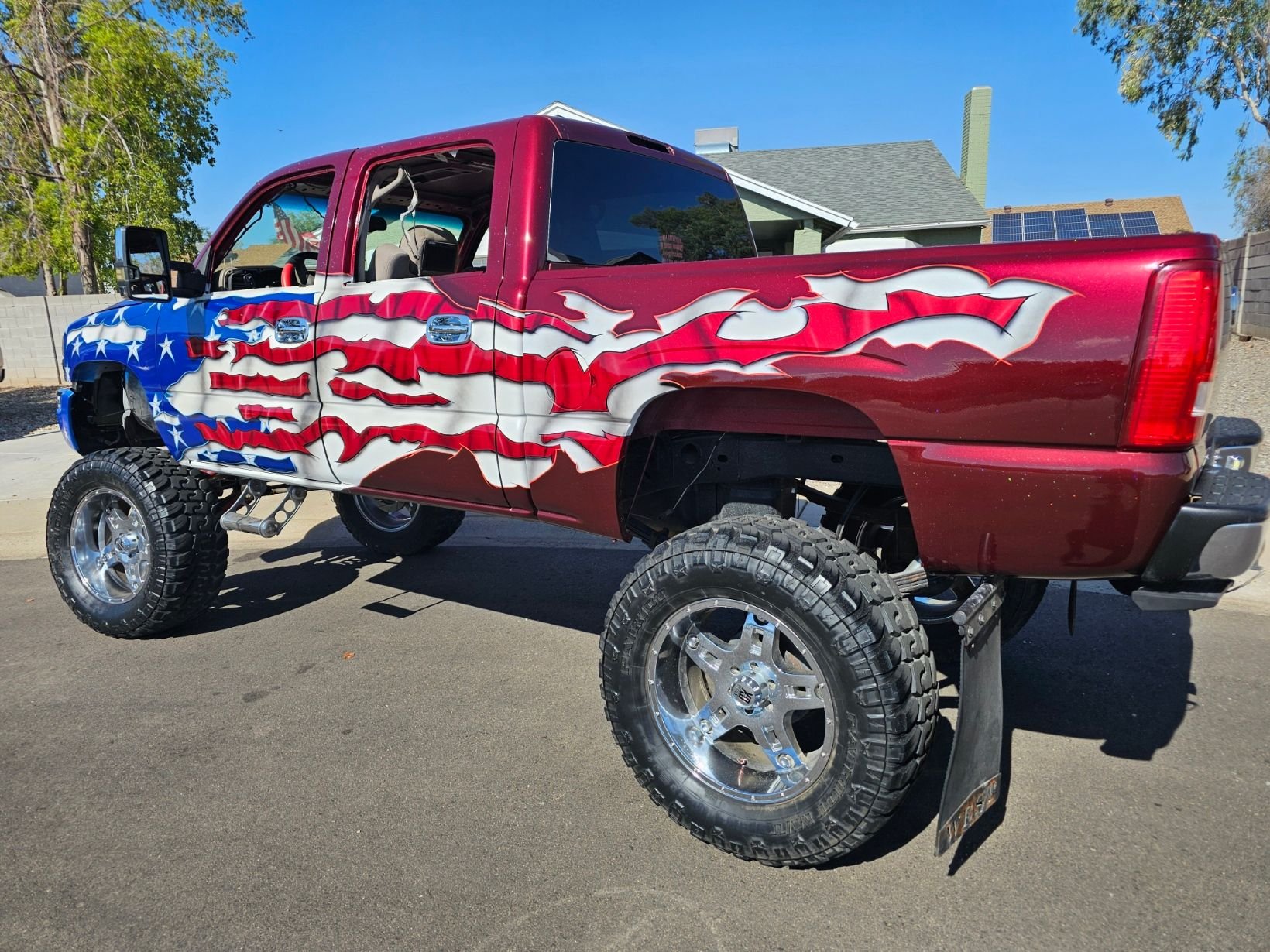

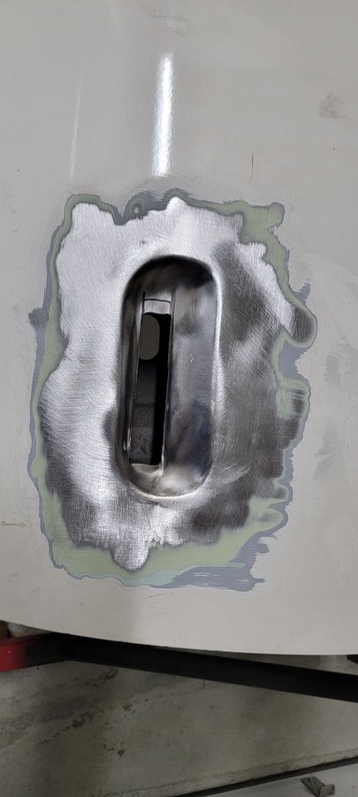

I run a custom shop and have shaved hundreds of items through out the years. In fact i have a car in the paint booth right now that i shaved the mirrors off of.
There is no reason to remove the pockets or indentions from the back side. you can if you want, but that usually leads to much more warpage in the adjacent panel. leaving the pocket/or dimple keeps the body panel sturdy while you do your welding.
In the end, only you knows it is there.
Almost everyone of my vehicles have shaved parts, handles, roll pans ect.
here is my Isuzu Hombre with a few parts shaved on it.

I cut out the recessed areas because I was installing the Kindigit handles in the location of the original handles. If you want to do a flush panel you could leave the indentations as bk2life mentioned simply weld patches over them. This would help minimize any warping, much like bead rolls stiffen a flat panel. Just my 2 cents.

Thanks for the advice bk2life! I will leave the dimples in place and weld panels over them. Then apply some rust encapsulator behind the work in that little pocket left over.

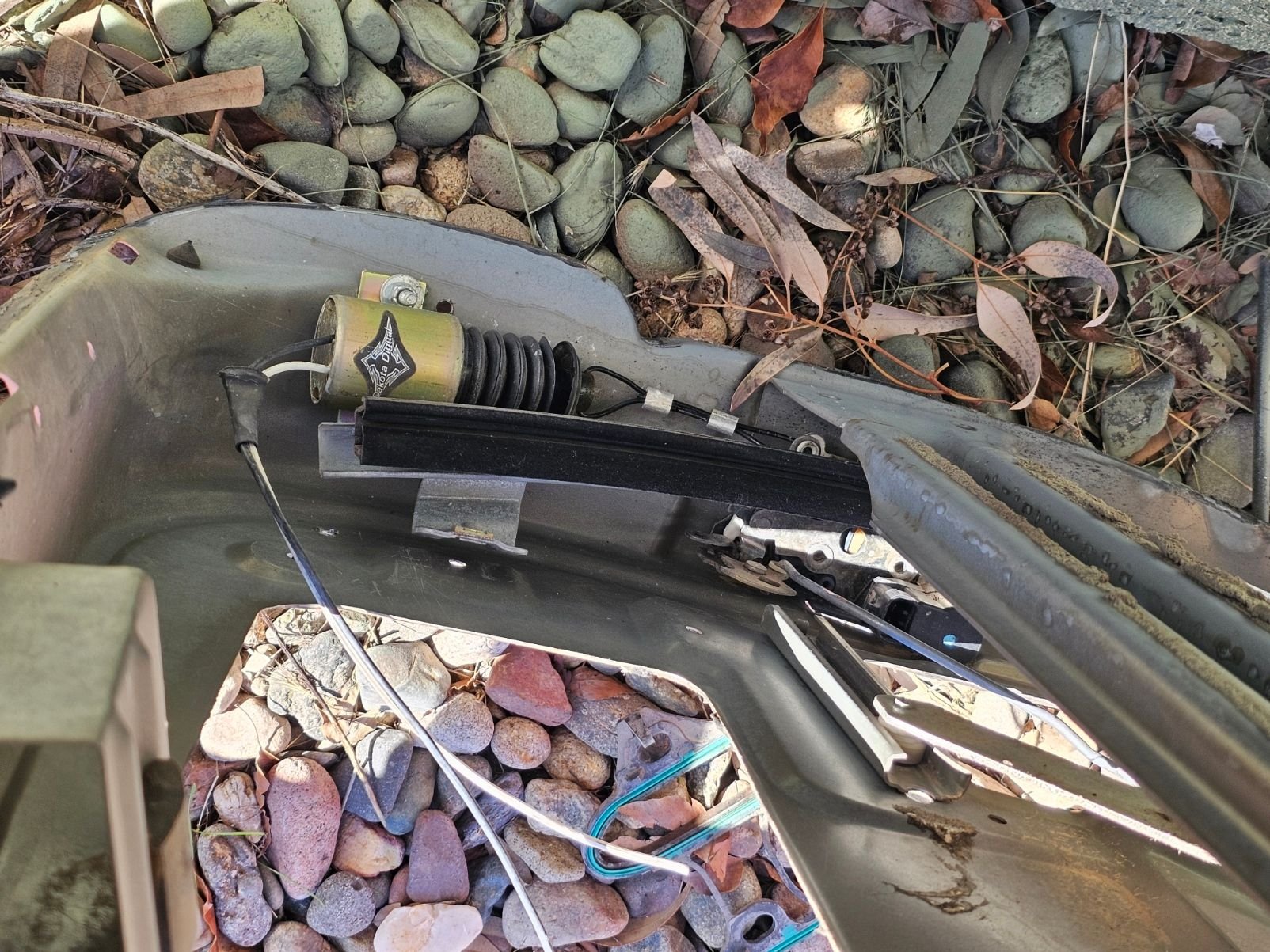

Now that I know you have shaved so many things. Do you have any tips on poppers, and actuators?
I have Dakota Digital electronics to control the solenoids. I have some old ebay 50lbs solenoids, but I don't think I will use them. I will stick with the Dakota Digital ecosystem and buy theirs. As well as their door poppers. Do you have any images of how you set up your solenoids and poppers? Really interested where the poppers tend to be placed. Or is it really different from application to application?
Sorry for all the questions, but one last one. Do you have a button over ride, for if the battery in the remote dies? I was thinking of hiding a waterproof button under the car someplace.

looks like the dennis was asking for input on how to accomplish shaving the door handles and not whether that would or wouldn't look good - which would be a pointless exercise because aesthetics are so subjective.
i have the same Kindigit handles as soloc4 and installed them the same way he did. the entire cup had to be removed to install them.
i would recommend leaving that area and welding a plate over it since that seems to be the easiest way to do it. i think you'll also want a hidden release in case the battery dies. or you can add remote battery terminal posts somewhere so you can connect a jump box and use the remote to open the door. i added remote terminals below the rear bumper since i relocated my battery to the PS spare tire area.

battmann - You are correct on what my intentions were with this thread. Thank you.
Remote battery terminals are a great idea. I too have my battery located just behind my PS wheel well.
My C7 vette has door buttons and if the battery dies they don't work of course.
The key fob has a physical key inside of it, and the car has a hidden lock next to the backup camera.
This allows access to the trunk. Once there, there is a pull cord sort of hidden in the carpet that opens the driver side door.
Battery is also in the trunk under some carpet.
I may go that route. Just copy what GM did on the C7.

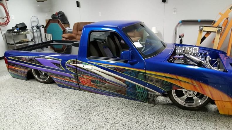

yes, ill chime in later im in the booth laying out some grphics on a scout ive been building.
you know, since im a " absolutely NOBODY important, self-important, hypocritical P.O.S." helping others by building their dreams
Im not just into 3rd gens, i have several other vehicles.
here is a few pics of the scout in the booth, and a couple others

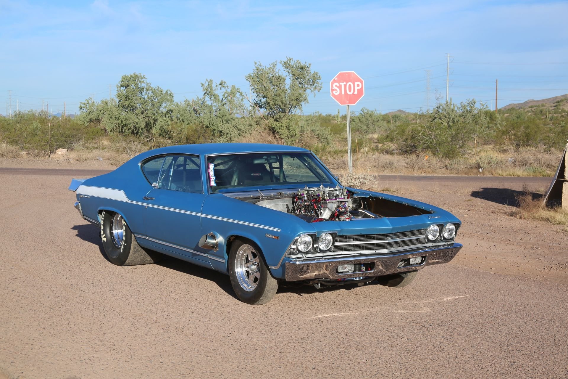

At my shop we do everything but axle and transmission work. We send those smelly things out for work.
The chevelle has fiberglass front end, stretched rear wheel wells. I have reshaped both and made them fit and work. The hood was cut, lifted, and rebuilt to cover the split dominators. That car is covered in a satin blue.
The details take time. Yes.

The picture will be abit hard to understand, but this is an S10 door shell with the door skin cut off. So you are looking through the door to the rear section where the latch is internally mounted. The popper is mounted low in the door jamb, the window does not interfere with it. The cable is connected to the popper and the other end has a hole drill into the latch mechanism and attached there. You should be able to do this same set up to a 3rd gen door with no interference with the window. I also suggest running the power and ground to the popper through the door jamb and mounting the ground inside the actual car. Some mount the ground to the door and then you are hoping for a good ground through the door hinges. I dont and never have trusted that. Now the fun part, i have a seperate down button on my keychain for each popper and each window.
So lets say your poppers are finicky and door wont open, roll down the window and open from inside. Then, as a fail safe you have the same for the passenger door.
Lastly if you have a dead battery, put a lug somewhere like show above.

​​​​​ Do you have any pics of where you installed them on cars?.
i posted a picture and a description above of where the popper is mounted inside an S10 door

Things have been slow going with it being so cold and the holidays taking up time. Only 12 degrees here this morning and 26 right now.
Garage isn't much warmer.
That being said, I decided to not bother taking the doors to a media blaster.
I tried two different places and neither seems interested in the job.
Actually fine with me, I like doing all my own work. So I bought a soda blaster gun and some media. Will be blasting the hinges area and any other hard to reach place myself.
Tonight I was planning on using my garage heater and stripping the paint off the door pockets to prep them for filler panels.
Not much of an update, but in the next month or so they should be all stripped and in primer.

100% would love to have some metal from a donor door. That curve has been worrying me.
I am in RI, what wouod it take to tet some panel material in the mail? (Enough for both doors, of course)
Old Dec 9, 2025 | 02:02 PM
Bald_eagle_machine's Avatar
iTrader: (8)
Joined: Jun 2014
Posts: 81
Likes: 47
From: Chiefland, FL
Car: 1988 Trans am GTA
Engine: L98 350 TPI
Axle/Gears: Factory 9 bolt w/disc brakes
Re: Shaving door handles advice for show car
Send me an image showing how much material you would need and we can work something out. I have cut sheetmetal for plenty of other members.

Posts: 4,506
Likes: 92
From: West Warwick RI, postal code: 02893
Car: Building LS3, T56 Z28
Engine: LS3
Axle/Gears: Moser/ 4.11
Think a peice from the door handle height are of the door that is 7" x 3" would do the trick.
I can do that. I can probably get a cutout done on thursday, and get it shipped out by Friday.
not sure why you would need this.
just grab a piece of sheetmetal from your stash and use it.
the 'curve' of the door is easily obtainable by using your hands to bend it.
Also, you dont need a piece that big, you only need the ovalish shape of the door handle pocket.
grind the area you are going to weld, and leave the rest of the paint alone for rust protection.
This is an hour job each door tops. (yes i know it will be a bit longer for you, but, you get the idea)
curved corners are easier to weld and will shrink more evenly.
I cut in excess, but here are the panels you need. Pm me and I can ship out tomorrow.

Hey guys, sorry for the delay in my response. I wasn't getting emails that posts were being made on this thread.
I don't plan to cut out that huge area. I will be doing a simple oval of the depressed area. I was oversizing in the pic to make my fellow TGO memebers cuts easier.
Can see the layers here. Thicker coat of filler than I was expecting. Think once the welding is done, the entire door will need a skim coat and a lot of blocking to get it smooth.
Cut out the base of the handle depression so I can paint the backside with rust encapsulator after the welding is complete.
Test fitting filler panel.
Seems to be laying flat enough, right?
Does this look flat enough to tack in place?
Thinking I might grind a tiny bit more off before welding. Not sure though.
Does this look flat enough to tack in place?.
looks great weld it already...lol
also i wouldnt have removed all that paint. just prepo the area you need to weld.
now all that bare metal has the chanve to rust.
i kow you said you were going to spry something in there, but it was all nice and painted before it didnt
need all what you have done.
but live and learn and move on.
on my ta im going to use different handles and shave the door lock hole.
i love shaved handles, but i dont think itll look right on my build.

I hear ya on the not removing all the paint, but I needed to cut the access hole and when welding I didn't want to be smelling burning primer/paint and guessing how far the heat effect was.
On top of that I also got the car painted 15 years ago by some tiny shop that is gone now. I don't have high confidence in the paint that is on there. Always seemed fragile, super easy to chip.
I want to get rid of as much of it as I can. Luckily it is 17*F outside right now so humidity in my garage is very very low. I am not worried about flash rust.
I will use the piece shown to make a copy for the PS and get it tacked up today/tomorrow. Then heat up the garage and spray some epoxy primer over the area to protect it as I figure out how to mount the door solenoid.
Since I will already have the 2K epoxy primer mixed up for the outer skin, maybe I will just brush some on the backside of the welded in patch. That stuff sticks very well and once fully cured is very hard.

Got around to welding in the patches last night.
Even with me trying to be as careful as possible, the panels warped. One worse than the other.
Forgot to take pictures last night, but will post in a few days when I work on the project again.
Think next steps are to strip the entire outer skin down to metal (gonna be a LOT of dust) and soda blast the hinges area then coat in 2K epoxy primer.
This will seal everything up and let me relax (no flash rust) and take stock of how I will tackle smoothing out the door metal as much as possible before skimming over with body filler.
Any thoughts/advice on this approach?

Post weld shrinkage happens. Typically you would hammer and dolly it, but getting a dolly in there is very difficult. Put a straight edge on the area and find out how much it has shrunk. A 2 X 4 and a mallet from the back can move a lot of metal quickly, but check progress frequently, then planish as needed. It’s not ideal, but if it’s a quarter of an inch or more short strand fiberglass filler can be used and is not porous like body filler and bonds incredibly well. From there it is just plain blocking. I will probably get a lot of hate from the true body guys over this advice, but it’s effective.

Thanks for the advice. I will first strip the door and then see what I am dealing with. It doesn't seem horrible.
I was welding tack welds for quite a while jumping around and from one door to the other to let the panel cool off.
I am no body guy but I will get the metal as smooth as I can before moving onto to short strand and then a skim of body filler.
I know there will be many hours of blocking in my future and that is to be expected.
Not going for SEMA show quality. This is a custom show car resto mod that I am building 100% by myself and I don't plan to build another one after this so there are of course limits to my skill and tools.
I think I can get a quality finish with some metal work, filler and patience.
I will post progress updates as I get to them. Not looking forward to stripping the entire door, but that is the next step.

My preliminary plan is to mount the Dakota Digital solenoids similar to how bk2life showed up on post 19.
Still playing with ideas of how I would mount it though. I want to come up with a bolt in/bolt out installation in the event of a warranty claim.
Might drill holes and weld in bolts facing inward so the door has internal studs, something like that.
Same goes for all the window regulator and lock actuator, no rivets all rivnuts and bolts.
From posts above it seems like the weatherstripping is enough to push the door open a bit to be able to grab it and open from there. So no additional spring loaded popper seems needed. Big plus.
My battery will be mounted over the right rear wheel, below my air tank for the air ride. I plan to have remote mounts under the car there.
Hidden button for the doors will be mounted into the floor pans someplace or on a bracket mounted to the SFCs I imagine.
All else fails, I can always crawl into the car via the hatch.
I have been dreading the job of stripping the doors down to metal due to how much dust it will make. Decided I will just use my full face mask and do it in the garage, put the vette outside.
Shouldn't take long with the surface conditioning tool. After that I will shoot some epoxy primer to seal the panel from rust.
Then I can metal worth the warped metal a bit to see how flat I can get it before moving onto filler to smooth out the lock and handle areas.
