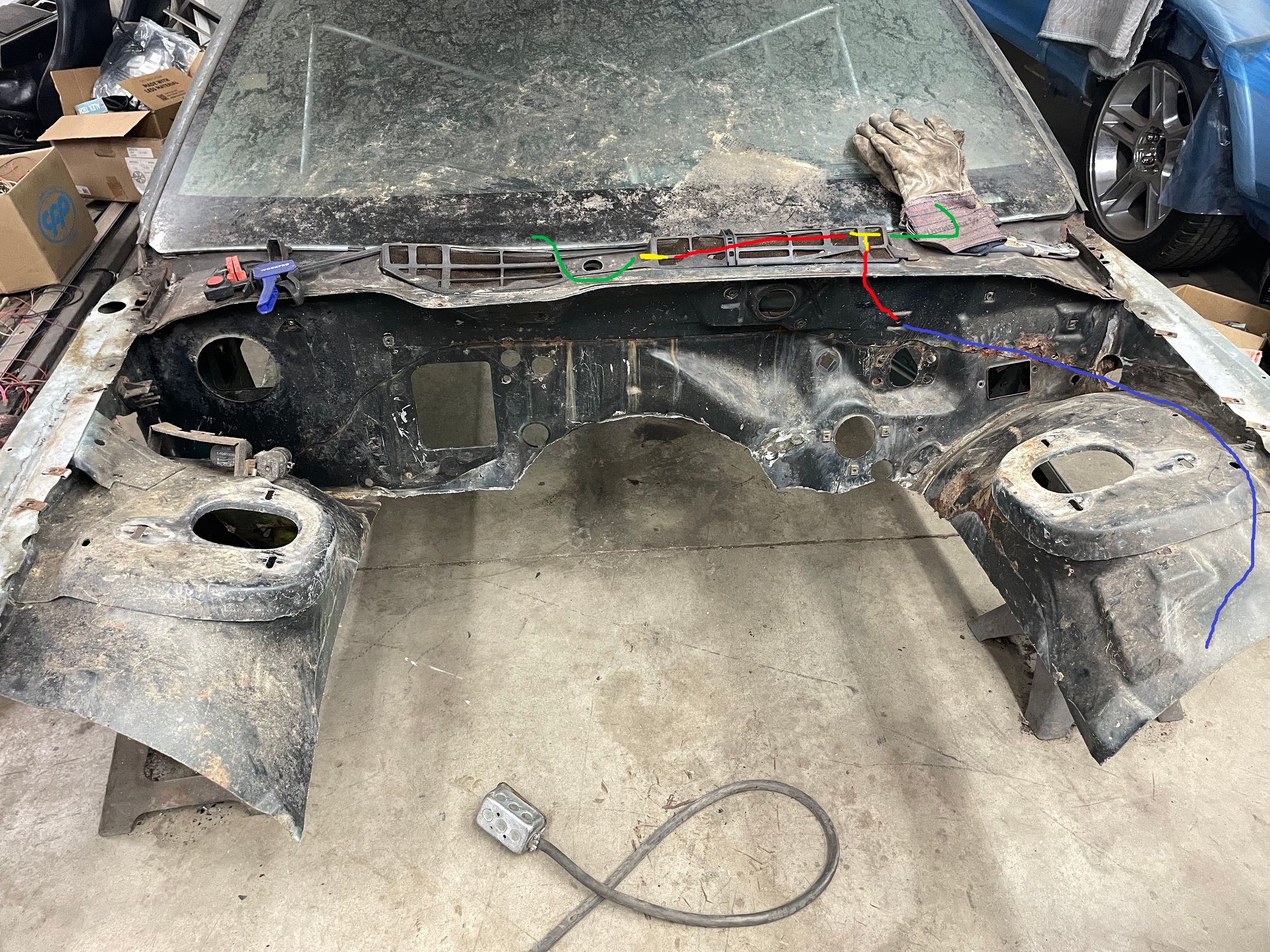

Hello
i was wondering if someone could send a pic of how their windshield washer tubing was routed up around the windshield
i cant figure it out
thank you

Forgive the filthy car and crude MS paint drawing but it should get the point across
Basic washer tubing from the pump to firewall - Blue
Pass through the firewall hole, same tubing - Red
Asymmetric tee. Two larger ports use std washer tubing, small port goes to the DR wiper - Yellow
From the tee to the PS wiper, std tubing - Red
PS wiper step down splice, small port towards the wiper arm - Yellow
Special small hose with sprayer that clips to the wiper arms - Green

That looks about right

thank you for the help!
