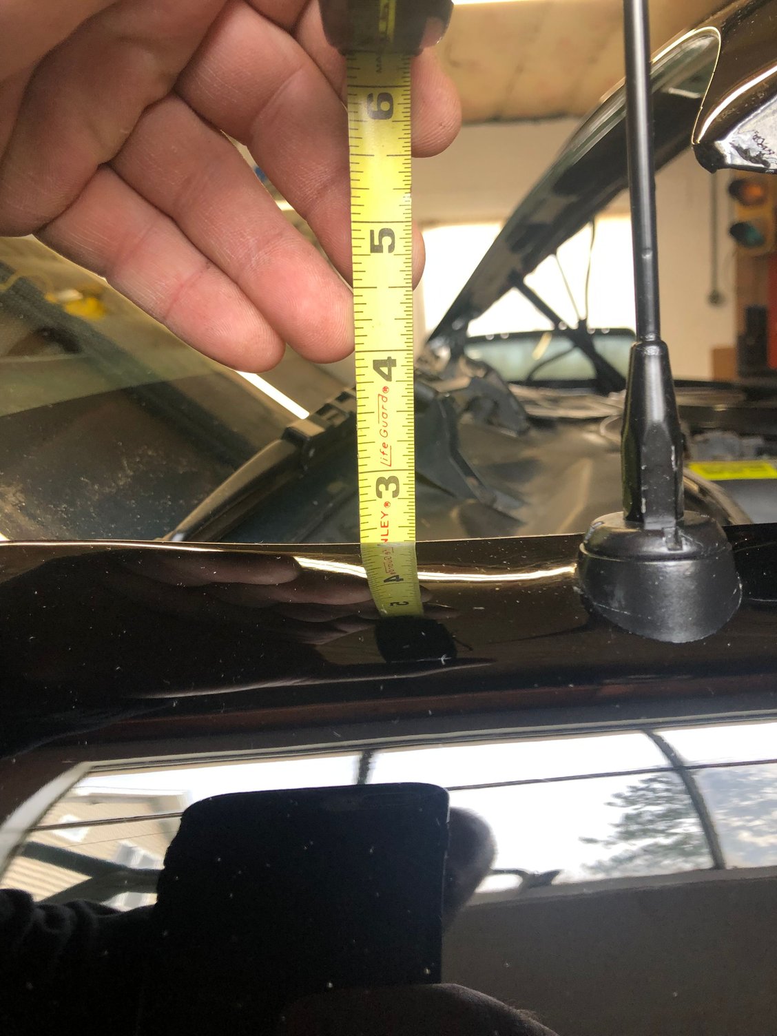

I took a measurement on my 1984 TA where you asked. Looks to be 2-3/8”. My fenders are factory.

Thank you kind sir!
Thats confirms what I was suspecting. My factory and aftermarket driverside fenders are 2-3/8 but the passengerside ones are just under 2-3/4. They dont line up with the door the same way either. Guess im drilling spot welds and adjusting.

So I drilled out the spot welds to about halfway down the fender and it dropped almost perfectly into place at 2-3/8". Alignment is much better however now the bracket on tye bottom where it bolts to the pinch rail needs to be reworked.
