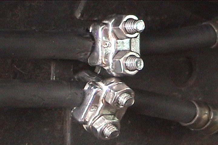

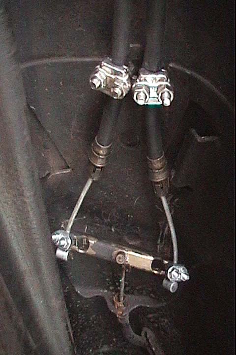

I've just finished swapping in LS1 rear brakes and I've noticed that alot of people were having issues hooking up the ebrake cables. Here's a simple solution, go to Home Depot and purchase some cables clamps and hook them up like it shows in the pictures. It worked like a charm.

my setup is similar to that also.
I know its not pretty. I want to get new e-brake cables. But at leasts its almost functional :P
Hey if it works, it works
