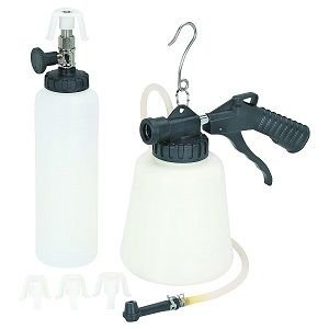

Would a pneumatic bleeder not evacuate all of the air?
I've had great success with mine. Complete system front to back including the master cylinder.
https://www.harborfreight.com/brake-...der-92924.html

How does this account for my getting a thoroughly bled system then? New master. Lines. Calipers.
Set up the pneumatic bleeder. Drained several bottles of brake fluid through the components.
Done.
Maybe I was just lucky?
For the record, I don't recall whether or not I pumped the brake pedal while the system was being flushed but I do know the results.

My experience is that dry lines make no difference in the bleeding process. Air isn't drawn back into the master on the release of the brake pedal.
(And if you've never tried a pneumatic bleeder, once you do, you'll never go back to the traditional method. My 2 cents.)

Ah, there is the key, they pull a vacuum first. Now that makes sense. Get rid of the air before adding the fluid. I like it!
Not only is the M/C an issue, but prop or combo valves can also hold air. Last car I did was a bunch of new lines, added a prop valve, entire system was empty. Bench bled the M/C but had a heck of a time getting the air out of other system parts.
RBob.
Old Mar 21, 2018 | 04:27 PM
Twin_Turbo's Avatar
iTrader: (25)
Joined: Jun 2000
Posts: 5,364
Likes: 51
From: Enschede, Netherlands
Re: Do you have to bench bleed the master?
That's why I said... crack the bleeders and use a vac can in the 4 corners to pull fluid in and only start pumping the oedal for that last bit if firmness.
Old Mar 21, 2018 | 05:29 PM
Posts: 28,014
Likes: 2,492
You HAVE TO evacuate the ENTIRE MC in the process; GOTTA get the air out of those corners that are ABOVE the line fittings. That's why a vacuum bleeder system, where the vac is applied at the bleeder screws, CANNOT work; unless it pulls the system down to near deep-space level through them, WITH A CAP ON, and then fluid is introduced perhaps through a petcock sort of arrangement at the top, or through 4 such at the bleeders.
But ONE WAY OR ANOTHER, the air MUST be removed ENTIRELY from the MC, before fluid is added.
