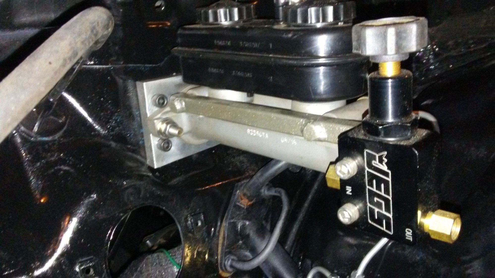

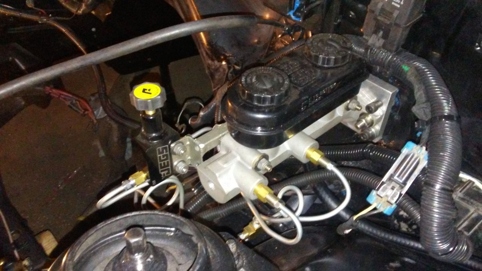

S-10 master
Call Dave, Tell him you want an S-10 (84-88) manual brake master cylinder with his install kit. I used his kit but had issues with Chrysler master leaking. Switched to the S-10 and no leaks.
https://www.manualbrakes.com/3rd-gen--82--92.html
