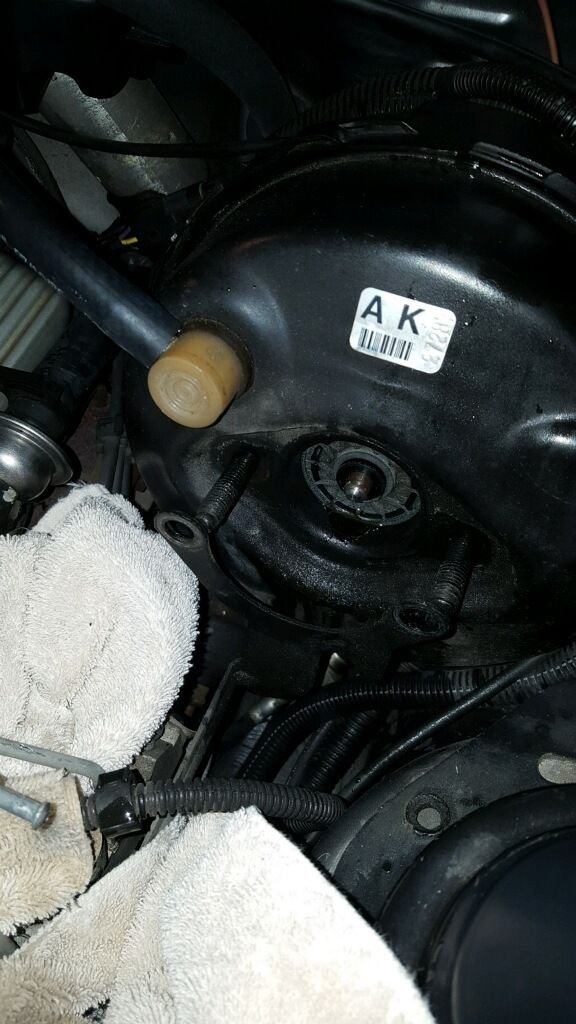

Thanks Drew. I took the MC off and I see this fluid on the booster. Is it likely that fluid has entered the booster and I need to replace it? Or does this appear like something else?

And I am assuming the MC needs to be replaced ?

Depends on if the fluid overflowed from the back of the reservoir, or if it leaked past the O-rings. It's easy enough to not get the cap snapped down all the way, then you'll get overflow. If the seals on the piston leak, it'll run out the back like that. Assuming it's the original aluminum master cylinder, a fresh set of seals might take care of it. I wouldn't think it'd hurt the booster, it's just steel and rubber. Clean the fluid off the booster before it eats the paint and it should be fine. If the paint is already lifted, clean it well and touch it up to prevent rust.
