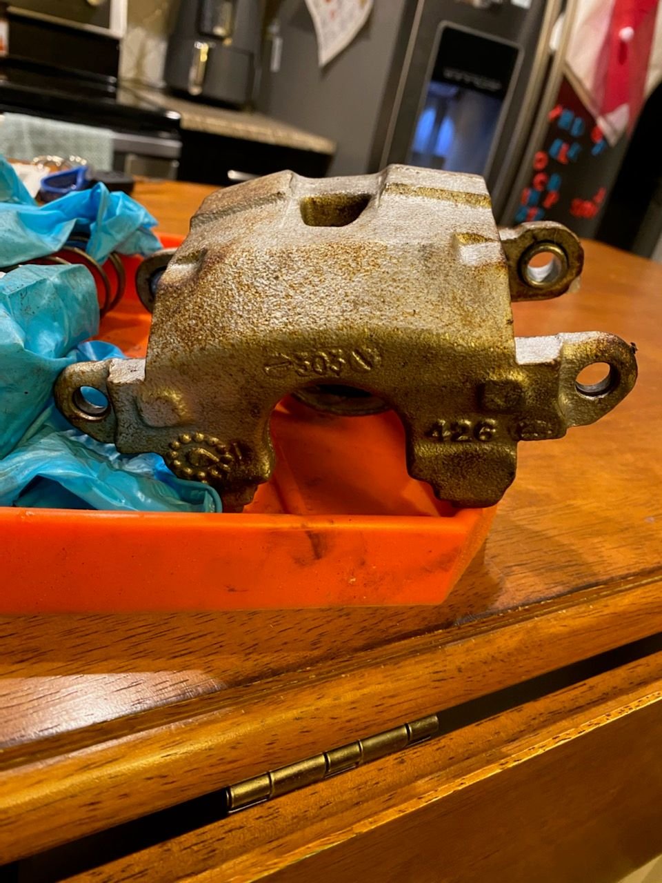

Cardone told me if I send in my aluminum PBR calipers from my 89 there was an "80% chance" they could rebuild them. I recently got a reman DS full aluminum caliper from them and I noticed the aluminum caliper was not a core ie it did not have cast with the Australian PBR logo and such, there was no marking on it at all. Someone made new cast aluminum calipers for a while...
The Wagner rebuild kit from Australia is long gone. I've been watching for full rebuild kits for a couple years now. Only the rubbers seem to be available any more. heh-heh he said "rubbers."
The PS rear caliper seems to be gone also.
