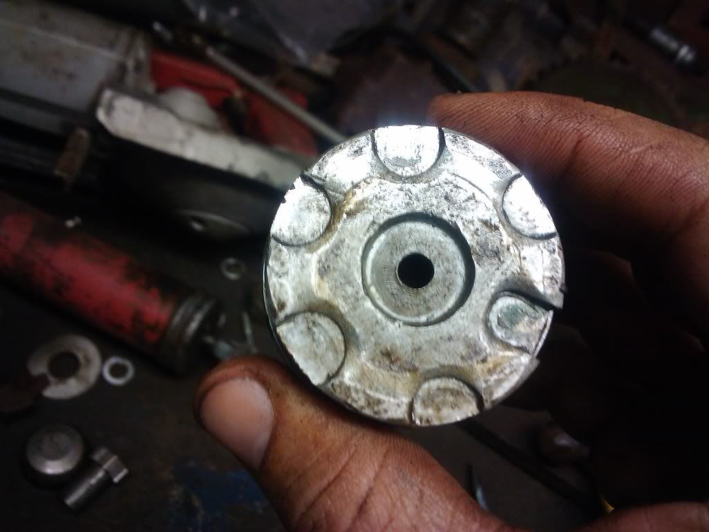

Bleeder loose then they should spin 'relatively' easily. I used the tip of a pliers in the grooves and turned. Your caliper piston looks like this, correct?

Yes that is it!

Well dumbass award goes to me! I was afraid to turn those cylinders as they would not spin as easy as advised but grabbed the channel locks and viola, they moved in enough to get them on.
