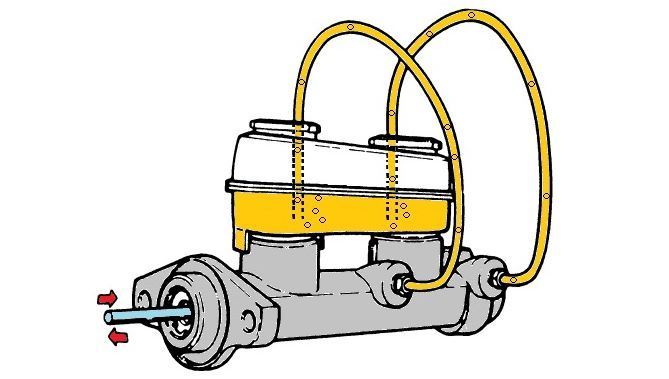

No. I did it still in the car using plastic fittings which screw into the master cylinder on one side and on the other have a rubber tube that I put back into the reservoir. Kind of like this:
Is there a difference between this and a regular bench bleed? If so, what is the procedure for a bench bleed? At that point, does it make sense to just replace the MC given that it is near 40 years old?

The master cylinder is tilted nose up in the car. I think the reason for bench bleed is because an air pocket is captured in the front of the master cylinder if done in car. Leveling the master cylinder (off the car) allows that air pocket to escape. Procedure is same as shown in your graphic.
You want to avoid over stroking the cylinder as it has a chance of damaging the o-ring if bore is not uniform.
Fill master cylinder with fluid after re-installing and then open the brake bleeders. Gravity alone will do much of the work for you. Not everybody has to do this next step, but I also purge air from high in the system by cracking the fittings at master cylinder while someone is placing constant pressure on brake peddle. Seems I just can't push that air out any other way (but I don't have stock lines either).
