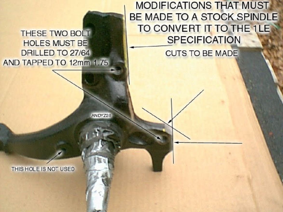

Are the mods the same for 1LE? If so, from Andyz28 CD. Hope he doesnt mind.

@ANDYZ28
Old Jan 16, 2026 | 07:55 PM
84 1LE's Avatar
Joined: Nov 2002
Posts: 6,668
Likes: 414
From: Oyth
Car: 89RS vert
Engine: Erod
Transmission: 4L65e
Axle/Gears: BW, 3.27
Re: Spindle Modification request
Yep, thats the guy. I have an old CD of his i bought back in the day.
