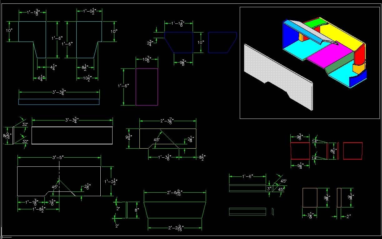

hey i was just wondering if any of you guys knew the dimensions of the custom sub box that they sell that fits perfectly in the trunk... i would like to make my own in stead of buying one and i just wanna see if any one has a diagram on how to make one.. or can just help me out with the sizes .... thanx alot

This will give you an idea of it. I tried searching about to find the link to the post but I couldn't I've just been saving all the pictures I may use the future for refrence since I just bought a new 160 GB HDD.

Forgot to add you may have to modify that to get the air space required but that will give you a good idea on what to base your lower box off of... Course I recommend you go back and check all the measurements yourself before building the box, because I have never attempted to use those blue prints.

They're all inside of this:

thanx .. i noticed that there is like 400 posts on this topic... but before i posted i couldnt find **** any where about it on the site.... i dont no why....?? yea well thanx for the dimensions ... its gonna help out alot this summer
