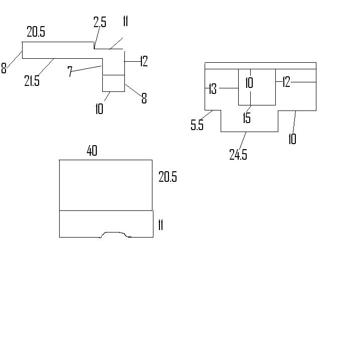

2 15s ported
so i finally got my box done that fits behind the back seats and is ported for 2 15s it is 5.19 cu. ft and ported at 34 hz measurements don't account for the material but that is easy u will have to do some adjustments as i talored this to my car and some of the plastic is bent and the carpet is wrinkled so u could possible make it better

Neat, but I woulda made the 11" rear lower deck at an angle, up to the top deck, instead of the lower being flat & a 2.5" step up.
I woulda made the air flow between the upper & lower areas better & still be functional for mounting an amp or whatever, if you wanted to mount one there.
But it is your car & your box. Only you hafta be happy with it. I was just thinking out loud.

Your missing the dimensions in your lower diagram for the hatch latch notch. And what perspective is the upper right pic?
it's looking at the box from behind (like standing behind the car and looking through the taillights and liscense plate)
i couldnt angle it it almost touches the hatch as it is i had to do it that way cuz it was the only way but ya i wish i coulda mounted the amp there just not enough space
