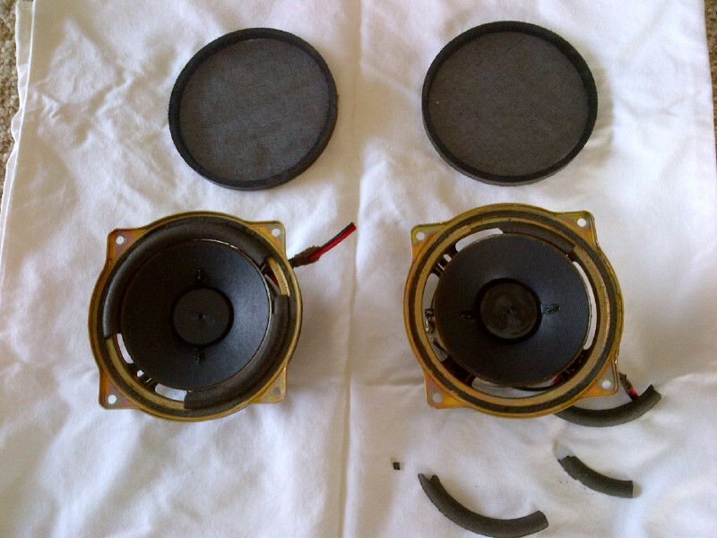

The factory 4" subs are trashed and I was wanting a replacement. Should I just run a 6x9 and remove the subs?

If the coils and cones are still good in your subs, but the foam edge around the paper cone is shot (normal), they can be rebuilt. Mantaguy turned me on to this idea. Here are a few places that offer the service.
http://heavysoundco.com/oldcarradiospeakers.html
http://www.nostalgiasounds.com/radio/speaker.html
This recent thread has a little info and some photos of an aftermarket alternative.
http://www.gtasourcepage.com/forum/s...ad.php?t=54910

I used these guys and re-foamed my surround for about $10.00. Sounds good as new.
http://www.speakerworks.com/speaker_..._kits_s/65.htm
SURROUND KITS
OLD SURROUNDS TOAST
NEW FOAM GLUE. GLUE DRIES CLEAR
