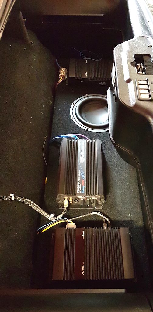

I just finished this relatively small box with one 8" sub to drop in the well. It can be removed very easily, leaves a fair amount of space still in the well and sounds really good.

Neatly done, pwessels.
