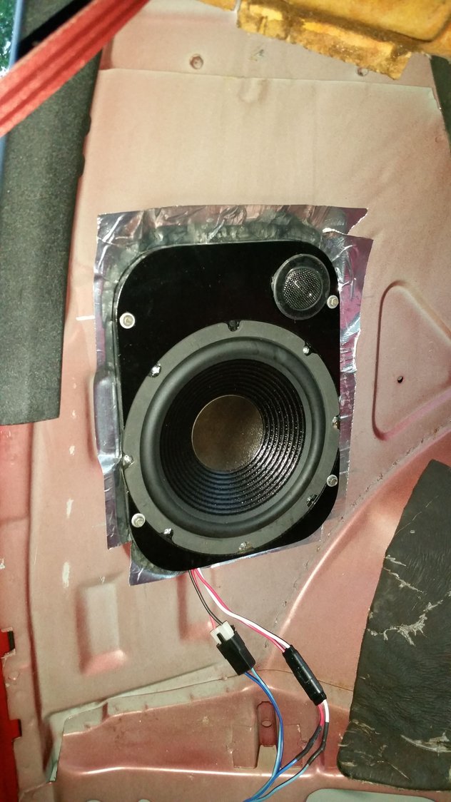

I had some Polk Audio DXi460s 4x6" in the dash, some of the best sounding reasonably priced speakers I've heard in that size range, but the cones disintegrated in less than 2 years.
I decided to grab the 5.25" sony xplode speakers that were in the rear sub boxes and mount them up there. They're nothing special, they're ugly and sound a little bright but are otherwise OK:
Covering them up with speaker grills will likely help both the bright sound and covering up the obnoxious color.

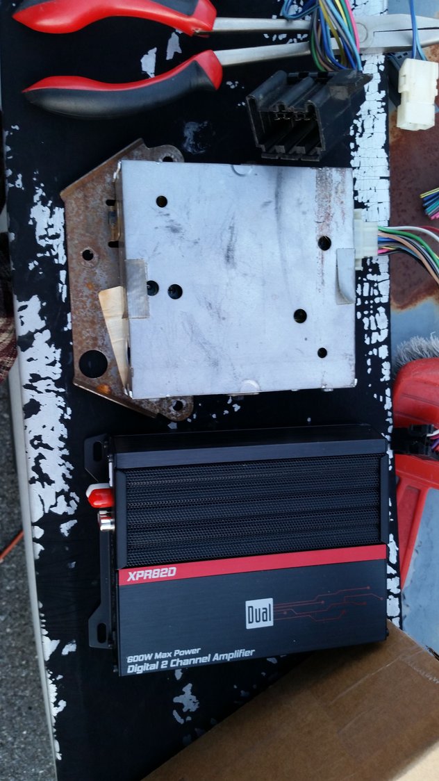

I did a little digging and the sub amp proved pretty easy. After seeing this video and some glowing reviews I decided to set aside my prejudice against Dual and stuff bought at Wallmart in general and invested my $59:
It's really a nice little amp. Way overbuilt. Probably nicer than anything you could have bought for sub $150-200 5-10 years ago. The interesting thing is that it puts out just enough power that with the eq/gain settings just right I could just cause the cones in the subs to bottom, but most settings you still run out of amp slightly before running out of speaker. All in all, it's a good match. I ran 8awg power and ground, a fuse, some RCA's, and figured out that you could wedge it into the stock sub amp space in the dash:
Next to the original GM sub amp. If you include the bracket they are surprisingly close in size
Location for the original sub amp, it's tight but there's enough room there for everything and it doesn't overheat.
The 8awg wiring, RCA's, the speaker wiring part of the original harness... all tuck under the dash trim panel.

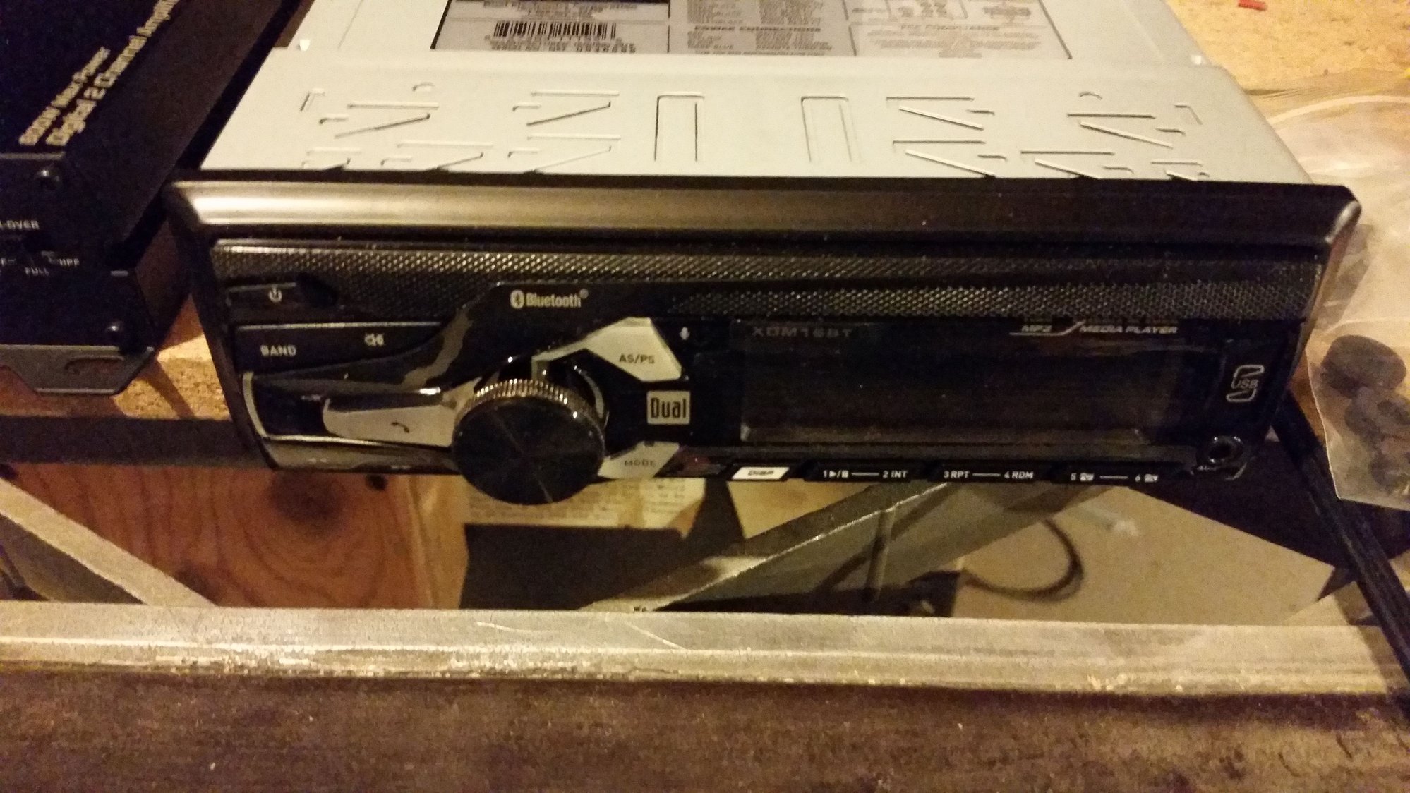

So first try on the head unit I decided, "The amp is a smoking deal, they have a head unit that gets good reviews... huh, maybe it's worth a try." Well that and it was $15 at wallmart (buy it online with in-store pickup, $20 if you just buy it)
I made a nice wiring harness for it (soldered and heat shrunk).
Initially, I was mostly thrilled with it, great sound, adjustable enough, I liked the tweeters as the rear channel, it filled in the stereo image and evened things out. It had a suprising amount of contol over your digital sources, but I did notice a few things that weren't perfect (but come on, $15):
  • the blue lighting was obnoxious/bright, and the blue lighting and white display don't match anything in the car
  • it wasn't as flexible in configuration as the Pioneer, but i think that as like a $200 head unit when I bought it years ago
  • there was no SD card slot. Only radio, BT, USB
  • radio reception was sketchy, but some of that was my antenna delete and amplified antenna setup in the car (you can see it under the amp in a few of the pics), but I ran the antenna to the rear defroster making it marginally better but still pretty bad
  • When playing from USB you lost the first couple of seconds from the track. I didn't notice it right away till something that I liked the beginning of came on and I couldn't hear the first note no matter what I did
  • Finally, and this is what got me to keep looking, on the first really hot 90* day the screen went blank and it stopped playing till you reset it a few times and when you did all your settings were gone. I'm not _positive_ that this was the head unit. I've had this happen 2 or 3 times with the Pioneer, but it was 2 or 3 times in the span of 5-10 years where it just lost all of it's settings, but it wasn't 3x in 15 minutes. I'm not really positive what is going on here (and don't really have any ideas what to look for)

So I think we have a winner, at least after about a day and a half of tinkering.
It came in this box:
I noticed that it was labeled a lithium battery after I took the picture. The weird thing is that it's the correct box, the foam packaging fits perfectly inside it.
I ended up making another plug-in harness for it, here's a pic of what I mean when I say I make a nice harness for it, the left is the one for this head unit that has ISO plugs on it, the right is the Dual one, the one in the middle was the last unit from Amazon. I also have one sitting around wired to a Pioneer plug. FWIW, all soldered and heat shrunk with marine (glue lined) heat shrink, and I've worked out a pattern that I follow for the turn-on lead (I add a Y to each accessory, I put a female spade on the head unit side and male on the harness side, so I can keep piggybacking as much stuff as I want).
I plug it into the car and I notice an immediate problem- the left-hand channels are reversed, if you balance to the F it balances to the R and vice versa. So the F/R control actually controls diagonally.
WTF??? Seriously???
I check all my wiring (it's all color-coded, it's hard to screw up). I check to make sure that they followed the normal color standard, they did according to the diagram, I check the order of the pins in the connector...
This thing is really wired wrong, from the factory. WTF? Again??? (the last one was worse)
I open it up:
Well there is no way that some idiot monkey miss-wired it, the socket drops into the board only one way. So this thing is actually designed wrong, at least it doesn't match their documentation, supplied harness and the standard speaker pinouts. ARGH!!!
I ended up re-pinning their connectors so it was connected correctly. This is REALLY a ridiculous thing to have to do.
Anyway, if you guys have never seen inside one of these mechless units this is what they look like. Really not much inside it.
I didn't like the inductor and capacitors are just held on with their leads so I added a glob of glue to them all to keep them from breaking from vibration (no pic of that, you can use your imagination).
if anyone cares this is what it looks like in the dash. I made myself a custom aluminum faceplate/bracket (it uses the side screw holes to hold the radio in instead of those bendy cages), at one point it had a pioneer head unit in it that used an expansion interface to add an AUX IN and used RCA's for input, the reason for the 2 holes under the head unit.
Set to red it really matches pretty well. The pic is deceptive, it's actually very slightly redder than the rest of the lighting wherein the pic it looks lighter.
BTW, my SHO has "courtesy lighting" that lights up the floors with colored lighting with the lights on/running that I really like, so I grabbed an extra LED strip, tucked it under the dash and wired it into the dash dimming circuit and I have basically the same that dimms with the dash lighting.
I LOVE IT! It's funny how things like this can make you stupid happy when they are really almost totally unnecessary. Goes great with my porno red interior. Bom chicka wow wow
So far, Pros:
- Lots of different color choices
- Sounds good, very close to the Dual with some quick guess settings, I think I could get it to sound as good with a little tweaking. Honestly if I never get it any better then this I'll be fine with it. It sounds like a decent modern factory sound system (like my SHO has a very nice setup as part of the Synch system) that someone added a small sub. Just enough bass to feel, and loud enough that i can hear the music with the windows down and the cutout open and no interior in the back half of the car. I'd bet that it would sound GREAT for a sub $100 system in a quieter car, like I suspect that it's actually MUCH better then the SHO system but that car is really pretty quiet inside.
- the USB, BT... seems to work well, I haven't tried the SD or remote yet
- it actually has a MUCH more workable FM tuner, like as in using the rear defroster grid as an antenna it works better than the old Pioneer and the factory one in my Cummins. It took A LOT of screwing around to figure out how to set the presets :/
Cons:
- The volume **** is slippery and the only piece of chrome on the radio and my interior. I'm going to have to do something about it, I wonder how hard it is to pop it off without breaking something, they could have at least put a texture on it.
- stupid bar graph display, I think it might actually be random, not displaying the music. Why bother? I'll add the stupid logo here.
- the retarded factory wiring. Really, you couldn't get the wiring to match your wiring diagrams and the standard colors???
