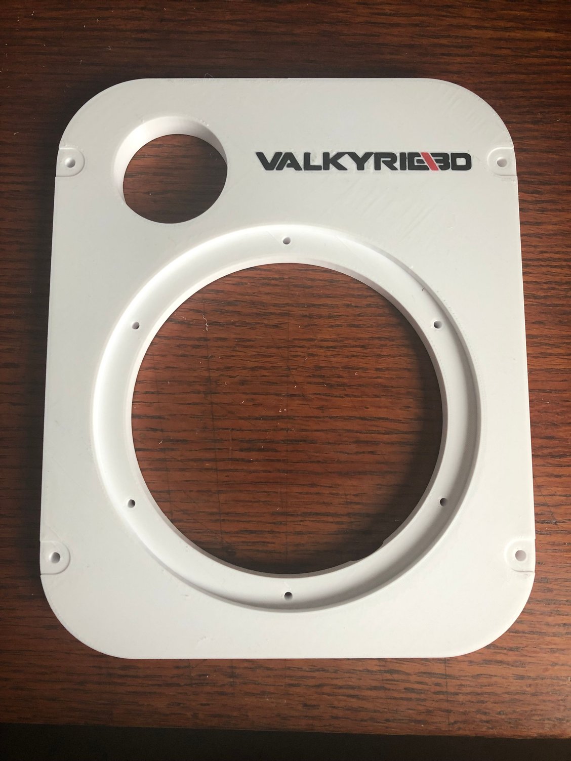

I have 6.5 diamond audio components in the sail panels and i'd recommend it over the stock 6x9's if you have a good amp to drive them. I 3D print fitted/recessed mounting plates for people up here in Canada that make the jump.

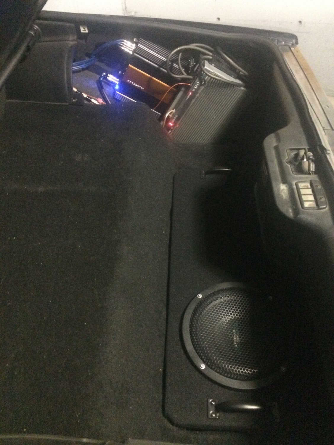

For comparison, I put in a single sealed box 10" sub with a 1000w Class A amp. The front components (4x passive tweeter and 4x woofers) are powered by a second 4 channel Class A/B with 180w RMS per channel. The sound is phenomenal, and it hits hard enough for the SQ setup i was going for. Everything is hidden, but it took me some work to get it that way. These cars can deliver great sound if you put some thought into it.

Quote: I have 6.5 diamond audio components in the sail panels and i'd recommend it over the stock 6x9's if you have a good amp to drive them. I 3D print fitted/recessed mounting plates for people up here in Canada that make the jump.
You might lose a bit of the midbass from the smaller speaker size, but you more than make it up in sound quality with a good component set. Adding a small sub in the back (or large if you hate breathing lol) rounds out the rest of the system. These cars can be great platforms when you take the speakers out of the dashpad.
Those plates are really cool. Could you print a set of those without the holes in them and sell them?

Quote: Those plates are really cool. Could you print a set of those without the holes in them and sell them?
Thanks. I'm actually working on the last design revision before selling them commercially, however, I've already made up a few sets for people in my area that couldn't wait. They'll be available in either black or white.
What do you mean about removing the holes though? The speaker holes themselves?

Quote: Thanks. I'm actually working on the last design revision before selling them commercially, however, I've already made up a few sets for people in my area that couldn't wait. They'll be available in either black or white.
Yes, without the speaker holes, so I could cut what ever I wanted into them, for 6x9s or something
