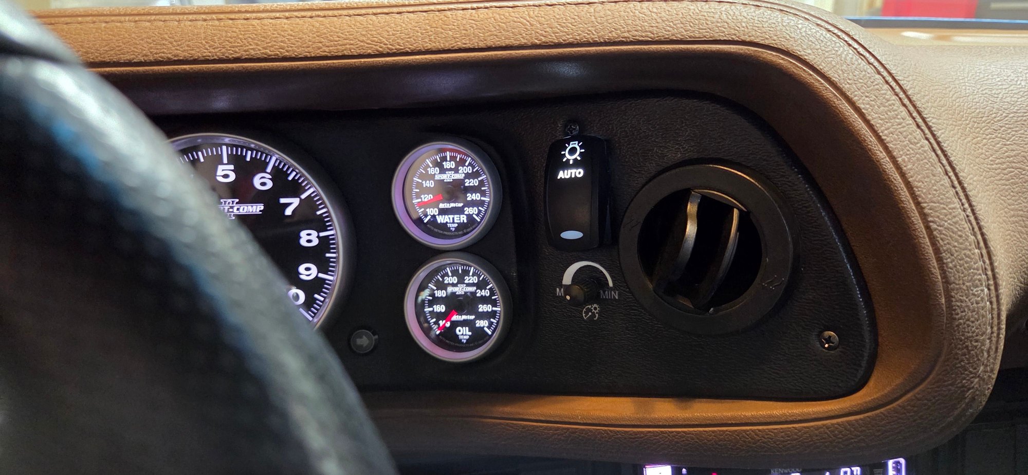

Just wire one of these up in parallel with your existing headlight switch.
https://www.amazon.com/aqxreight-Automatic-Headlight-Universal-Modification/dp/B0C7444WLY/ref=mp_s_a_1_5?crid=33D4RUH4V3D1Q&dib=eyJ2IjoiMSJ9.W_c4GOXrxOgJNe4Hef79tBP9CA2TtvO21cdoF23xsRUS5YKth-_C5Rk61oarIgyGebZr1D8wtTlAz2QBGUQGahHq7MC5u6Ic3xz3G66g5sp3jBNwSwhUx6uZ7_cedePn1RixCguDHR0nkael9DWBo4wOo9fkLjEGZyRxACFIgiG6xQLKqIKFcNm4ia4viIYszv-RVBELh7_bBTI-9hYsUw.2D8wo5PPNE_GYafDDdMTmnXxa8PsdL0_AQdUy-PBYzc&dib_tag=se&keywords=automatic+headlight+sensor+kit&qid=1777080642&sbo=RZvfv%2F%2FHxDF%2BO5021pAnSA%3D%3D&sprefix=automatic+headli%2Caps%2C207&sr=8-5

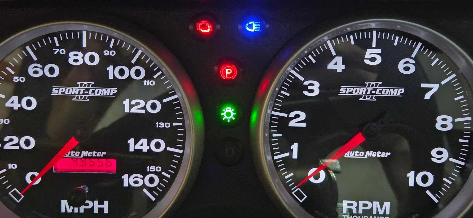

I took a step further and put in a custom switch from Rocker Switch Pros thst will deactivate the automatic module if I don't want the headlights on. Also put in an indicator light that illumates when the headlights turn on.
