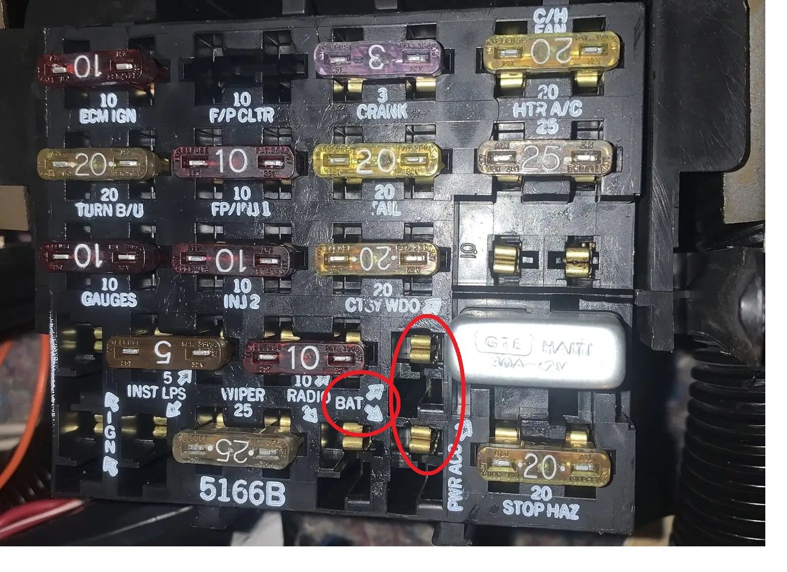

The variety of different IPBEC (Instrument Panel Bussed Electrical Center) / Fuse Panels that are used in our Third-Gens typically have a couple of
Power Distribution Slots/ Power-Taps populated with Female Pack-Con III Terminals marked: "BAT", that will accept a Mating Male Terminal.
Shown in the Image below, circled in RED:
The "BAT" identification does NOT actually mean that a Direct Battery connection is present,
but in actuality it means that the corresponding Circuit is always Active/ ON.
Power in the above locations is provided through the 20A Power Accessory Fuse/ 20A Courtesy Fuse within the IPBEC.
The Circuit is as follows:
-Ground through the Negative Battery Cable from the Negative Battery Terminal to Engine Cylinder Block.
-Positive Battery Terminal via Positive Battery Cable to Starter Motor Solenoid.
-Starter Motor Solenoid via Fusible-Link and 10AWG Cable to the C100 Firewall Bulkhead Connector.
-C100 Firewall Bulkhead Connector to the IPBEC 20A Fuse/ Buss-Rail and "BAT" Power Distribution Slots.

Not completely sure about this "from the starter" business you keep speaking of... although as you can clearly see from vorteciroc's piece of a schematic, The Big Red Wire that you have found on your fusebox, is fed from one of the fusible links that connect to the battery at the big starter terminal. The Big Red Wire under the hood, wire #2 along the left side of the diagram up there, goes from that FL, to C100 (the big pass-through under the brake booster), then on the interior side of the firewall, meets a splice, from where it goes to several places, including the fusebox.
Also not completely sure what you're trying to "wire". If you have the fuesbox with a Big Red Wire on the back of it at/near the tail light fuse, then you've found what you need. All you have to do is hook the car back up: connect the fusible link at the starter, plug C100 back in, and you're done.
I notice that on that schematic, the Stop/Hazard fuse is not shown. Seems a bit mysterious to me butt w/e, what do I know anyway. You can see the fuse for it in his photo of a fusebox, with one of its terminals right there next to the other battery-fed loads, such that the metal strip thing with the Big Red Wire crimped to it, can connect to all of those fuses, within a short distance.
You can't power the car by plugging power INTO the fusebox somehow, if that's what you're trying to do. That's backwards. ALL power would then be forced to flow backwards through whichever one of those fuses, probably the ACC or CTSY one (the photo he posted doesn't have CTSY butt most do), which the fuse will simply blow when you try to use everything.

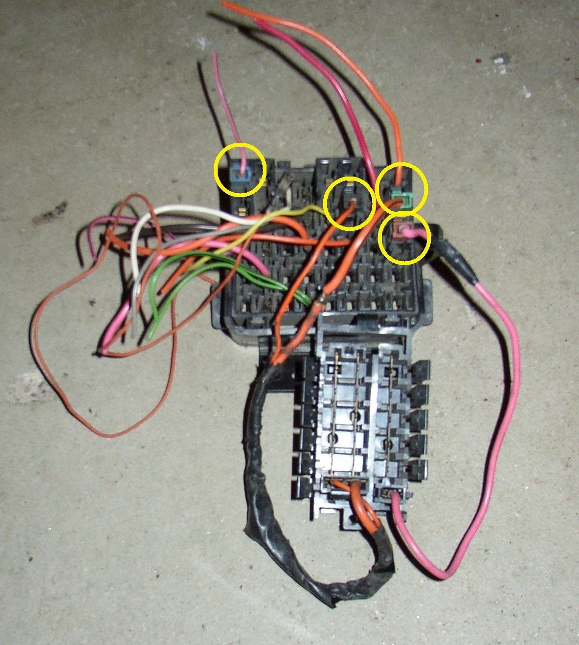

Many of our Cars have an IPBEC Design with Connectors on the backside of the Panel.
Below an Image shows the backside of an IPBEC with some of these Colored Connectors installed; circled in Yellow:
Those Connectors are considered the Power Inputs for the various Buss-Rails within the Panel.

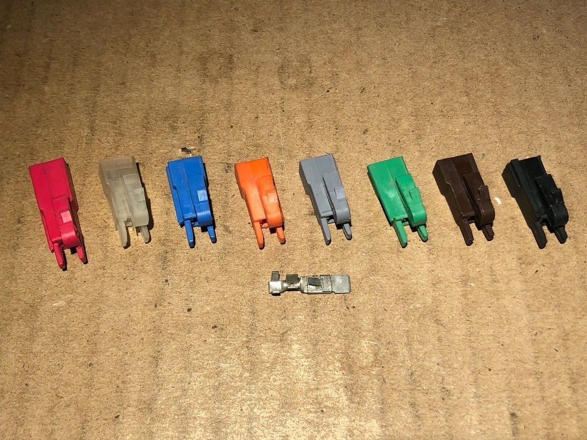

They are single Male Pack-Con Connectors, shown below:
