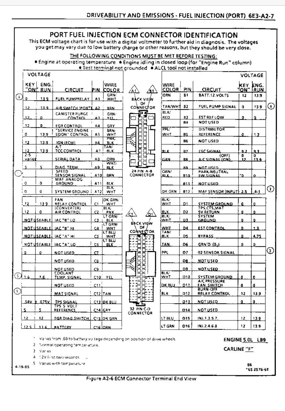

check ecm
A6 for power key on and cranking

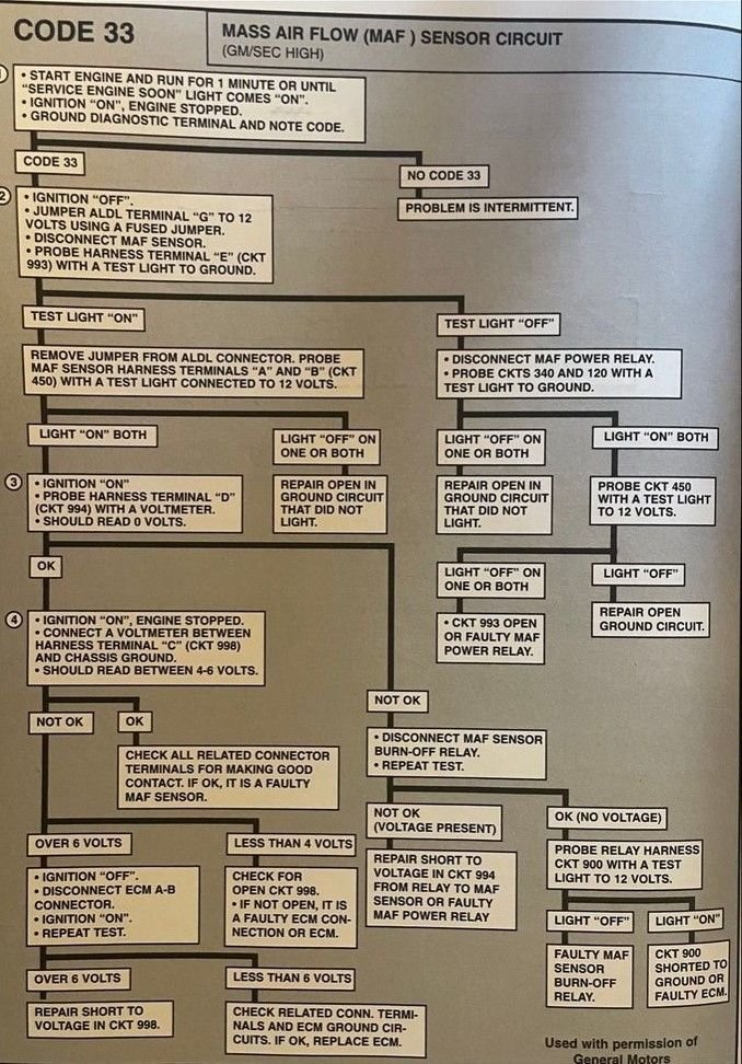

I have a new problem and an new question. I have a code 33. It is hard to start and runs like crap to the point that it don't want to idle. I can unplug the MAF and there are no change. do you think it is the MAF or a relay or are there a way to find out for sure, I know there a lot of things that will cause a code 33

Awesome, the first step is power to D at the fp relay. See schematic and test process

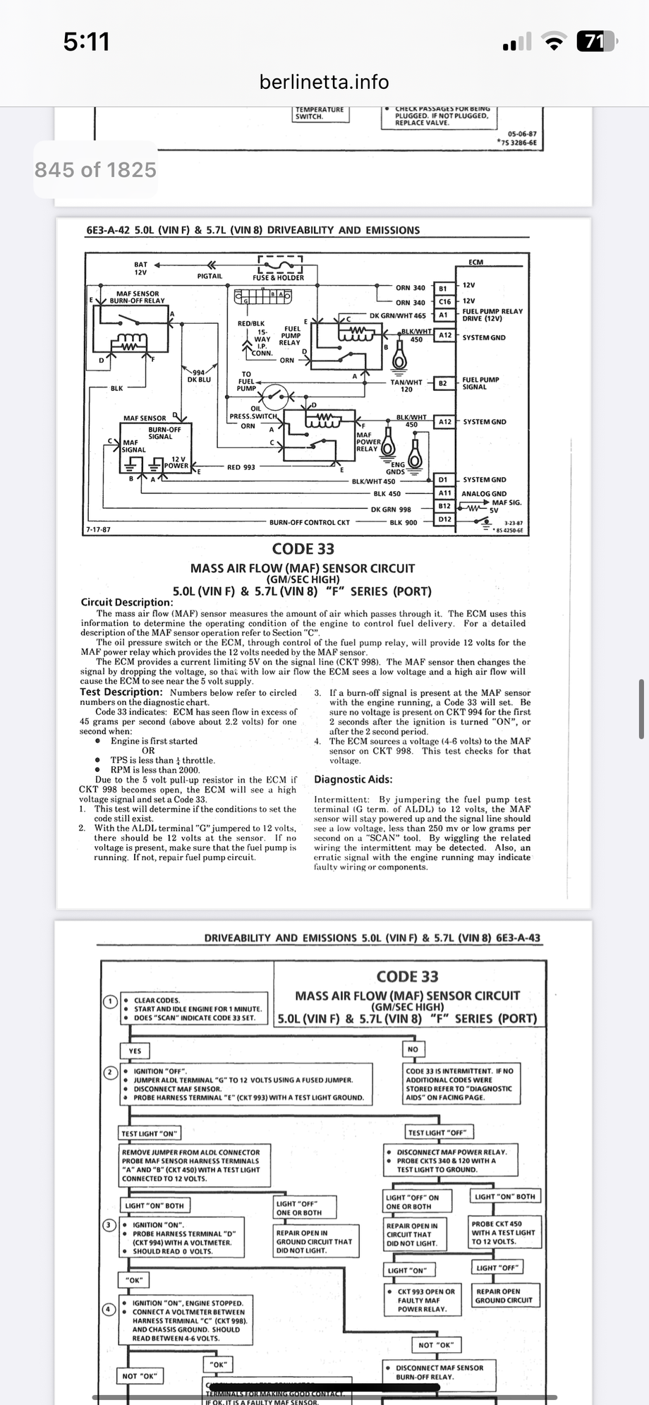

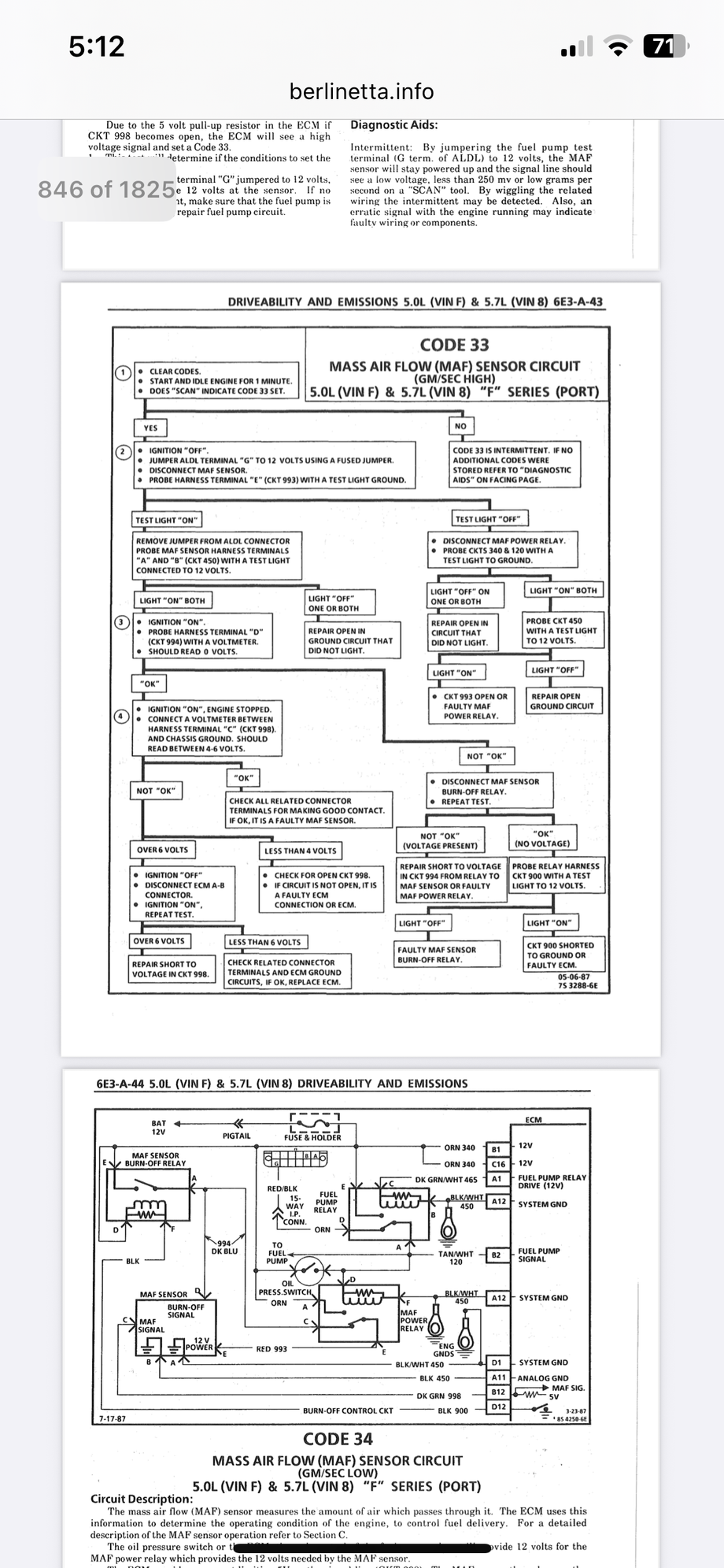

Even though you have a 1988 L98 engine swapped into a truck using a Painless wiring harness I figured having access to a 1988 GM F-body factory service manual couldn't hurt you none. Much better than a Haynes manual or something and way better than whatever AI bullsh*t or Google search misinformation pops up on the Internet.
The video while long and not 100% aimed toward your exact setup contains a lot of information that is. Best of all it explains a lot of the What, Why, & How things work.
He misspeaks a few times but catches himself and corrects it most of the time. The few times he doesn't aren't the end of the World and you get the idea he's trying to make. Like the fuel sock filtering down to 50 microns when he explains it in inches he gets it wrong and it is 2 thousands of an inch. When he is talking about the IAC valve retracting to close off the metered air bypass he meant extending instead of retracting. The fuel pump Pulsator thing is correct for the time but all the new replacement style fuel pumps are of a turbine style design and don't need a Pulsator and it can be replaced by a section of submersible rated high pressure fuel injection fuel hose.
Because you are using an aftermarket wiring harness that doesn't have a Terminal "G" connector in the ALCL/ALDL connector for the fuel pump test circuit you will have to use a fused jumper as Tuned Performance described above to power the relay at Terminal "D" then follow the diagnostic flow chart.
