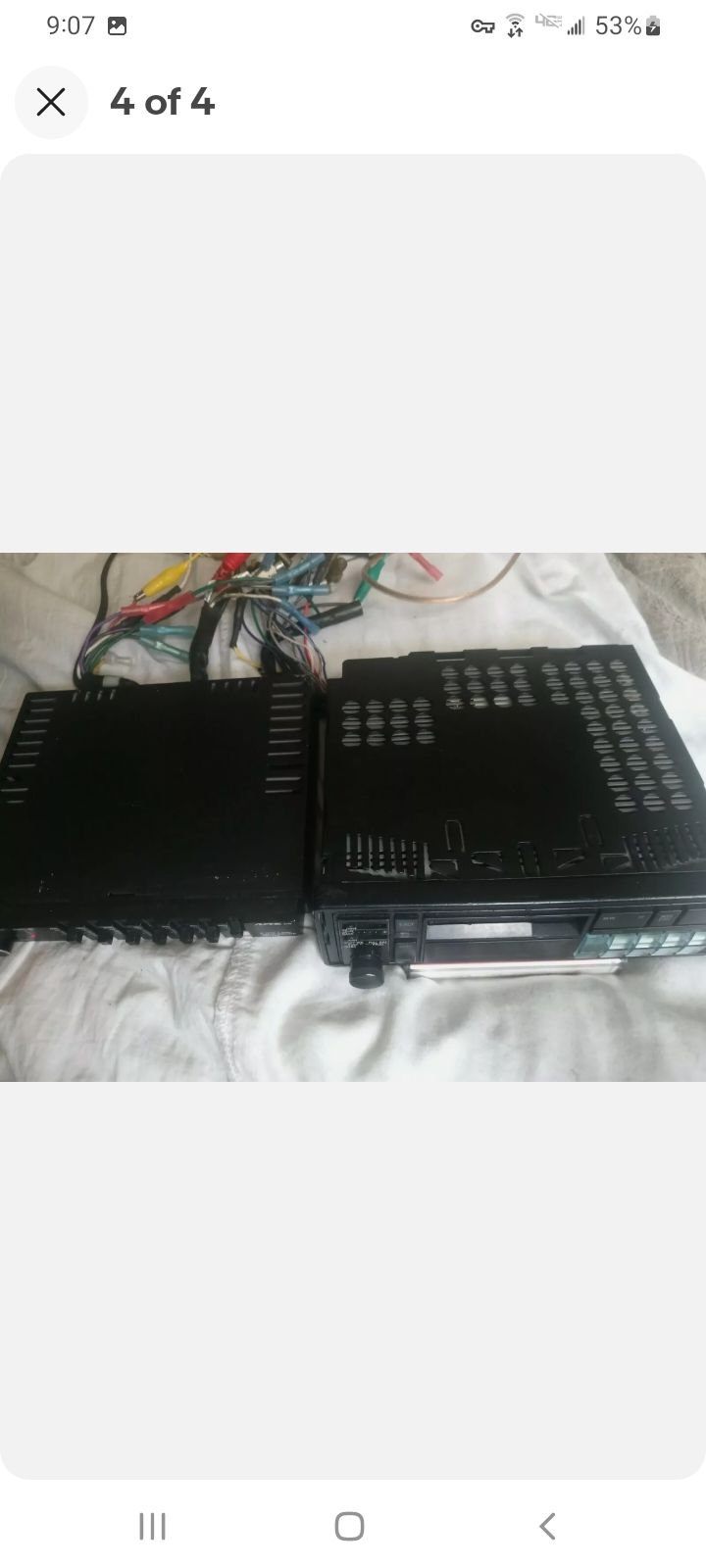

Alpine radio and equalizer mounting bracket
Hello, I just bought this alpine equalizer and tape deck combo on ebay and was wondering if there is a specific mounting bracket that would work well for me to install these. I've read some about people using the metra adapter but I don't see a place where the equalizer would go on them. I have an 86 firebird. Thanks in advance.

Sweet setup, just a tic jealous.
There isn’t enough spare room for a pack of gum in the trans am radio bezel, so you’ll need to make it all fit.
The big Metra kit with a zillion adapters is your go to. Part number 86238XP. Not a direct fit but you’ll be to fabricobble what you need with superglue and shaping a la Soundman.
