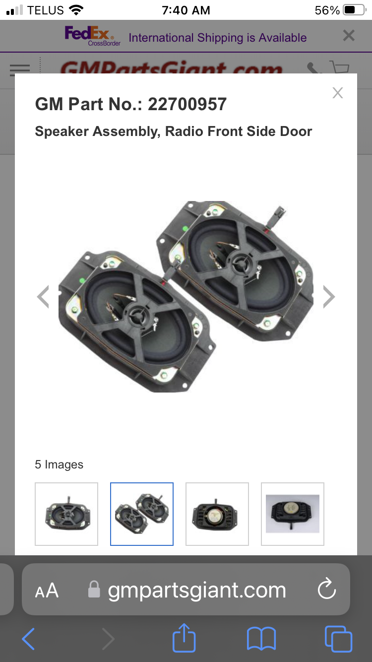

That would depend on the trim level. The “enhanced stereo” got component 4x6 drivers and separate tweeters, where the sedans got typical 4x6 coaxial or even worse, dual cone depending on the year. I may be mixing and matching cavalier from hunting 4x6 options in the scrapyard. The j body cars from this era without the “enhanced” stereo were all “4 ohm”. I believe the component speakers “enhanced stereo” were 4 ohm driver with 10 ohm tweeter. I believe the coaxial speaker has the same impedance, my thinking this is done to “protect” the tweeter. The tweeter of course simply wired in parallel to the driver.
see attached pic of a typical coaxial 95-05.
I am running the above speaker in my T/A in the dash location. They’re surprisingly good - for what they are: when powered by an amplifier that I paid 20 times as much for 30 years ago, receiving a signal from a deck with less than 0.04%THD at full volume. Effectively, they sound pretty good when hooked up to potentially the best sounding equipment money can reasonably buy, lol. A little light on the tweeter.
22700957
