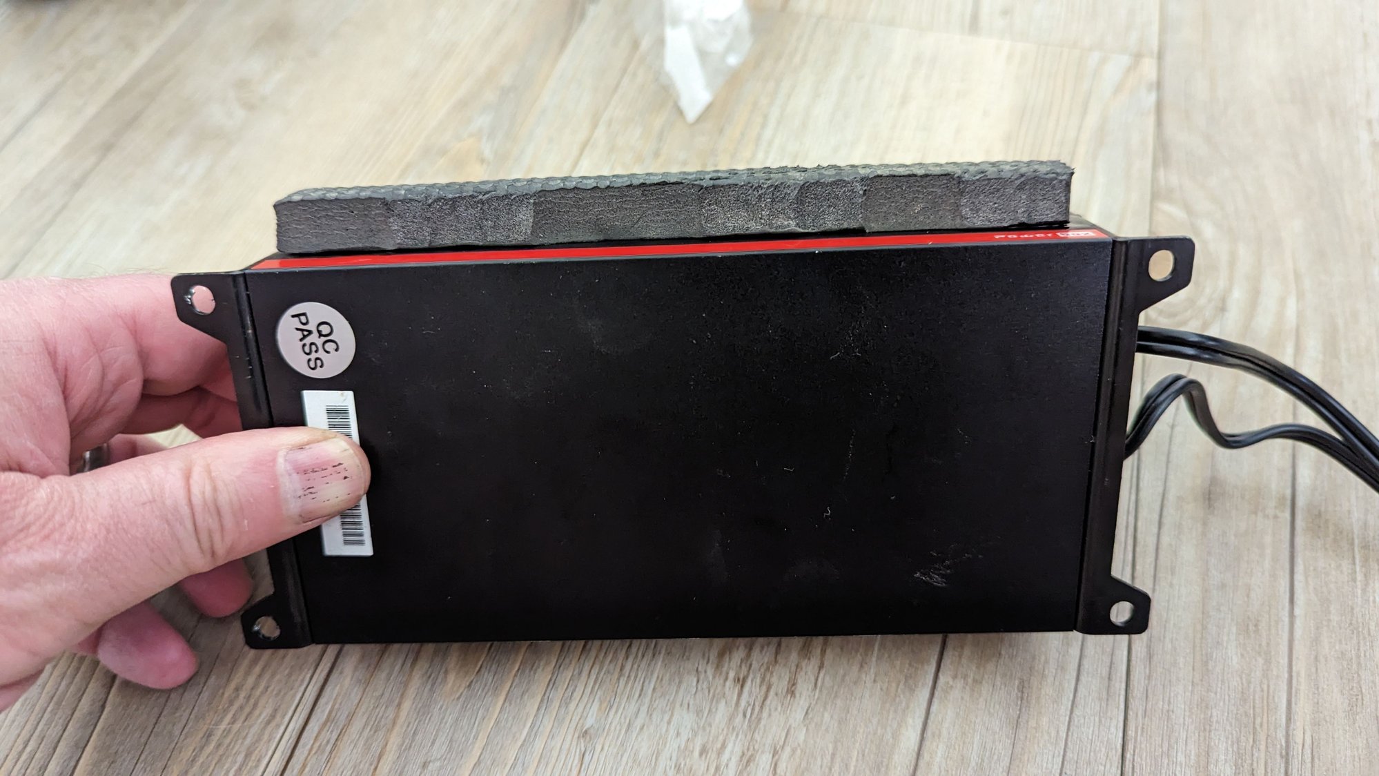

Well, I think I resolved this I bought a in-line mini amp.-, great little thing. I was able to shuffle it up by the cruise control module and it sits between the head unit and the speakers- taking the strain of the OG Delco. Excuse the italics and the spray paint on my nail! This is the amp https://vibeaudio.co.uk/product/powerbox65-4m-v7
It means I can keep my 4 ohm speakers, and protect the AC amp best I can. Sounds good and loud now. Hope this helps people.

Good deal. And that's a real compact amp, kind of surprised with that.
