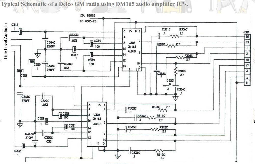

I would love to see a schematic of the amp , that would pretty much tell all . It's my belief that if they (Whoever actually built the radios for GM) used 4 ohm in back and 10 ohm in front , they engineered the amp to drive the differently rated speakers . But then , I could very well be wrong , and if the amp was actually designed to drive four 4 ohm speakers you'd be fine , I just personally find the "had a bunch of old speakers they had to use up" reason to be kinda far fetched .
Unless I was 100% sure , I'd still try for 8 ohm rather than 4 ohm if I could find them .

I would love to see a schematic of the amp .....I'd still try for 8 ohm rather than 4 ohm if I could find them .
well, here is one, but he doesn't say what for:
http://www.howtoalmanac.com/Scott/Ho...oAmpRepair.htm
finding an 8 has turned up zero in my searches so far. they don't seem to exist. which is pretty much at how I arrived at starting this thread. I am finding acdelco 10 ohm, but that is only choice. was hoping for something a little better.

"One DM165 is for the front and rear left speakers, the other DM165 is for the front and rear right speakers. This way each DM165 drives a 10ohm front speaker, which requires very little power, and a 4 ohm rear speaker. I think they also did this to prevent left and right channel cross talk."
Hi Jim , Thank You for posting that link with the schematic . I cut & pasted the above statement from the link and I believe now even more strongly that the output chip would overheat if it were made to drive two 4 Ohm speakers . Since he made specific mention of the use of the 10 ohm speaker "Which requires very little power" , that leads me to think it'll overheat with two 4 Ohm VS the 4 and 10 ohm .

After seeing the schematic you led me to I went crazy looking for the spec sheet on the DM165 audio output chip , and the best I could find is that it's got two outputs (one each for a front and rear speaker) and it's good for 20 watts total power to the speakers . With only 20 watts* to work with I can see where they'd want to direct a bit more power to the back with the lower Ohm speakers , the front speakers being far closer to the driver's ears than the rear speakers are .
* That 20 watts is per side , 20 watts to the left rear and left front from one DM165 , and 20 watts to the right rear and right front from the other DM165 for 40 watts total radio output across the 4 speakers (each radio having two , a left and a right DM165) .

Hoping to get OrangeBird re-engaged on this. There are actually 2 channels per DM165 (Channel A and Chanel B) with 2 DM165s for a total of 4 channels each handling its own speaker. Not 1 channel, handling 2 speakers. So the issues isn't about over-driving an amp by having one-4ohm and one-10ohm speaker on that channel. Its about switching a channel that previously had a 10 ohm speaker on it to 4 ohms. We have no way of knowing, because there is no spec sheet, but, I'd assume each channel is perfectly capable of handing the same amount of power, but is the rest of the circuitry and the heat sink up to the task of having both channels each drive 4 ohm speakers.

Hi Jim , yes there are two channels in each DM165 , and so we have two DM165 chips driving four speakers . Looking at the schematic you just posted the amp's output channels have identical components , so if there is any difference it would be in the chips themselves . I do believe your right in that as long as you don't ask more than 20 watts total from the chip it'll be fine regardless of whether the front speakers are 4 or 10 ohm , the one caveat here being that with the 4 ohm speakers it'll be far easier when cranking the music to draw more than the 20 watt limit , causing overheating of the chips .

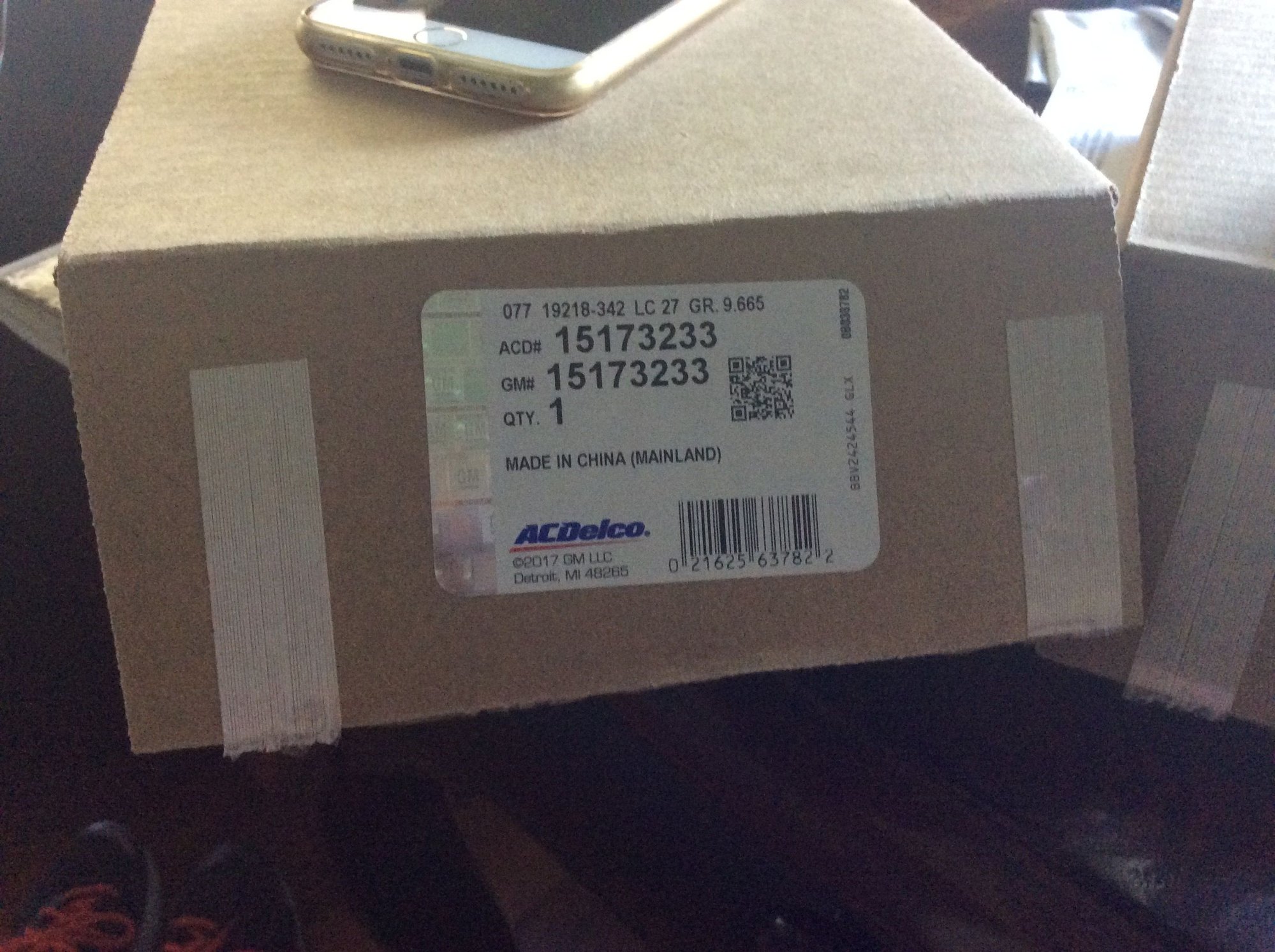

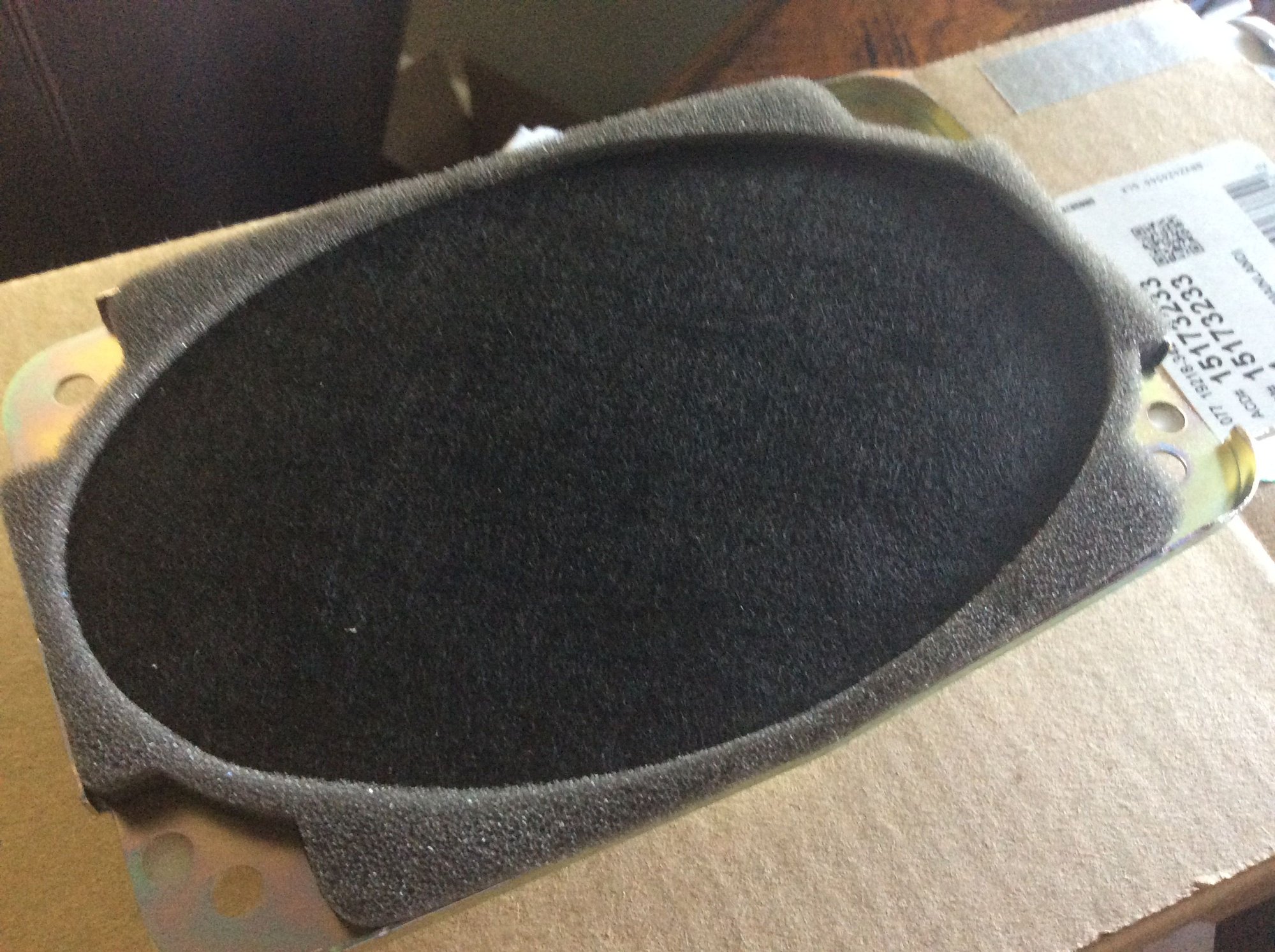

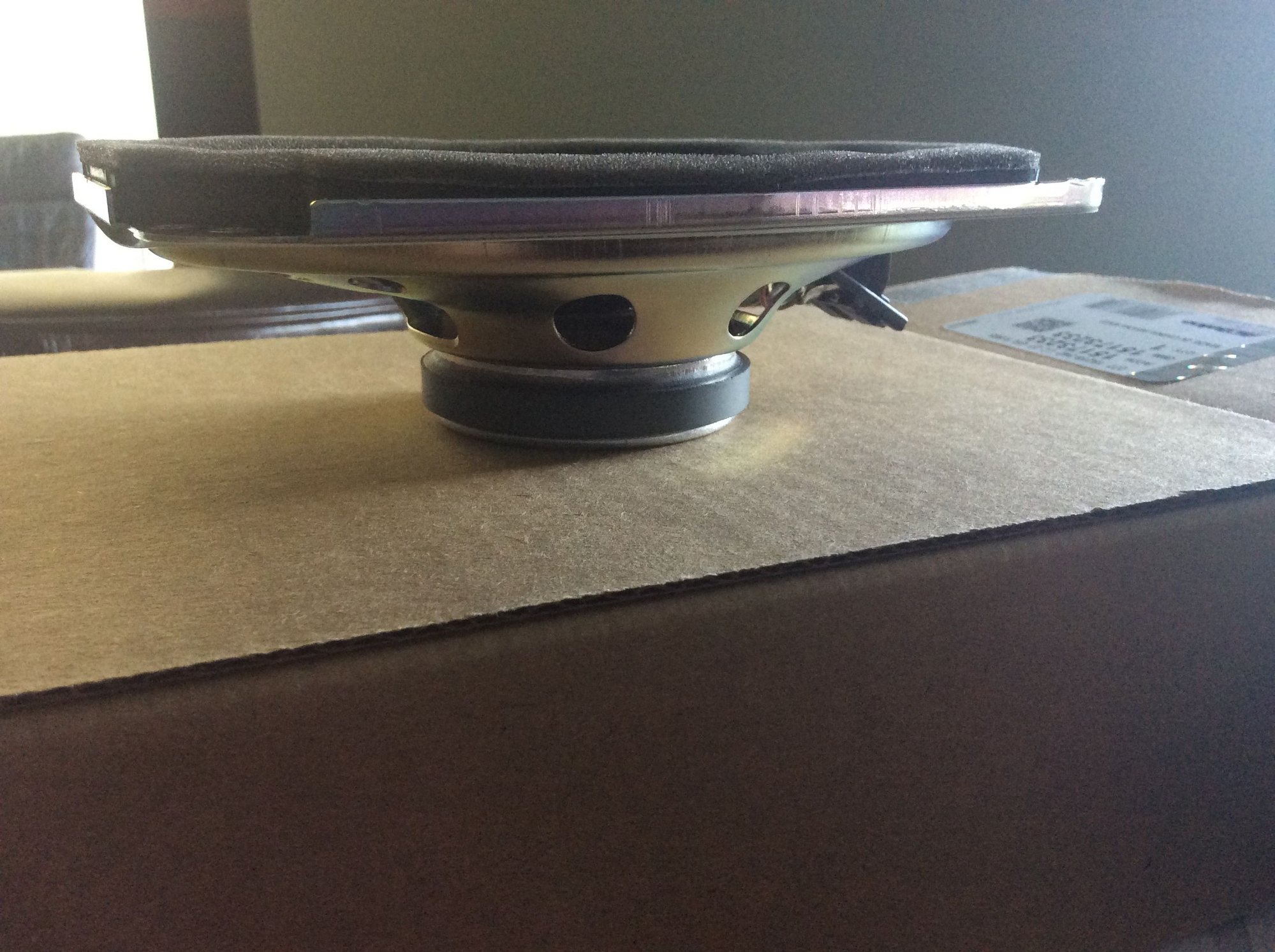

just installed new 6x9 today. they are plenty loud, so i ordered some 10 ohm delco’s up front. i’m getting some weird behavior. right rear is louder thAn driver side. hoping it’s due to front speakers are bad. the same holds true for factory fronts. pass louder than driver.
also, sometimes the volume suddenly gets quiet or loud as i move dials. hoping it’s the fronts. dash unit was bench tested as good
Old Sep 13, 2019 | 02:24 PM
LiquidBlue's Avatar
Joined: Jun 2015
Posts: 2,194
Likes: 246
From: Austin, TX
Car: 90 Formula / T-tops
Transmission: MD8
Re: 10 ohm front speakers - is it important with factory radio?
4x6 s arrived. look like should fit no problem. will report back once installed
