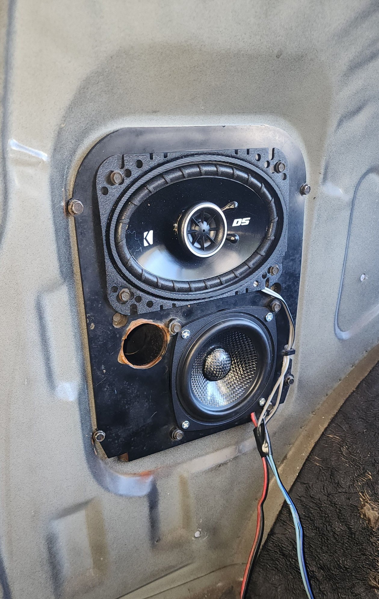

I wanted to share the subwoofers I ended up finding that fit in the boxes. Couldn't find anything to fit the original mounting holes. The holes of these boxes were 4"
I went with the Dayton 4 1/2 Cf120s carbon fiber
-Overall Outside Diameter 4-7/8"
Overall Depth 2-5/16"
Baffle Cutout Diameter 4" Mounting Hole Diameter
Power Handling (RMS) 30 watts
Power Handling (max) 60 watts Continuous Program Power -- Impedance 4 ohms
Sensitivity 89.1 dB 2.83V/1m
Frequency Response 50 - 15 000 Hz Voice Coil
