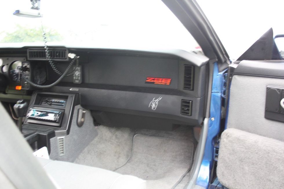

Back in the day, we stuffed all sorts of Single DIN (with *****) in these cars. My favorite was the Realistic (from Radio Shack). My brother was working part-time at the local store. He would set aside the last year models that were about to be discontinued and marked down. Did they fit? Sure! Did they look good? In my youth, the new shiny radio was way better than the factory radio. I remember that most of the installations looked like this:
