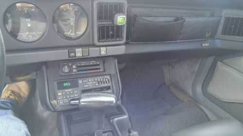

I’m very interested in purchasing an OEM radio for my 1989 GTA. I just purchased the car and it has an aftermarket radio. I’m attaching a picture of the car - unfortunately it’s not great - that shows the original radio. Not sure if you have any for sale - if you don’t, please keep me in mind if you run across anything.

Re: OEM Radio Advice
@89GTA-Alabama
Does your car still have a the Steering Wheel with the Radio Control horn pad ??
Would you be OK with a radio that had faded buttons,... or are you more interested in something that looks "mint" ?

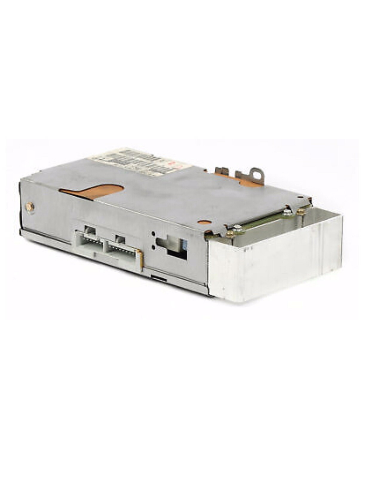

@88IROCvertZ
I was able to get this C4 radio properly wired-up & plugged in and tested the other day,.... Is this the same style radio you've got ??

My car does still have the steering wheel with the radio control horn pad. I would be ok with faded buttons.
OK,..... I do have one and will try to get some pics for you ASAP.
