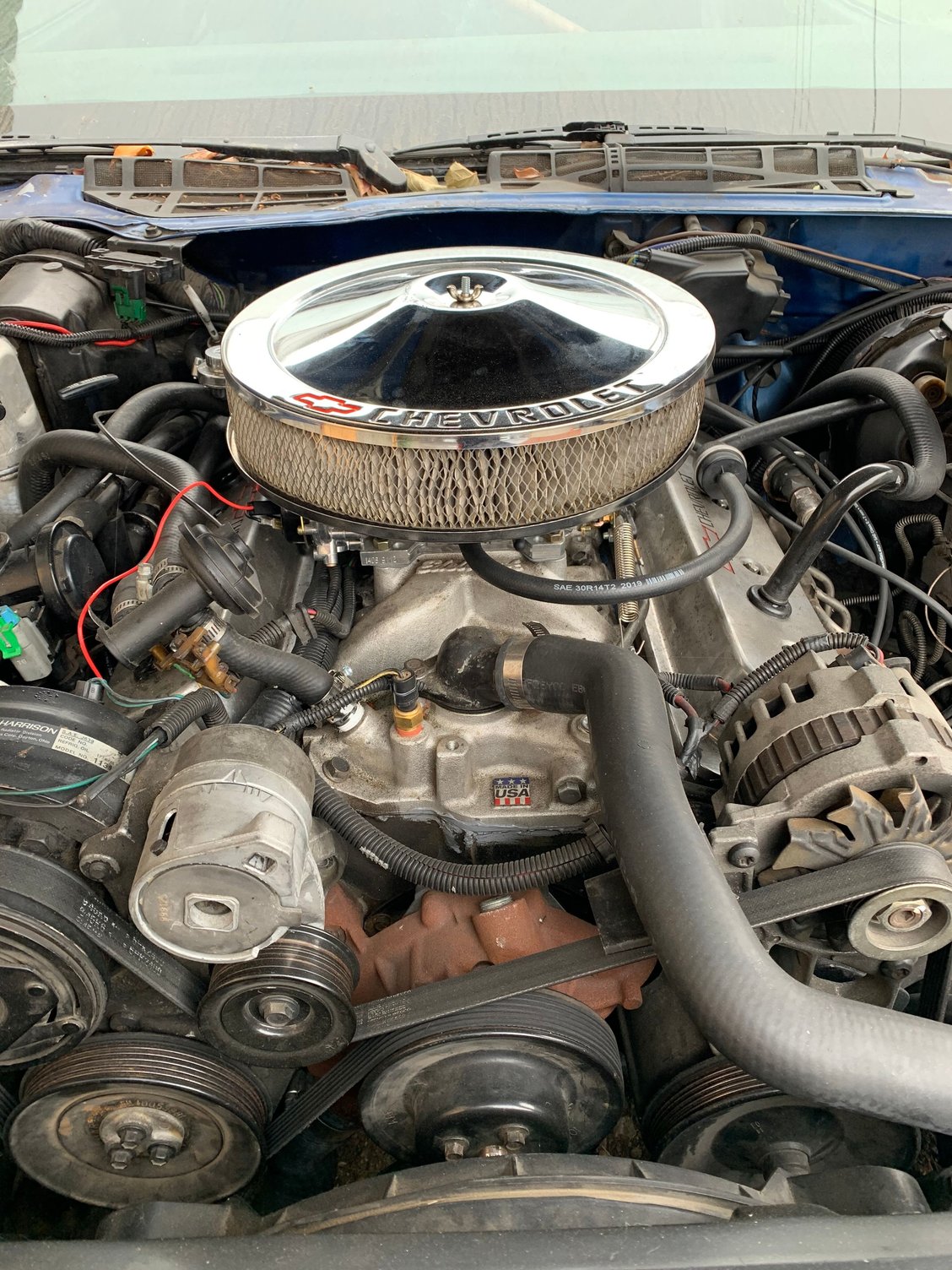

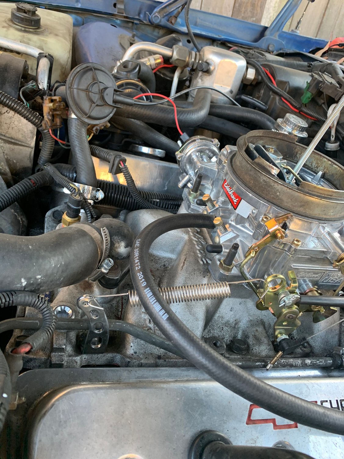

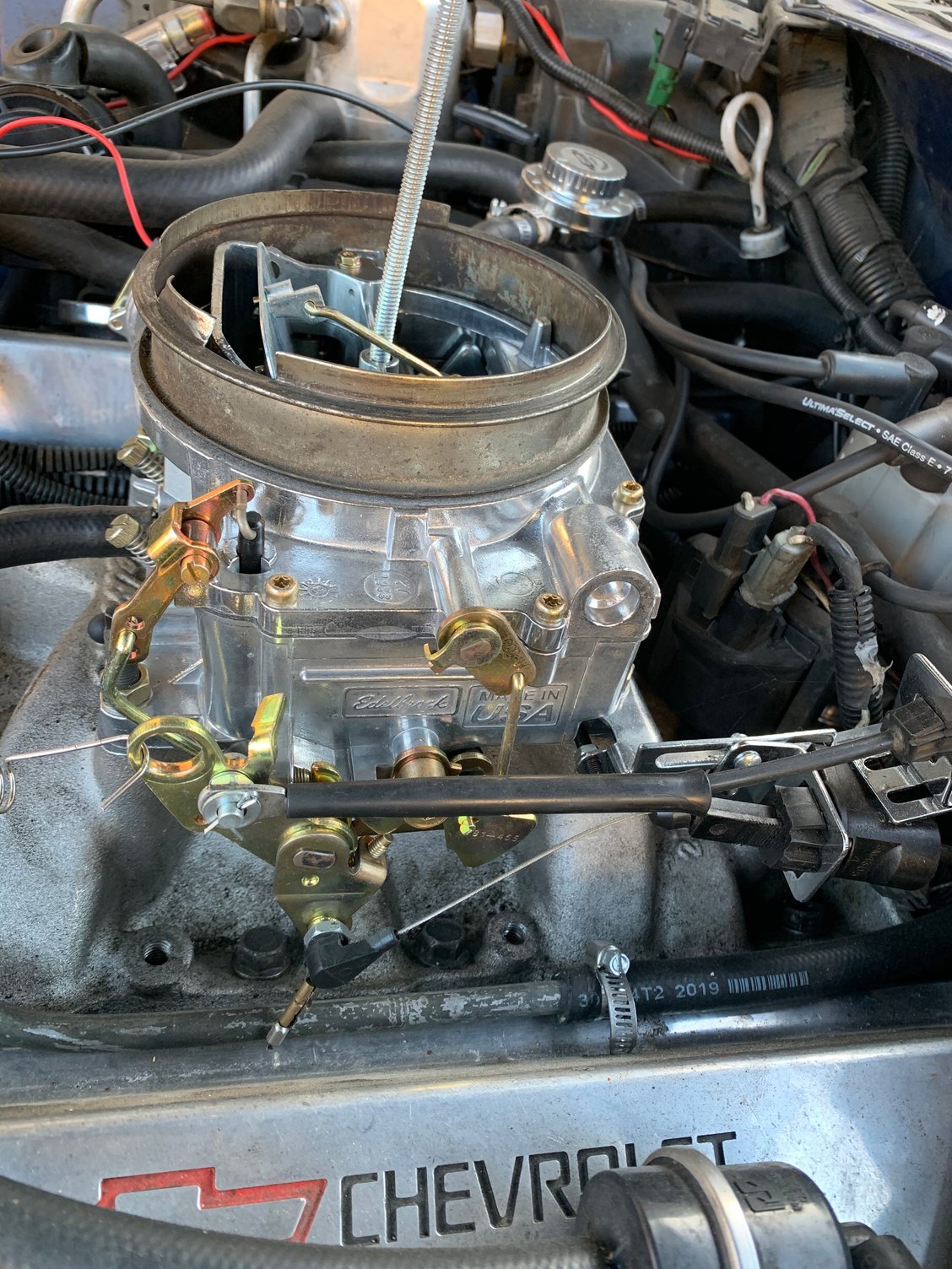

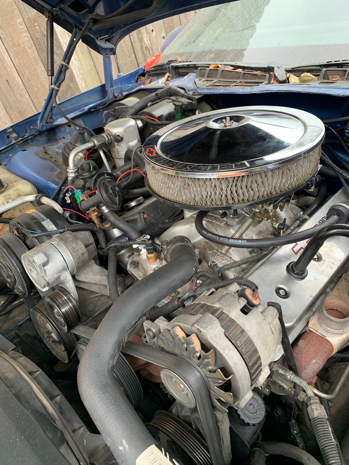

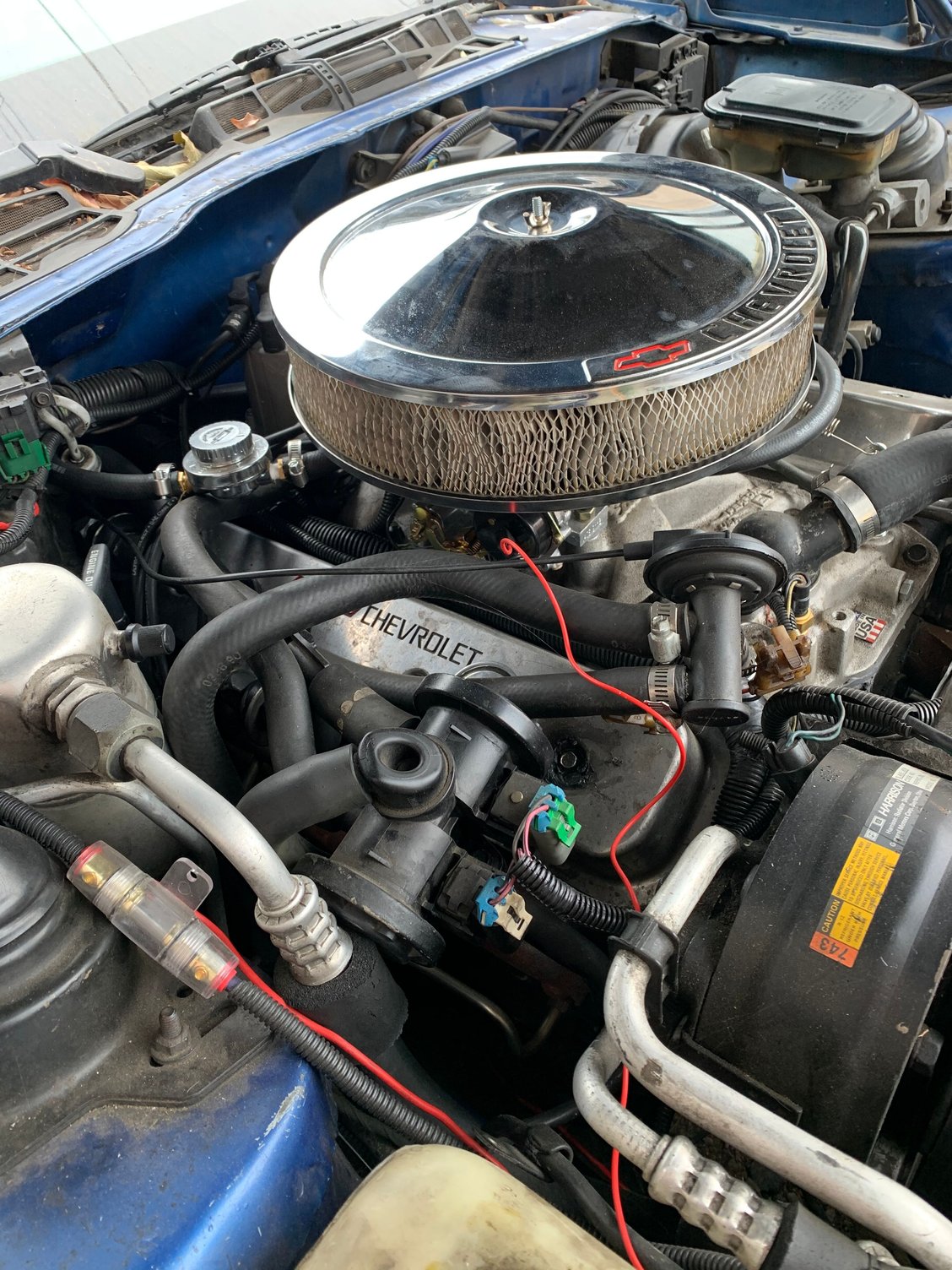

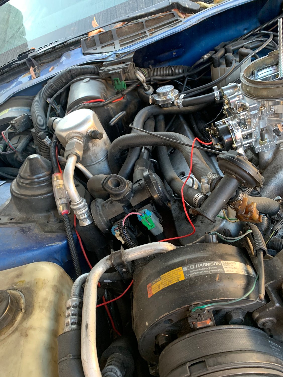

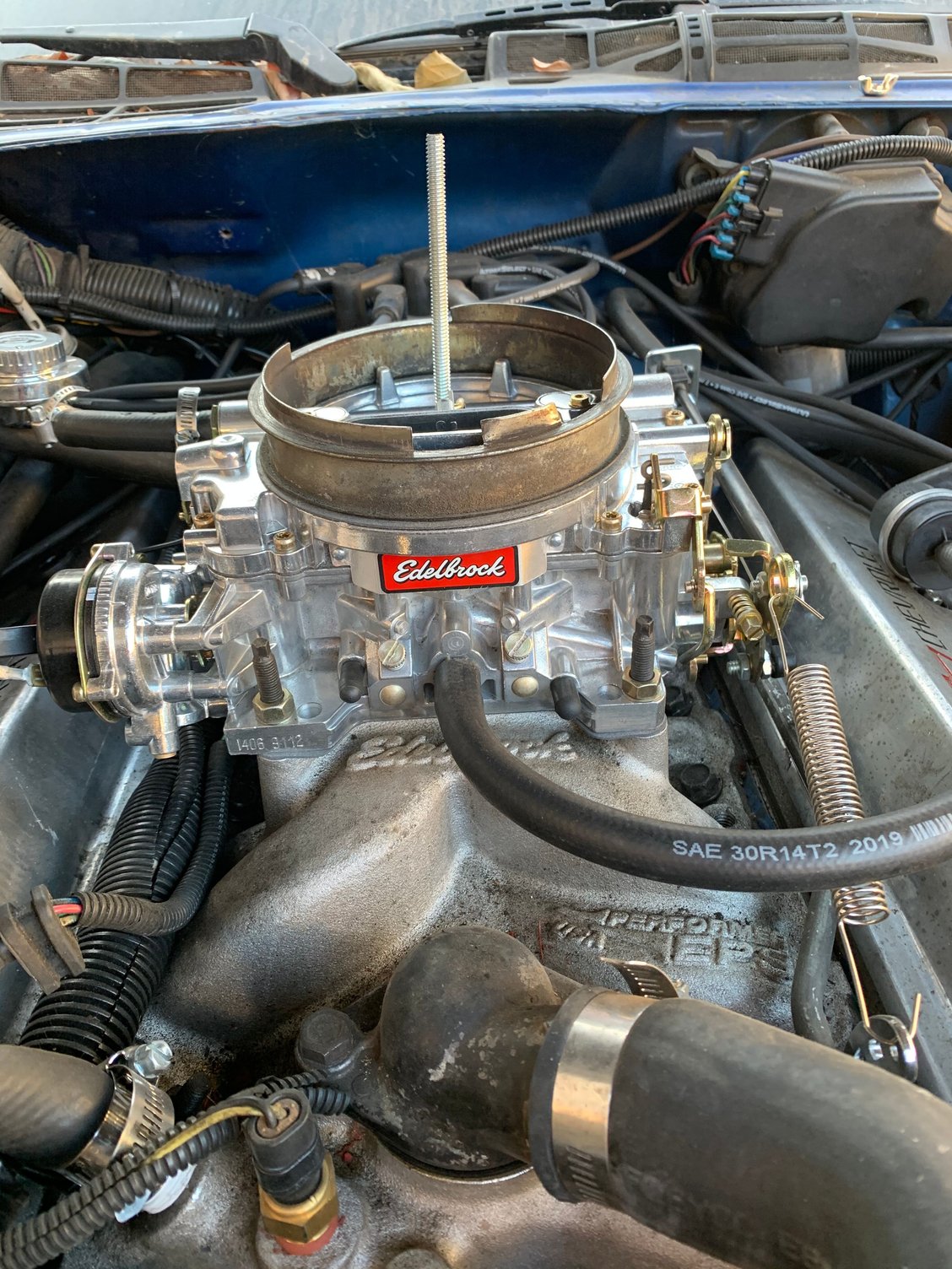

Old Nov 9, 2019 | 05:59 PM
OaklandChevy's Avatar
Joined: Sep 2019
Posts: 6
From: Bay Area
Car: 91 camaro RS
Engine: 350 Carb
Re: 91 Camaro TBI to Carb swap malfunction
Old Nov 9, 2019 | 06:43 PM
Tuned Performance's Avatar
Community Influencer
iTrader: (95)
Posts: 16,808
Likes: 1,008
From: Mile High Country !!!
Car: 1967 Camaro, 91 z28
Engine: Lb9
Transmission: M20
Looks like the stock computer controlled distributor?
Old Nov 9, 2019 | 07:18 PM
Handy_man91's Avatar
Joined: Oct 2019
Posts: 70
Likes: 24
From: Texas
Car: 85 firebird
Looks like your TV geometry is way off. I'm working on an edlebrock swap right now, had to order some special brackets to get it set right. TV cable should be a straight line from bracket to where it attaches at carb, also has to be adjusted properly once it's geometry is correct.

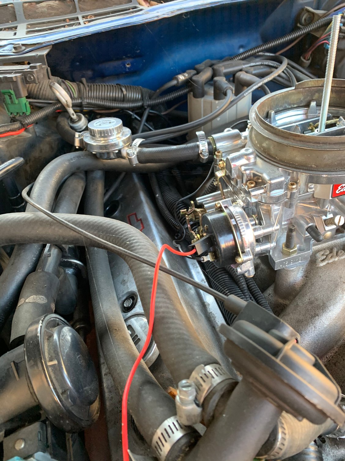

Old Nov 10, 2019 | 01:32 PM
91 camaro racer's Avatar
Joined: Jun 2005
Posts: 1,245
Likes: 8
From: Fairfield, CA
Car: 91camaro rs,2014 silverado 5.3L
Engine: 5.7Lcarb,5.3L
Transmission: 700-r4, 6L80
Axle/Gears: strange 3.73's
what pressure is that mr. gasket fuel regulator set at?
Old Nov 10, 2019 | 03:01 PM
NoEmissions84TA's Avatar
Joined: Feb 2017
Posts: 4,180
Likes: 574
From: Meriden, CT 06451
Please post a pic of YOUR bracket when you get it done and properly adjusted.
Old Nov 10, 2019 | 03:11 PM
Joined: Feb 2017
Posts: 4,180
Likes: 574
Originally Posted by OaklandChevy
This is all I need to see to tell you that you got taken. If you are in an emissions testing state, you have already failed visual and you still have a ton of work to do to straighten out the mess this guy created even if no testing is required. You need a mechanical advance distributor to begin with. You transmission might already be toast. He ruined this car and you actually paid him to do it! Sorry bud.
Old Nov 10, 2019 | 07:03 PM
Joined: Oct 2019
Posts: 70
Likes: 24
From: Texas
Car: 85 firebird
I can do that, I'm probably a week out from being finished. I actually ordered 3 different brackets to try and see which fits best.
As for the OP, you have bigger, or should I say, more issues than the TV geometry. Best of luck getting this thing un-screwed
